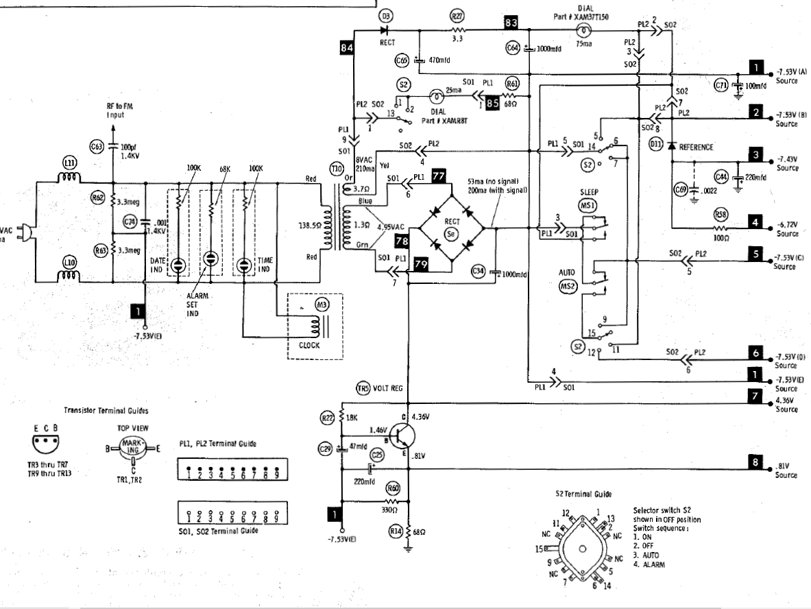

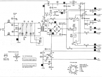

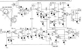

          Here you go, power supply and audio amplifier/alarm circuits..
Name:	RC6551 Power Supply.png
ID:	11102 Click image for larger version
Name:	RC6551 Audio & Alarm ccts.png
