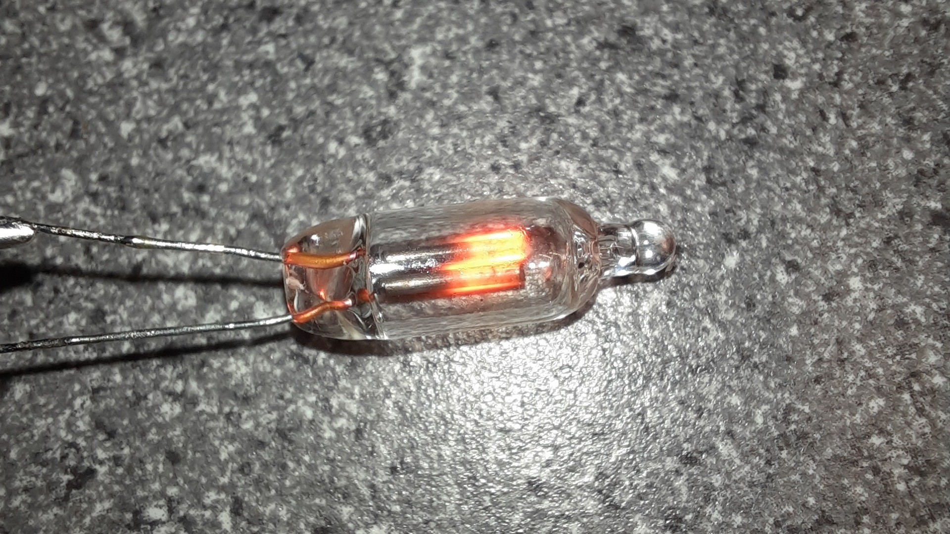

    As mentioned in the article , the neon glow lamps use straight AC current. But it is crucial that you make sure that the proper resistor is placed in line between the bulb and the current. Only one leg of the glow bulb has to have a resistor in place. You'll have to find out what size resistor is needed by reading the specifications regarding the specific bulb that your are considering. Sometimes, online sellers include the resistors with the purchase and you will have to soldier it to the bulb properly. On some eBay listings the bulb already comes with the resistor in place.
    If you're repairing a clock, you often can just simply replace the bulb (soldiering it into place) and using the resistor that is already there. However, I personally always get a new resistor and start fresh. If you use the wrong resistor for the bulb you'll either end up with a dim bulb or a bulb that is running to hot and which could cause problems, but for sure will not last as long as it would with the proper resistor.
    bulb with in-line resistor in place.

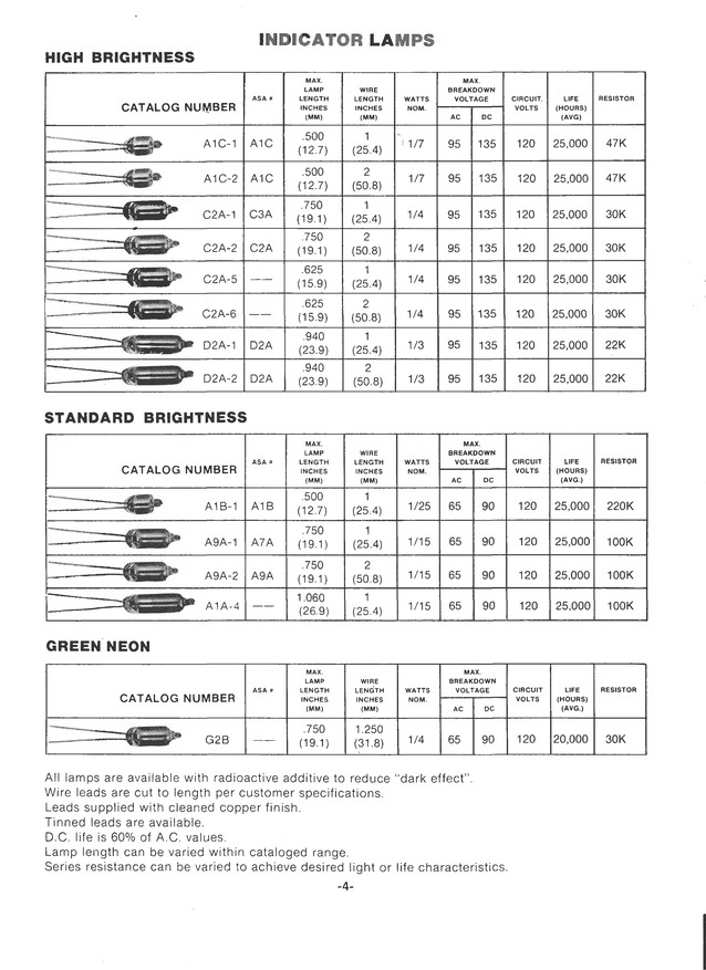

          Click image for larger version  Name:	neonlamp-information-page-6a.jpg Views:	0 Size:	142.7 KB ID:	10890
          This is a page from an old magazine (see full pdf). I had always assumed that the larger A1A would be brighter. Apparently not. I've been using the C2A for a while and have always be satisfied with the result. It's just not the same size as the originals. But the thing is, these days you can't find the original size bulb. I least I can't. Common bulb types include:
          A1A
          A9A
          A3C
          A1B
          C2A (NE-2H)
          But I do have some of the little A1C - they're actually the brightest that I have. I got them as new old stock from Poland of all places. But they're half the size of the C2A. I think all around the C2A is the way to go. It takes a readily available 30K ohm resister and the company I've used includes the resistor with the bulbs.
          https://www.memotronics.com/new-box-...ree-resistors/
            Some very useful info there Mackey, I've downloaded that pdf & will keep it for future reference.
            I particularly liked the "Physical Characteristics" panel on page 3
            If we notice our neons have suddenly darkened overnight we know that it's probably due to gamma radiation.
            Or if the neons are lit without having mains power it's due to a local high intensity electrostatic or RF field.
            So our neons make very handy SHTF and UFO detectors
