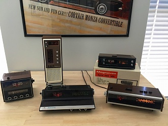

    Magnavox Flip Clock Radios
    Click image for larger version  Name:	IMG_3998 (3).jpg Views:	1 Size:	719.4 KB ID:	4219
    My five Magnavox flip clock radios.
    Clockwise from left:
    1R1782 - Japan 1972. Uses Copal GC-1246 mechanism. Plastic woodgrain.
    1R1784 - Korea 1972. Uses Copal GC-1670 mechanism. Genuine wood.
    1R1773 - Taiwan. New in box. Plastic woodgrain. Have not opened case to see year of manufacture or mechanism number. This clock with minor differences was sold under many different brand names.
    RE3193 - Taiwan 1973. Uses Copal GC-1239 mechanism. Plastic woodgrain. This clock with minor differences was sold under many different brand names.
    1R1736 - Japan (c)1972. Uses Rhythm mechanism. Glossy plastic.

    Nice collection and display!

      Great looking collection!!! Amazing how bright the neon lamps are in daylight...did you replace all of them?

        I replaced the neon in all of them except the 1R1773. I used Mackey's replacement neon assemblies, they are the best!
        I also had to replace the tiny incandescent dial lamps in the 1R1732 and 1R1784.
        The 1R1736 is my most recent, and favorite. I have been looking for one for a while and it popped up on eBay a couple weeks ago. I really lucked out. The radio pulls in stations really well and sounds great. The clock is by Rhythm, not Copal, and works well.
