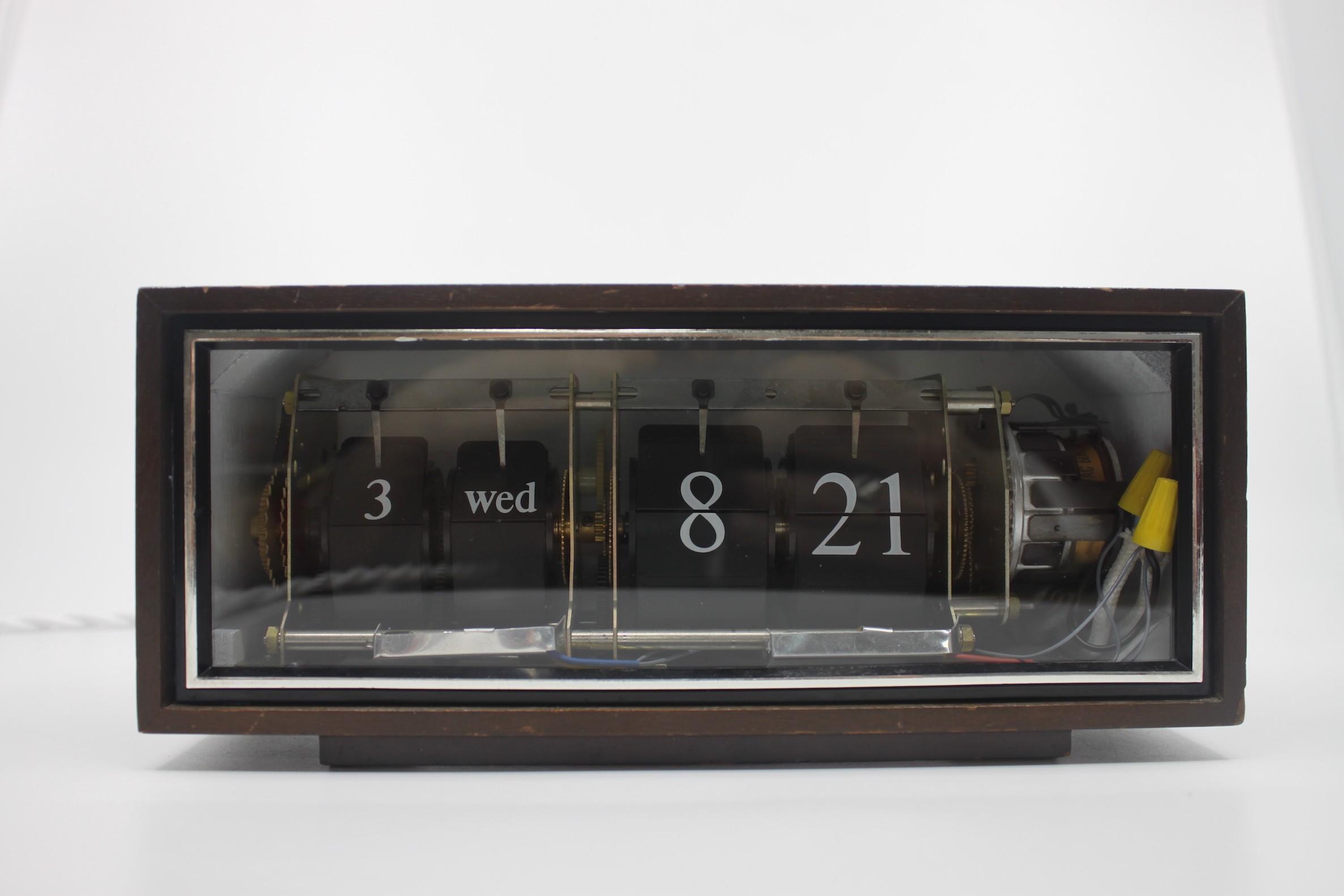

    Ever since I had gotten my hands on two of these, I had some ideas on how to alter them slightly from how they were intended and (in my opinion), make them look cooler.

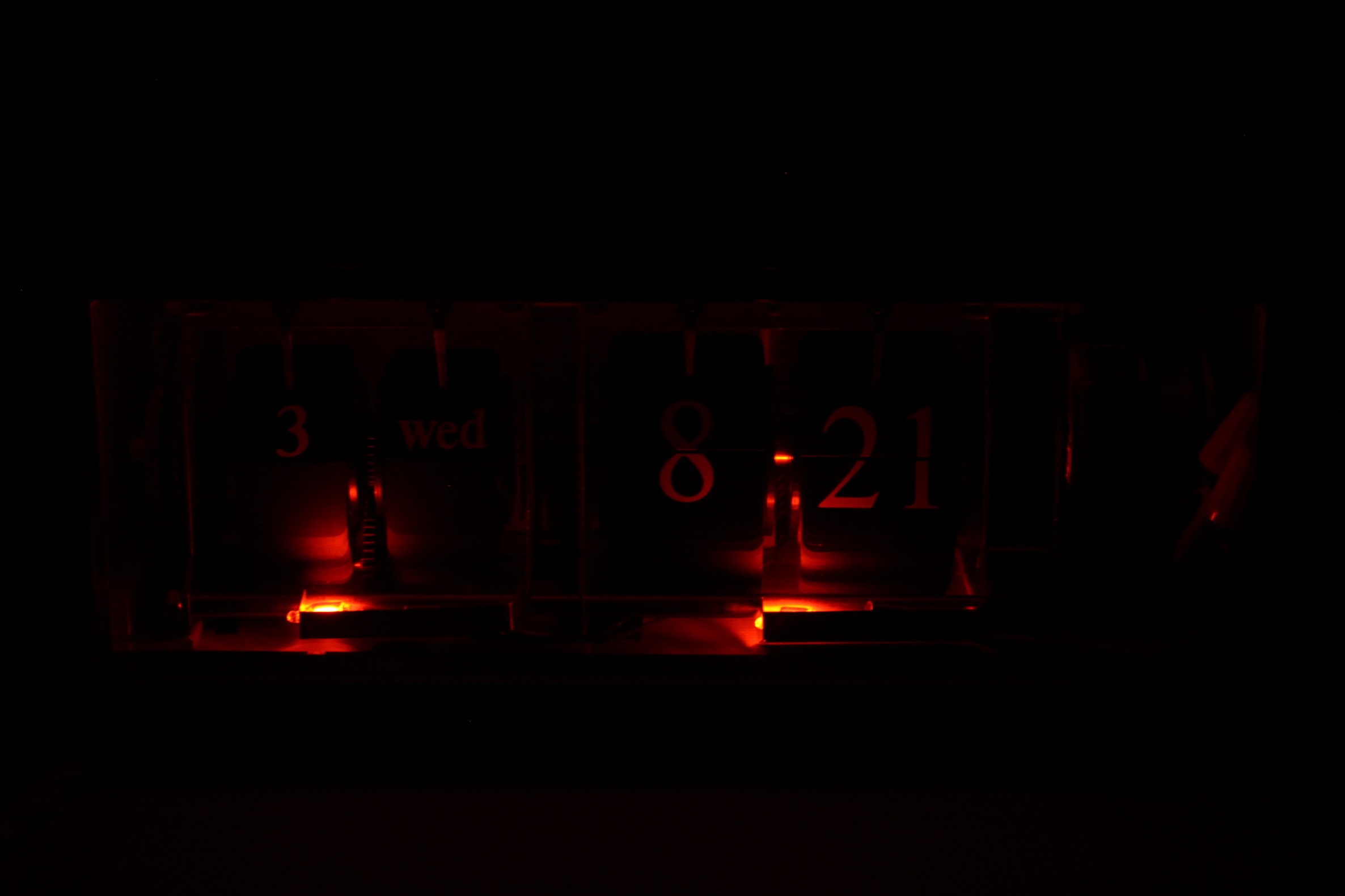

    I removed the black face plate inside, which lead me to having to 'glue' in the face plate for that was held in place by that specific face plate, but that was very doable. I removed the clockwork to paint the inside white to show the mechanics inside even better. Whilst having it out, I redid the wiring, opened up the motor to lubricated it and also added a 2nd light for the day/date.
    I put it back together with a new cable and plug, I am quite pleased with the result and she's now running perfectly again and also very quiet.
    For the 2nd one I aim for something similar, perhaps give the outside a different colour although I do like the somewhat used and battered look it has now.
    That looks really nice. I like what you did. It looks a bit industrial and I love that look.
    I do the extra lamp mod to the Caslon 601 models, too. They just NEED that second lamp!
      flipoclock commented
      I agree, in this case I was lucky and could install the lamp holder without having to modify it, in the Copal clocks it is more difficult, but perhaps I will find a solution for that some point.
    • 3605
    Yes. Much better look. Reminds me of the Howard Miller flip clock.
      Looks great. Nice work. I like the full view of all the clock works
