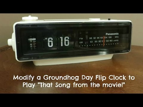

    After multiple requests I finally did a how to video on how to modify a Panasonic RC-6025 Groundhog day flip clock to play "I Got You Babe."
    For about $10-15 dollars!
    Unlike the instructables version (2/2/2015), the clock retains all it's normal functions, except for one. It will play the radio, alarm to radio but the alarm to buzzer has been replaced with "I Got You Babe."
    The post following this one will have Tips for this modification (to be added to as needed).
    Sound module featured in the movie above

    Additional Tips Regarding this modification:
    1. Make an off button - When putting the sound clip on the board, you should add one more sound. I just add a "click" or "beep" sound. Just a very short sound to let you know that you've activated the button. The button for this sound can be fed to the outside of the clock. This button will allow you to turn of the "I Got You Babe" clip. Otherwise, you have to listen through to the end every time you activate the module. This button effectively serves as an off button for the sound clip.
    2. Make an extra Song Play Button - If you're going to add a "off" button, why not add another button to play the clip without activating the alarm. This is good for "show and tell" for your clock. You can hide the buttons on the back of the clock and reach your fingers to the back and press the button to start the song. You can either load the sound file twice on the board (there is memory enough) or splice in a button. The second option is difficult as the wires supplied for the module are just hook up wire .... very thin and not much to work with.

      Mackey, Can I output sound to the speaker clock (stock speaker)?
      and second: Can I give power to the soundboard from the clock?(not use battery on board)
        Yes, you output to the stock speaker.
        But the board needs a steady 4.5 V DC. I don't believe there's a extra supply of steady current available on that board. One thing I did in the past was to take a AC/DC converter that outputs 4.5 V (you know, plugs into the wall) ... like this one ... I ended up with a stack of those, thought I'd do more of those conversions. Anyway, I opened that up (sawed it open with a dremel) and secured it into the clock (there's room in there for it). I took the 120V as it came in to the clock and then powered the board off that. It worked great. It was a well made one and didn't overheat . I just felt that I didn't want to recommend that to everyone, as it could be dangerous.
        The thing is, I understanding why you may not want batteries. But they're safer. Also, .... honestly ... you won't be showing it off that much. Unless you really did want to wake to that song!
