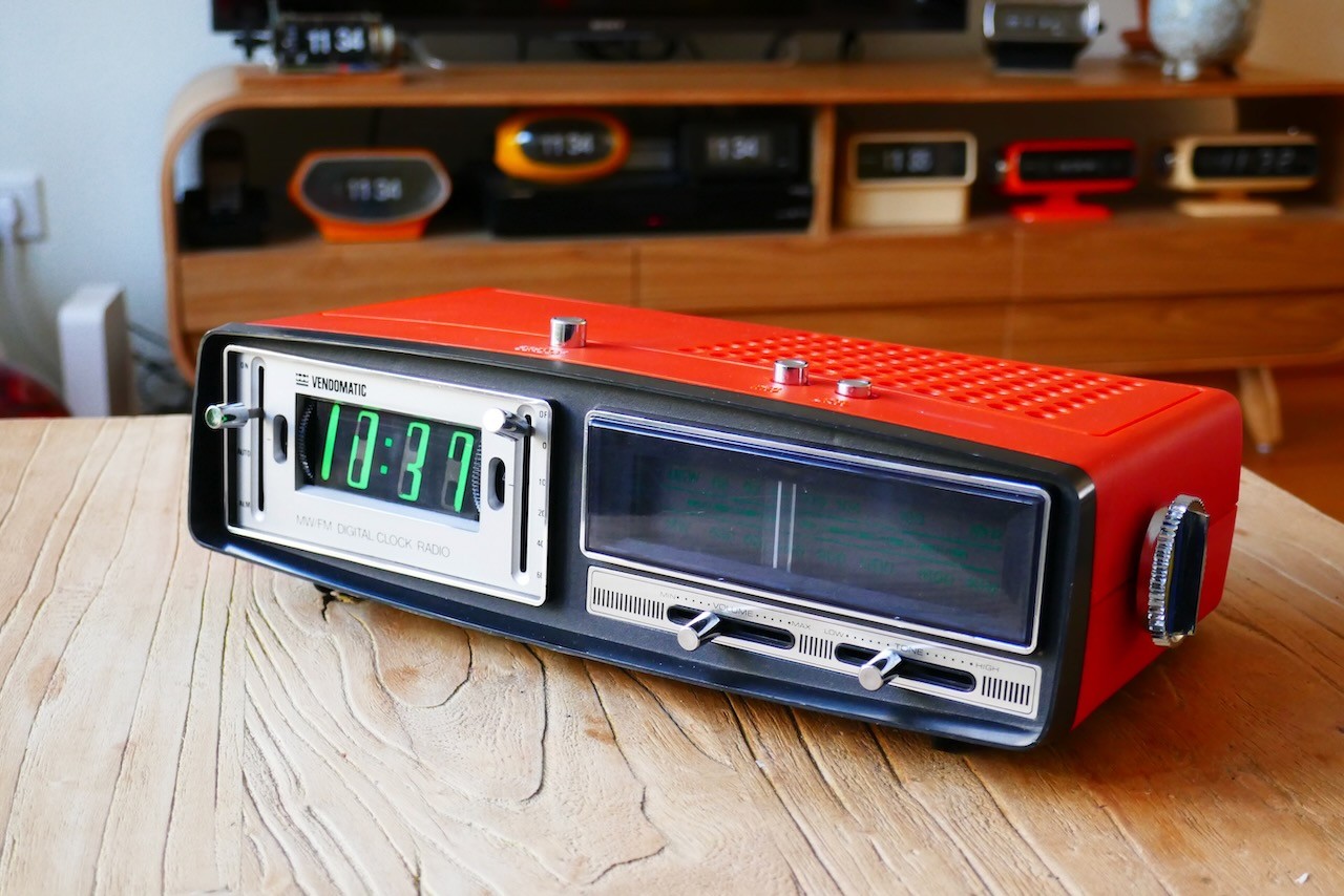

    A film roll clock was high on my wish list already for a while, because I find it an interestingly different mechanism. I had already bought two broken Philips 90RS455 radio alarm clocks, hoping that I could merge them into one working clock. But after a first investigation they sank to the bottom of my ‘still-to-repair-stack’ and never resurfaced because I was afraid it will be a painfully difficult repair.
    Then I found this Vendomatic PQ-55 that was in a much better shape. Apart from the motor not running, everything seemed to be working fine (spoiler: it didn’t).

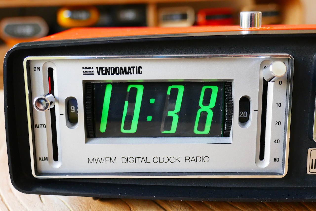

    This radio alarm clock has an AM/FM radio with tone control and a headphone jack, but I especially like large bright green numbers in a funky 70’s font on the clock! I love to watch the numbers “morph” (or melt as I read elsewhere) when the time changes.

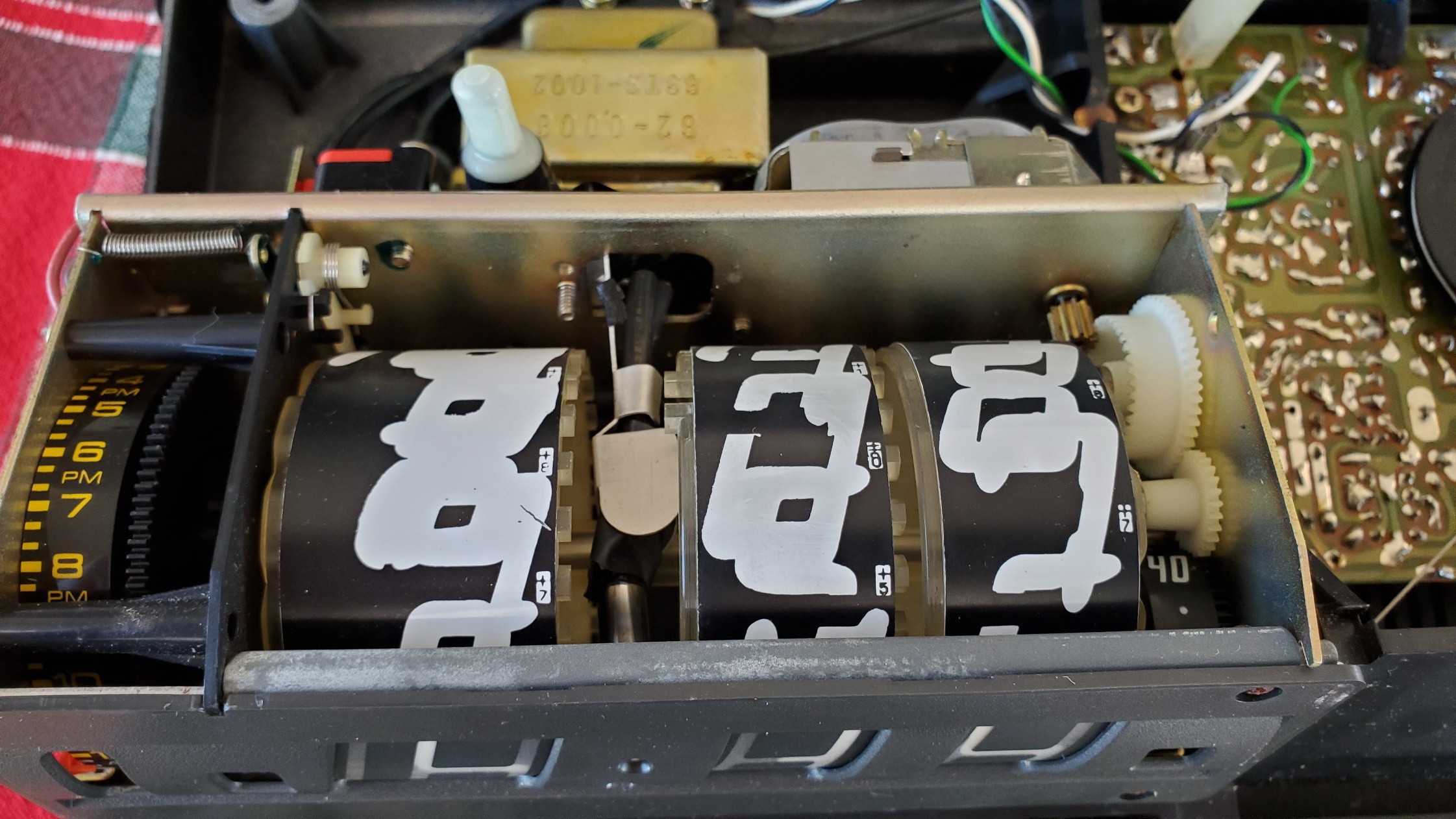

    The clock mechanism is from Westclox and in this version they applied the same trick as some Sankyo roll clocks: the large slanted numbers are overlapping on the film and a mask at the front filters out the relevant bits. And just as with the Sankyo clocks you can recognise this trick by the small gaps in some numbers that are an inevitable side-effect of this method.

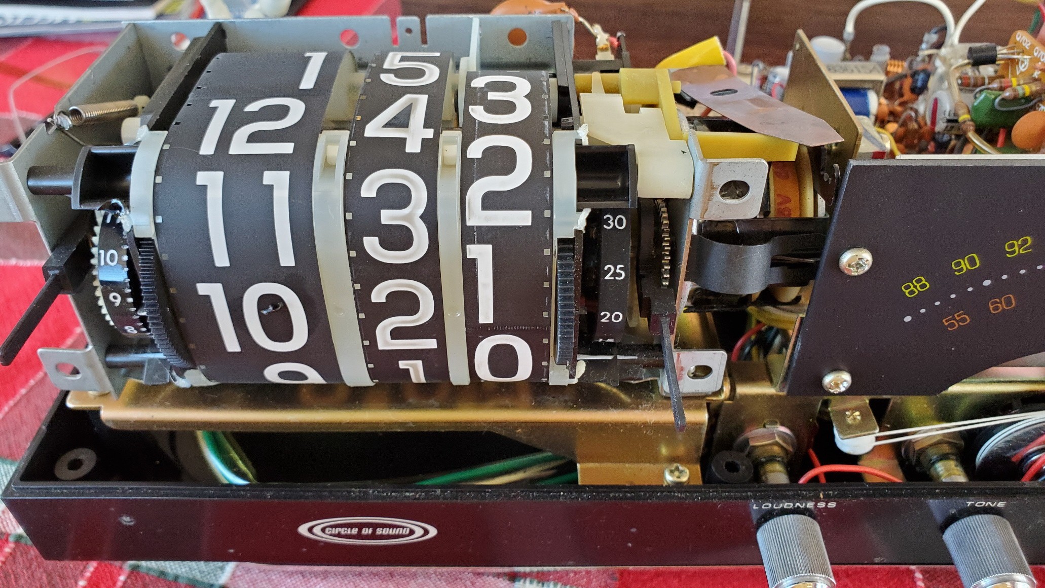

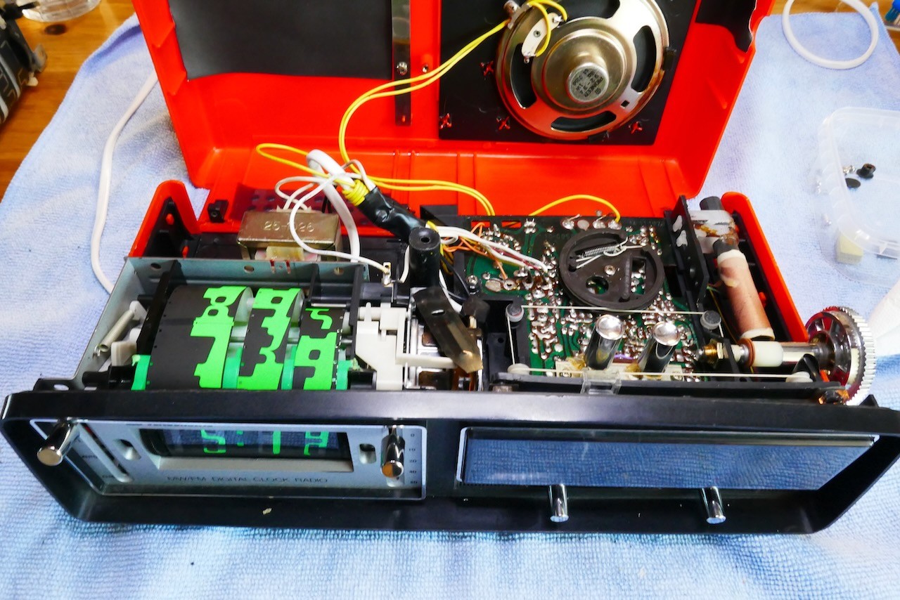

    The motor was easy to fix. It just needed a good clean and lubrication to get running again. I noted it is running pretty hot (around 50 degrees Celsius), but another motor I had reached similar temperature so I assume that this is normal.

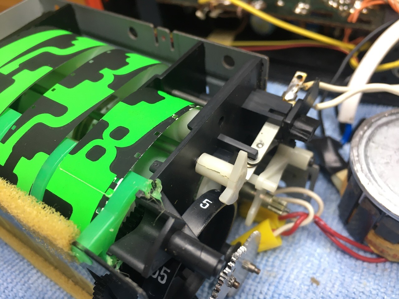

    Now I got that working I could properly test all functions of the clock and everything was wrong! The radio went on when it should be off and vice versa. The buzzer was always on, except when you set the sleep timer. After some investigation I found the culprit: a lever had cracked and was no longer attached to the axle. As glue alone was not strong enough I fitted a sleeve around it that I made from an old ballpoint filling. Then it took me some time to reverse engineer the correct position on the shaft. And since I had taken so many things apart, I also needed to sync up the alarm again.

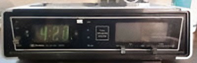

        Best looking one of that style I've seen. The green digits remind me of a Riviera DCF-18.
        Which was described as "Full Feature Electronic Tape Digital Movement by General Time."

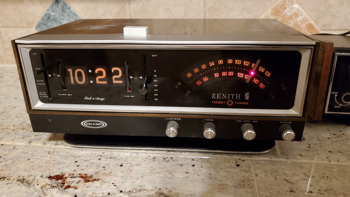

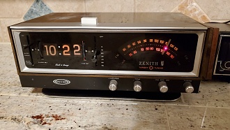

            That appears to the be the same General Time Corp. tape clock mechanism as used in the Zenith clock radios (but with a different and much cooler font). The cracked part that kept the buzzer on seems to be the same as the crack I found in mine, too. I had a tough time figuring that out. I rotated it to the OFF position and hope no one touches the lever since I didn't fix it.

              Also, it's interesting to see the masked overlapping numbers used in a different way (on film) than on Zenith cyclometers.

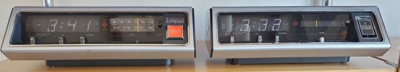

                Johan de Jong commented
                Ah nice, that is I think the Sankyo mechanism! I have a Sankyo 202 and a 535L that use this mechanism and also seen it in this Atomic DGU 400: https://www.flipclockfans.com/forum/...atomic-dgu-400
              • tickrim
                tickrim commented
                You have GREAT looking clock radios!
                Yes, it is the Sankyo mechanism. I had to replace a broken gear in the Intermatic motor on one of them (from an Intermatic lamp timer). The other is still working fine, but makes some clicking noises.
                The Sankyo mechanism on the left has a green (neon?) bulb that appears to be original. The one on the right had a replacement orange neon bulb that was about dead when I got it - I installed a new one. Now I wonder if it, too, was originally green. However, I see that your Atomic clock has an orange neon bulb.
                Also, I'm wondering if anyone knows how (or if) the lamp was secured in the big red Weather Radio pushbutton on the left unit. When I took it apart to clean it up, the lamp (on the wire) just fell out of the button. I stuck it back in the pushbutton when I put it back together, but there's nothing that secures it there other than the shaft of the switch. I later noticed a little old O-ring on the table after I put it all back together and wonder if that O-ring had somehow held the lamp in place in the pushbutton.
              If you wish to fix it, here are some pictures that may help. In the first you see how I fixed the part by fitting a little tube around it that I made from an old ballpoint pen. In the second you see the correct position of the part. Note the lever is in the "on" position and the switch for the radio is closed.
