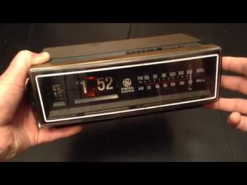

        Do you have any experience with GE clocks or do you mainly work with Panasonic?
          • 3713
          Originally posted by arkitip
          Thanks for the link, I appreciate it.
          Some. But you also need to remember that there are other visitors and members of this forum who might have experience also. So if you have a particular question, I'd just post it to allow others the opportunity to respond.
