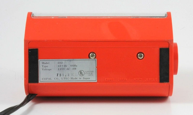

    Look on the bottom
    Click image for larger version  Name:	Copal_222_bottom.jpg Views:	1 Size:	45.5 KB ID:	4555
    I'm thinking that if you press down on the part of the cabinet at the bottom of the silver label and where it reads "COPAL JAPAN NO (0) JEWELS, you will release the tabs that would allow you to pull the back off. It may be similar to how I opened up the Copal 101 in the following video (at about 2:30)

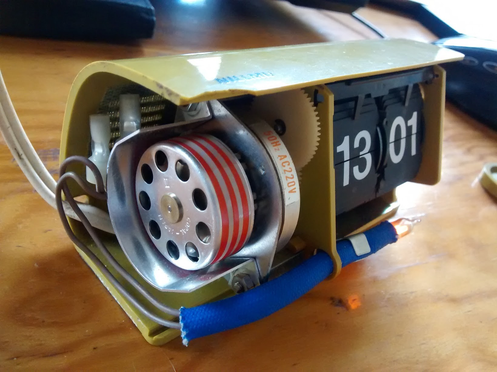

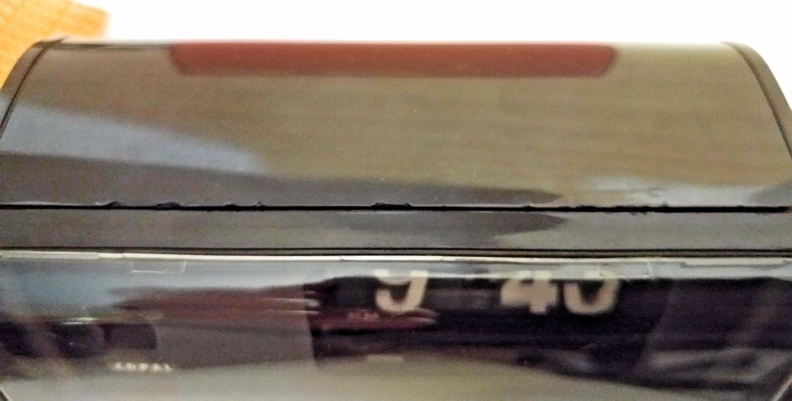

      I found a thread in this forum at https://www.flipclockfans.com/forum/...ing-fast/page2 were in the last pic there is a picture of the same model clock open.
      The plastic on this one is so brittle that I don't think it will ever open without breaking up. :-( like you said I am going to take my time
        • 3616
        I'm glad you found that. I'm posting the image again below. I think I may have been right. I can see a ridge on the bottom of the cover. That's where the tab or tabs would hold the clock. I'm pretty sure if you applied pressure on the base, this would release the back. However, see the crack at the top? I think people are messing up by trying to open the back like it was on a hinge. I think you should focus more on pulling the front part of the clock forward instead of trying to remove the back.

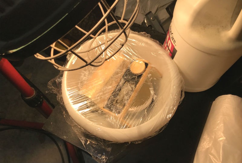

            Well, I've got Dancing Dragon 's clock in my hands this evening. I was partially right on how to open it. It's a real tough nut to crack. You have to get the knob off before you can do anything. I'll be making a video of the process some time soon. But Dragon, it might not be your clock in the video.... I got one of my own after talking with you. Yours (as I mentioned in PM to you) is now in the "de-yellowing" process.
