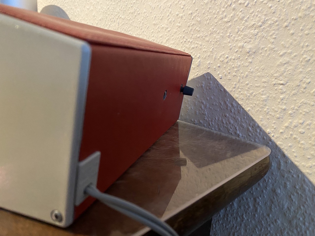

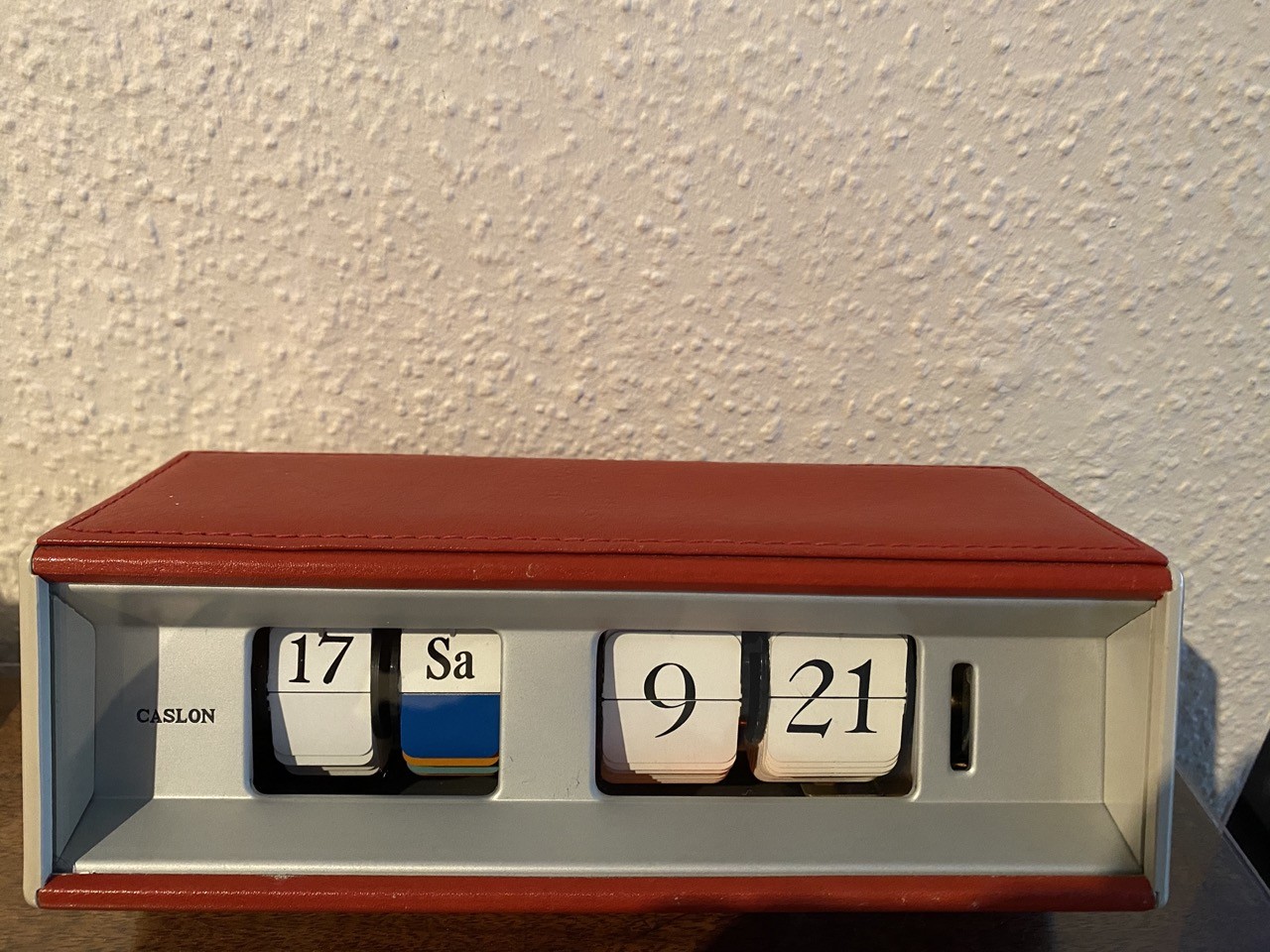

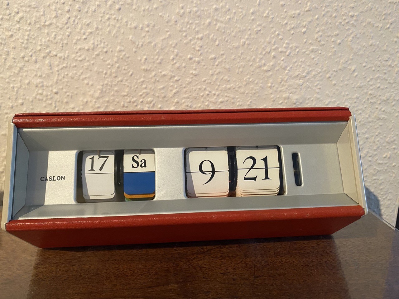

    I found a Caslon 601 for 26€. The clock is in quite good condition and working perfectly. However there are 2 problems. The first one is the missing time adjustment knob and the second is the broken operation indicator (that I removed).
    I know it will be difficult to find this 2 parts so I was wondering if someone knows how I could replace the knob to be able to adjust time and date.
    Actually I have to open it and adjust it via the gears....not the best solution and it seems with the motor in place I can not adjust the time, weird...

    These knobs are often missing. It is a left hand thread (and that is probably the reason they get lost as people intuitively turn it right and unscrew the knob).
    I found a replacement in the windup knobs from an old windup alarm clock. The thread fits but I still have to modify the handle to make it fit the case.
    I don't have a replacement for the operation indicator. If you are handy you may be able to make one as it is a simple disc with a striped sticker on the edge.
