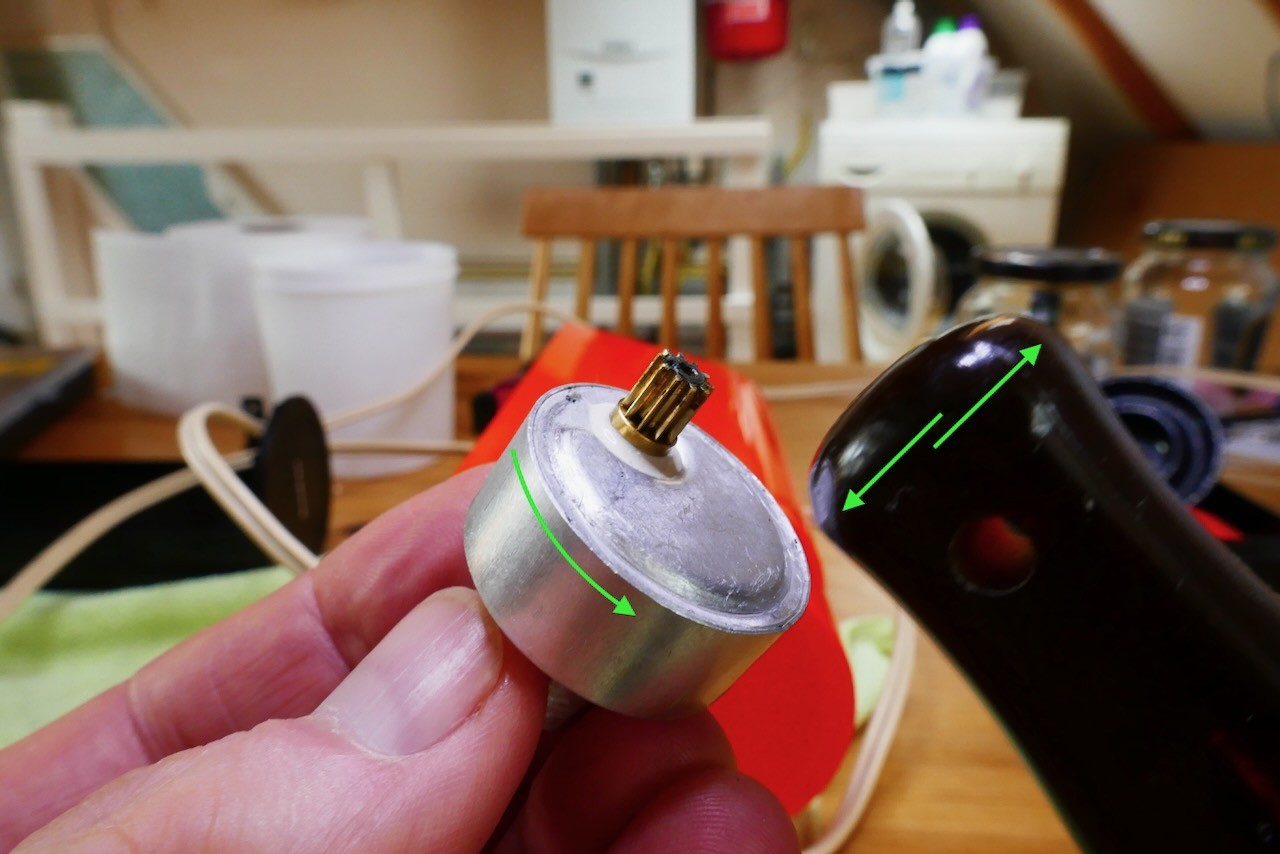

      Instead of drilling I would try open up the case. This may be difficult to do, but is possible (at least with Sankyo, Tamura and Toshiba motors, so I hope also with this Omron).
      First step is to scrape/chip away the seal that keeps the lid in place (I heard a corkscrew is a good tool but did not yet try that). Make sure that the inside of the can is absolutely clean to prepare for the next step.
      Then comes the big trick: tap the edge of the case with the end of a screwdriver or something alike, going round and round in circles. The reaction to the shock will make the inside of the motor slowly move towards the edge of the case.
      Once at the edge of the case you should be able to pull the lid out.

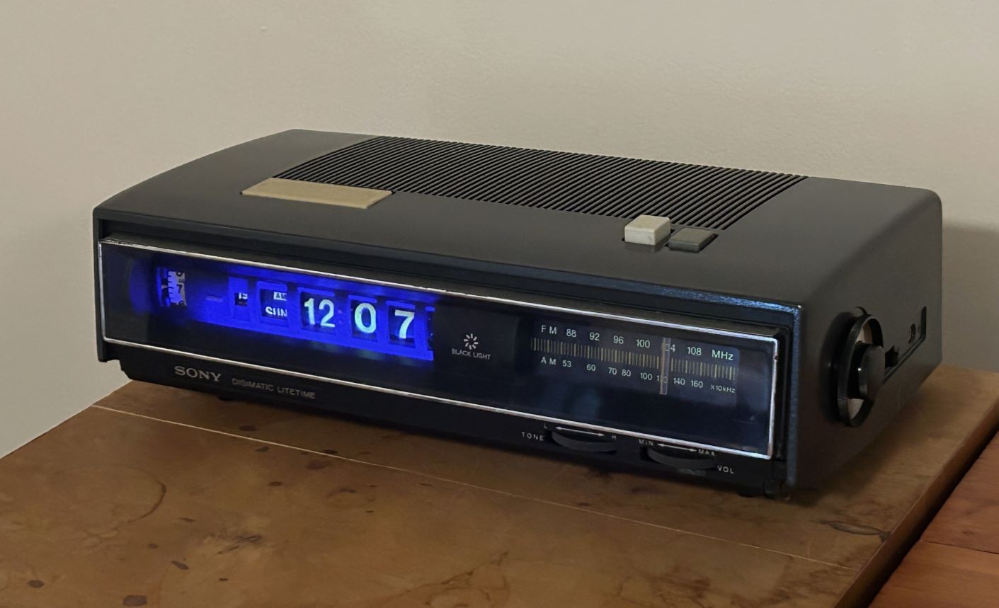

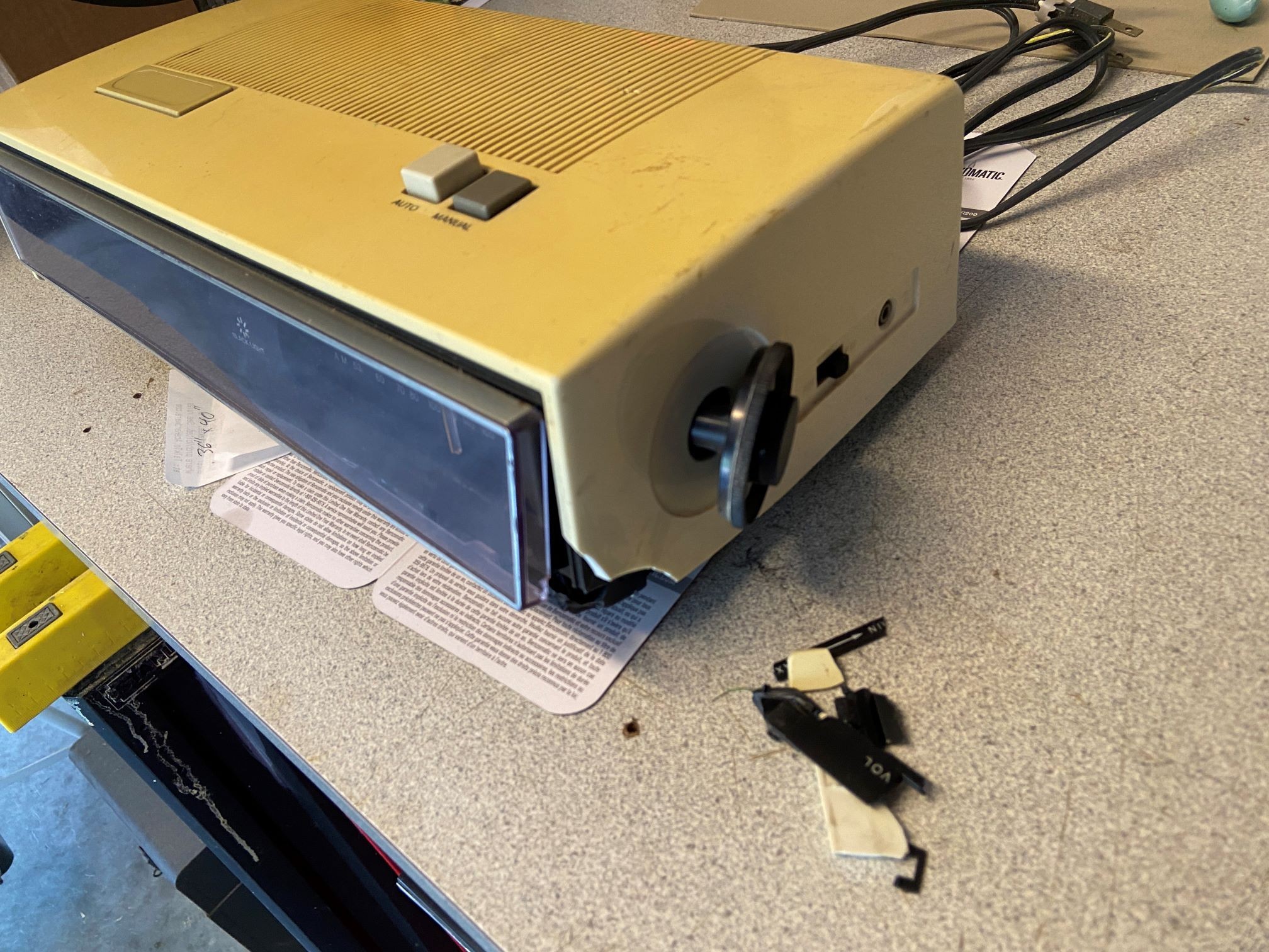

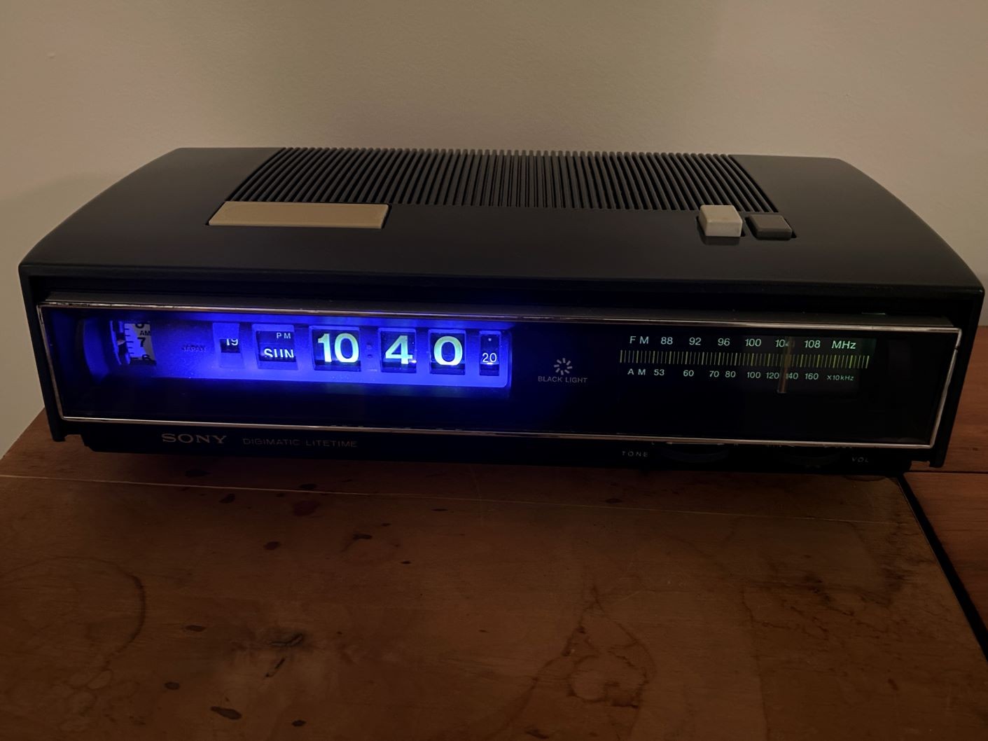

              Thought I'd share my odyssey with my TFM-660W roller clock. As others have mentioned, this is not one of Sony's best clock radio efforts. The motor is problematic, the original black light bulbs have almost certainly faded out by now and the whole unit is huge for a bedside table. I didn't know any of this when I bid on an eBay listing last summer. It was cheap, I am a Sony fan and I thought it would be an interesting project.
              I won it for cheap but it was poorly packed and suffered damage in shipment.

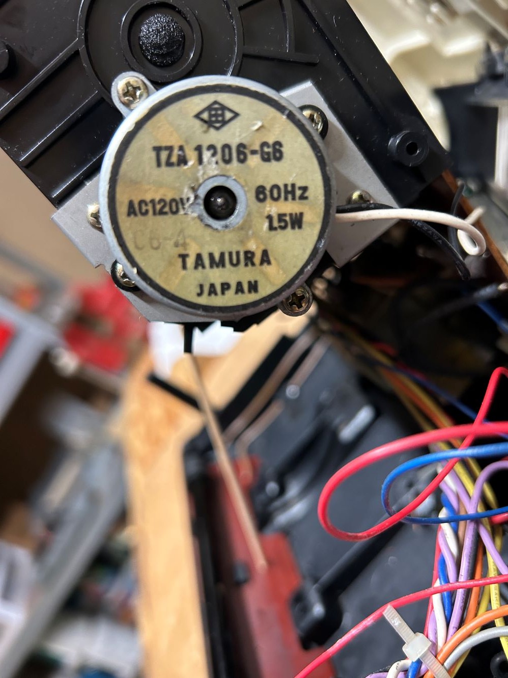

              Despite the damage, the radio still functioned and the seller agreed to a refund so I decided to see what I could do with it. I was able to super glue the case back together and repair the tuner shaft but it was never going to be a restoration candidate. Next step was to see if I could get the clock running. Apparently there were at least a couple of different versions of the motor used with the Omron motors reported to be particularly problematic. Fortunately (?), the motor in my unit is a Tamura and ran fine after lubricating. The bushing that centered the motor axle had disintegrated so I modified a wire nut (!) as a replacement. Not pretty but it works. It's actually now quite quiet and runs great.

              At this point, the clock and the radio both worked well but it was butt ugly. I had to decide how much more time and money I wanted to put into this thing.

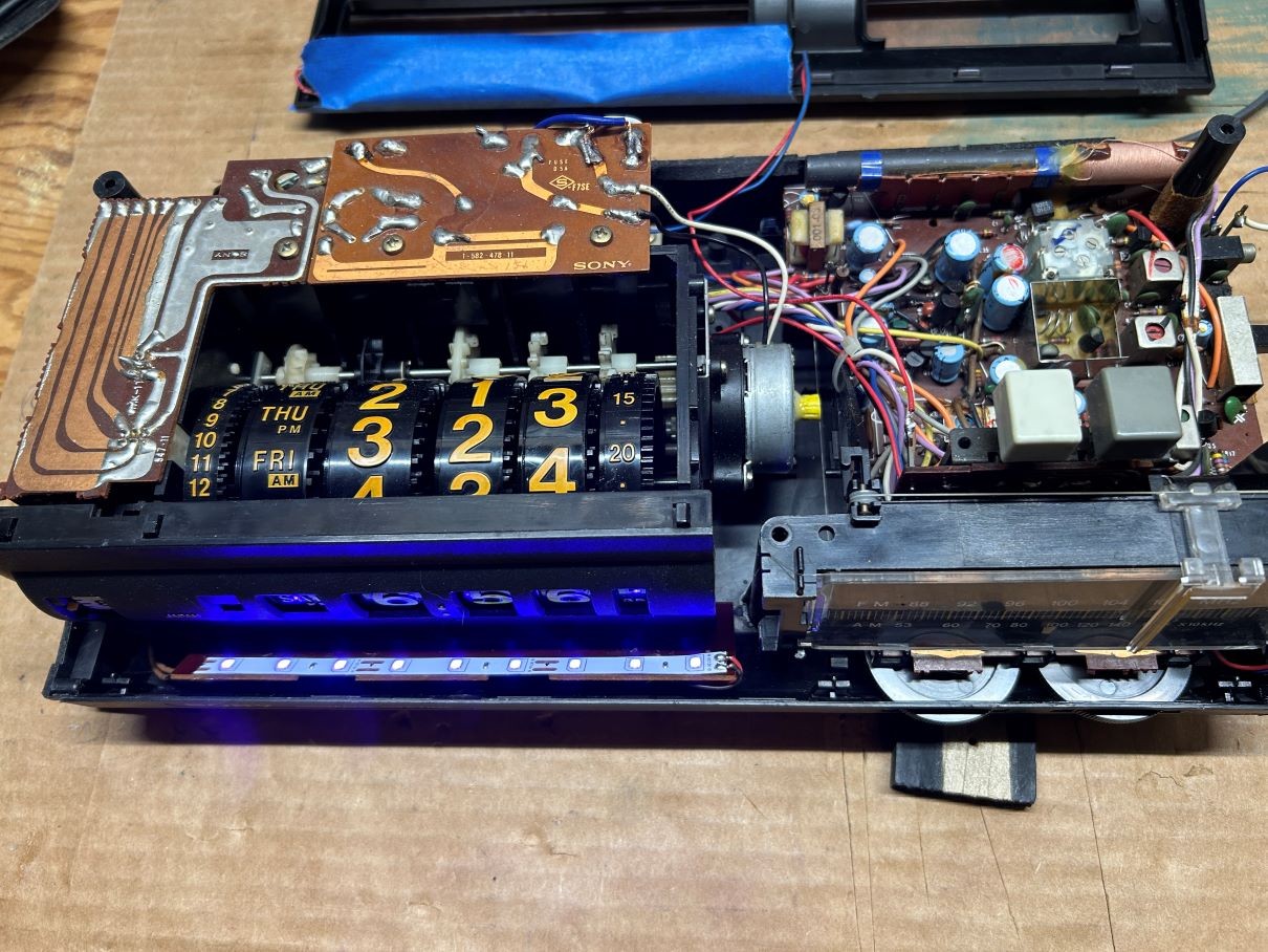

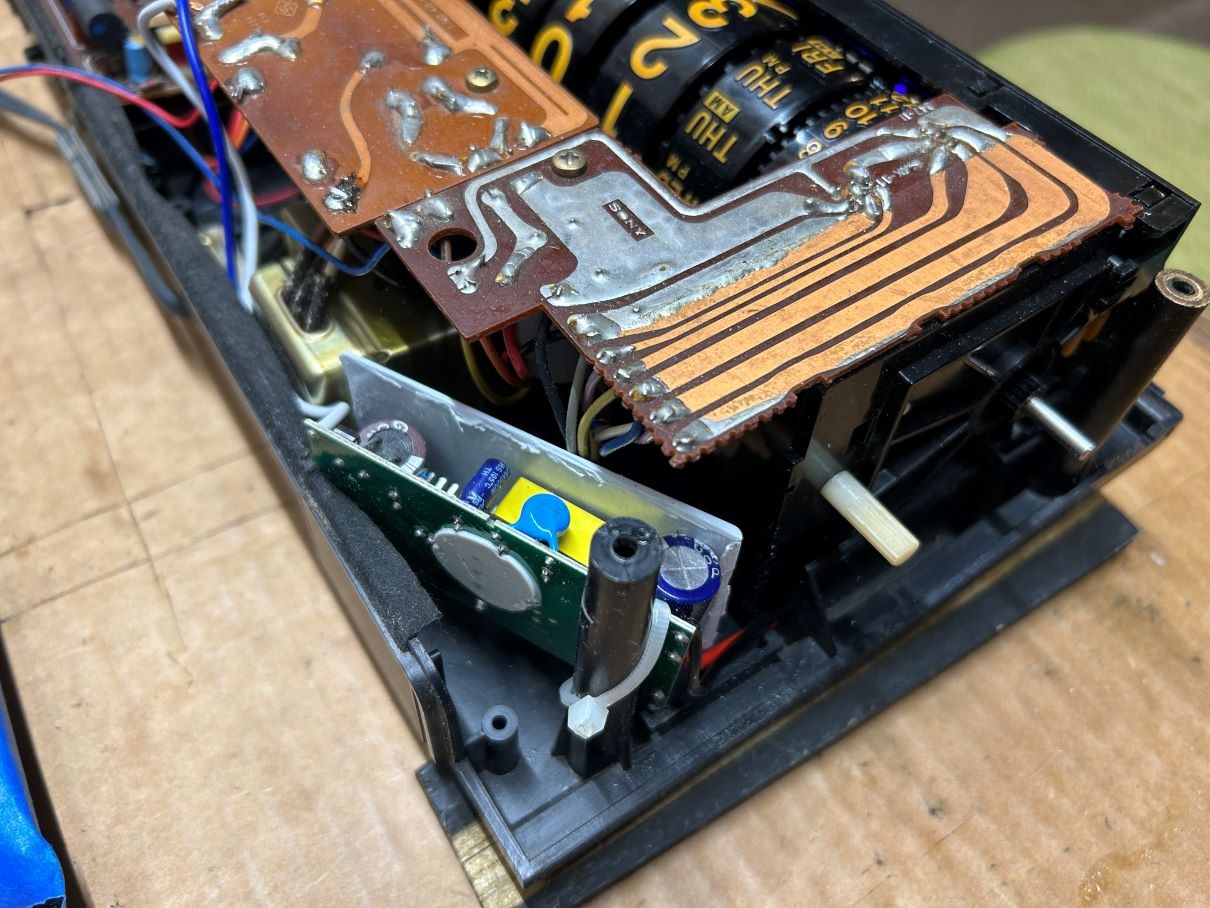

              I was curious how the black light would look so decided to try the LED replacement light strips and to paint the yellowed, cracked up case a dark charcoal. I ordered a cheap UV LED black light strip and an LED driver on eBay and picked up a can of plastic compatible automotive spray paint at my local auto parts store.
              The power supply was too big to squeeze into the case so I cut open the case with a dremel tool and found a place to squeeze in the bare board. I removed the original black light tube and wiring and mounted the LED strip to the original light PCB.

              Painting the case was pretty straightforward. I think the LED black light is actually a bit too bright for a bedroom but it's fine in my office where it's very easy to read from across the room. The radio is actually very good with great sensitivity and tone. I'm glad I didn't just dump it into the trash.
