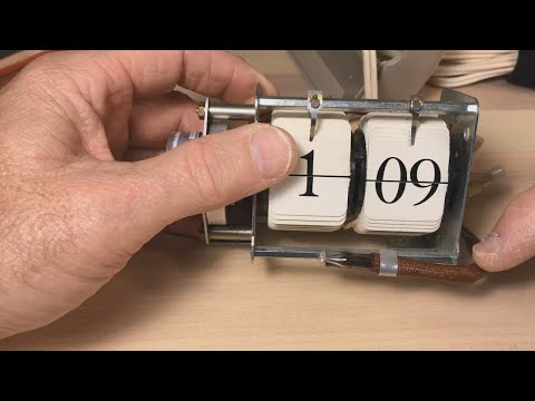

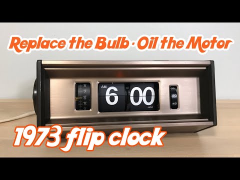

          To get an idea to what is needed to replace the light please watch these two video's:
          As you can see in these video's you will need:
          - a neon bulb and the accompanying resistor for the voltage the clock will run on (110V / 230V),
          - soldering tools,
          - and probably some pvc and/or heat-shrink tubing.
          I'm not sure where the bulb in the 412 is mounted. It can be outside the number wheels or in some Sankyo models it is mounted inside the drum rolls to light the numbers from inside. This can be a bit more tricky to replace.
