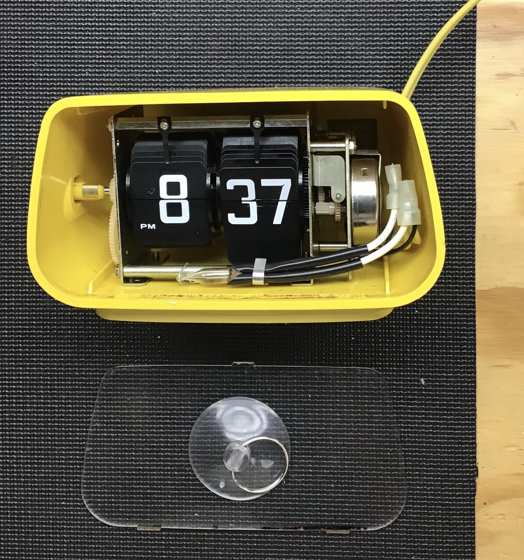

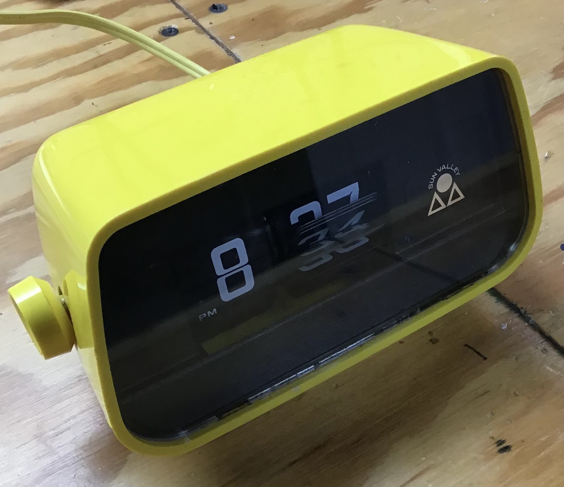

    I just unboxed this cool little yellow clock. The motor runs but the tiles are messed up. The light works but it’s very dim. The cabinet has vey light scratches but no cracks.
    I’m looking for some help opening the cabinet of this little clock. I don’t see a seam. If anyone has restored one of these and has any tips, it would be great.

    You pop put the front clear piece. You can lift up the top and it will separate a bit allowing you to use something to gently pry that clear plastic out.
    The Faces West Model 3600 shown below is the same clock as your 1030
    About 2 minutes into the video below I show how to do this.
    The video is kind of wonky because I keep dropping quotes from the movie.
      I used a little suction cup on the window to help move it in and out.
        • 499
        Great! thank you both. I thought maybe the lens was the way in but didn’t want to break anything. I have a small suction cup also, great idea
        Bingo!
        Got it! Thanks guys

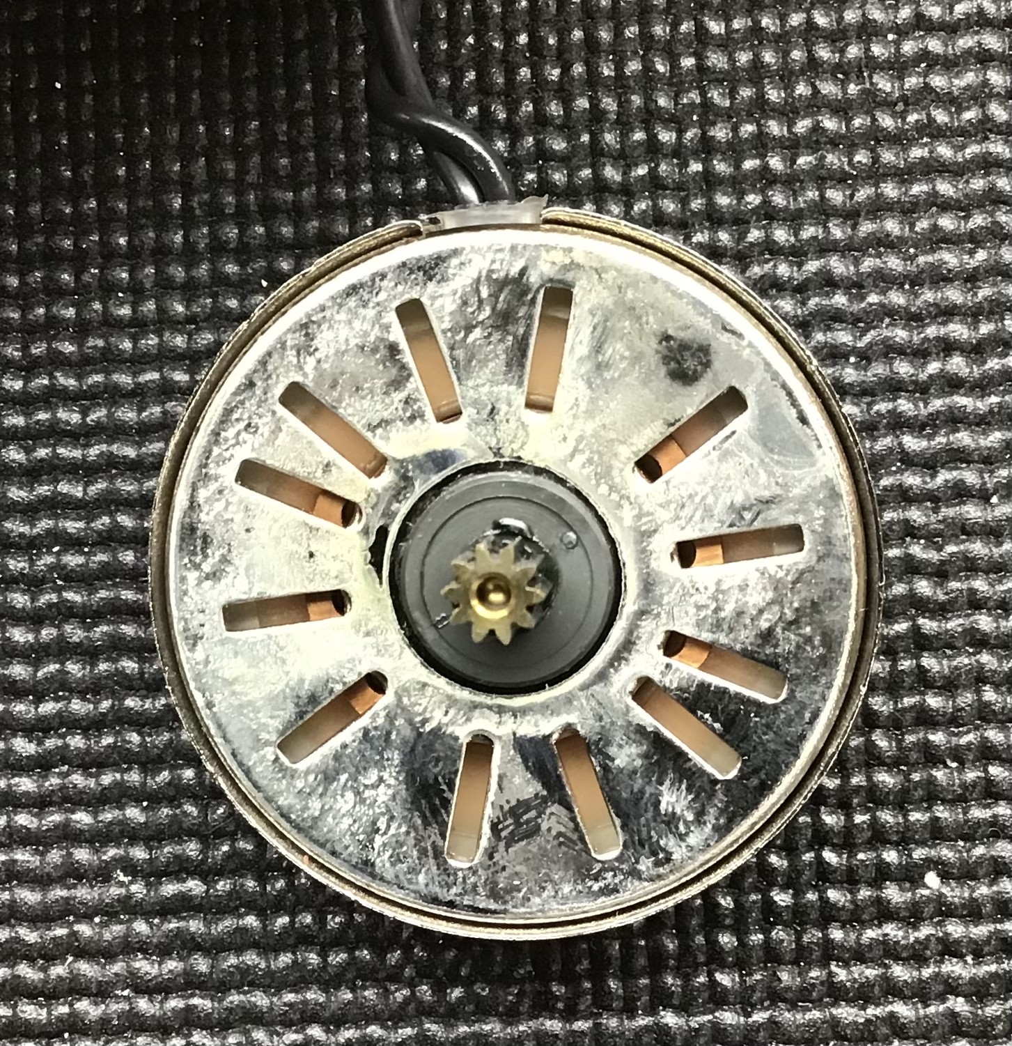

          Everything comes out the front. The motors are a pain in the a**. They are usually VERY packed full of old grease and take a lot of cleaning. I may have some pics if I can find them.

            Well I was able to fix the tiles that were falling together. At first I thought it was related to the clock movement but it turned out to be the tiles were stuck together. Something got on them possibly when someone tried to oil the movement. I’m not sure what it was but they were really stuck together. Fortunately it came off by wiping them gently with warm soap and water.

                  The motor can be disassembled. The gearbox is loosely toleranced so the the grease actually acts as a buffer to the gears won't walk along their shafts. The one I worked on was PACKED with grease, but it had hardened. After cleaning I packed it with synthetic wheel bearing grease. I mean PACKED. It ran fairly quietly after that.

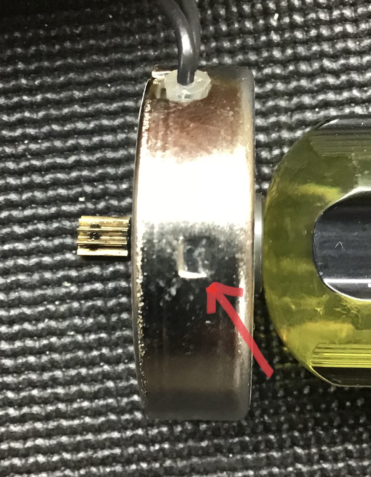

                            Here is a photo of the little motor that powers this clock. The motor is the source of the “tick” now that it’s separated from the external gears. Is their a good way to get this open? Their is 3 spots where the outer is staked to the inner portion. Their is some play (in/out) on the axle with the small brass gear.
