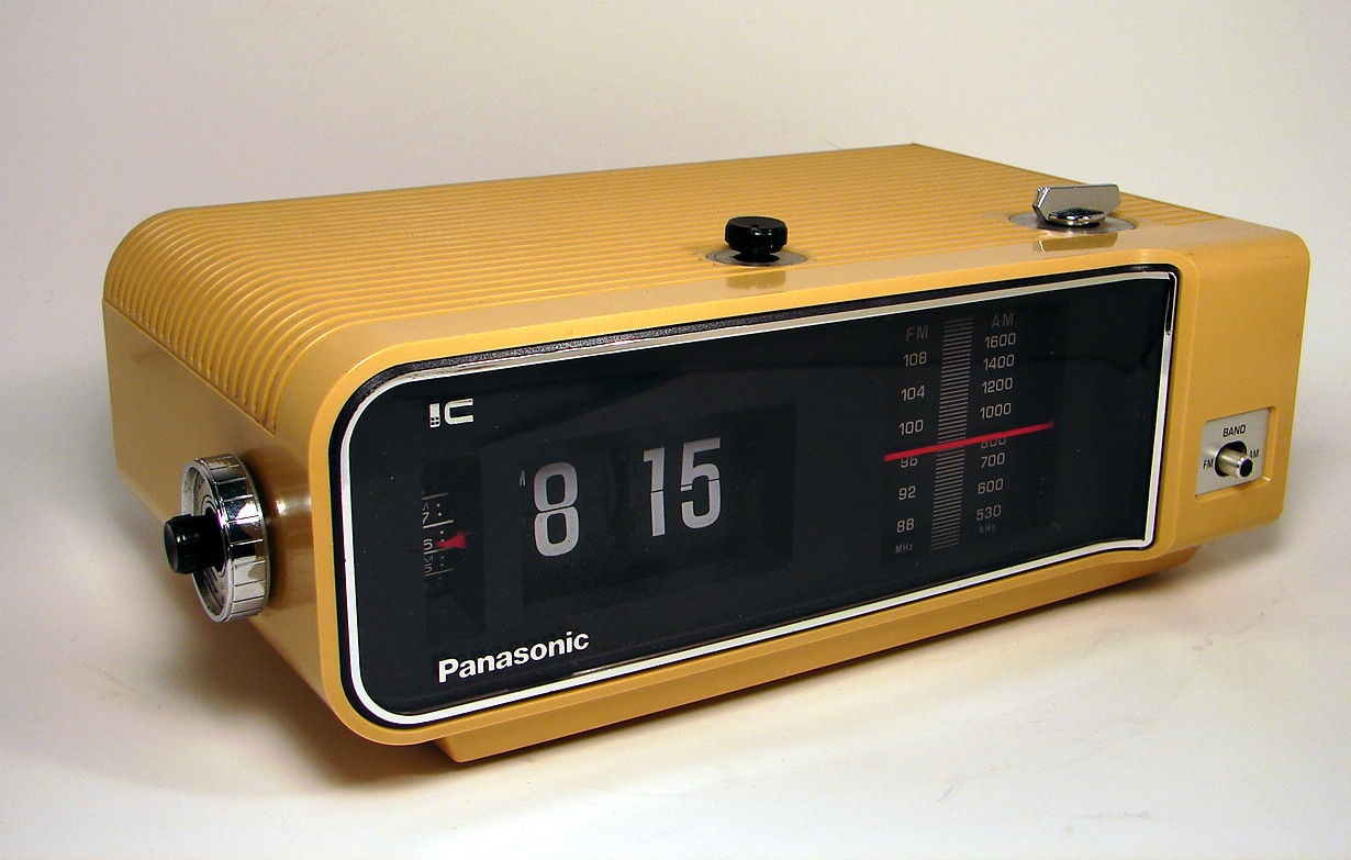

Power Source: AC 120V 60Hz 5W
Measures: - enter here -
Lighting: incandescent bulb
Colors: white (aka pearl white or antique white), beige (aka tan) and later offered in harvest gold
Features:FM-AM Radio, built in FM/AM antennas, music or buzzer alarm wake up, 60-minute sleep time with automatic shut-off, Full feature 24-hour digital clock, Once-only awake set, lighted dial clock face, solid state engineered, 3" PM dynamic speaker, Comes in antique white or beige.
Qualities: Very durable plastics, very good sound quality.
Problems: Plastic face plate is often sealed to the cabinet with heat (melting plastic tabs) making removal very difficult and perhaps unwise.
While not technically a problem, digital cameras at times render the "autumn gold" colored clock as almost a banana yellow. This can be seen in the image above. This is not a true representation of it's actual color.
Restoration Tips: Relatively easy to disassemble. If clock is not flipping, the motor probably needs to be cleaned.
