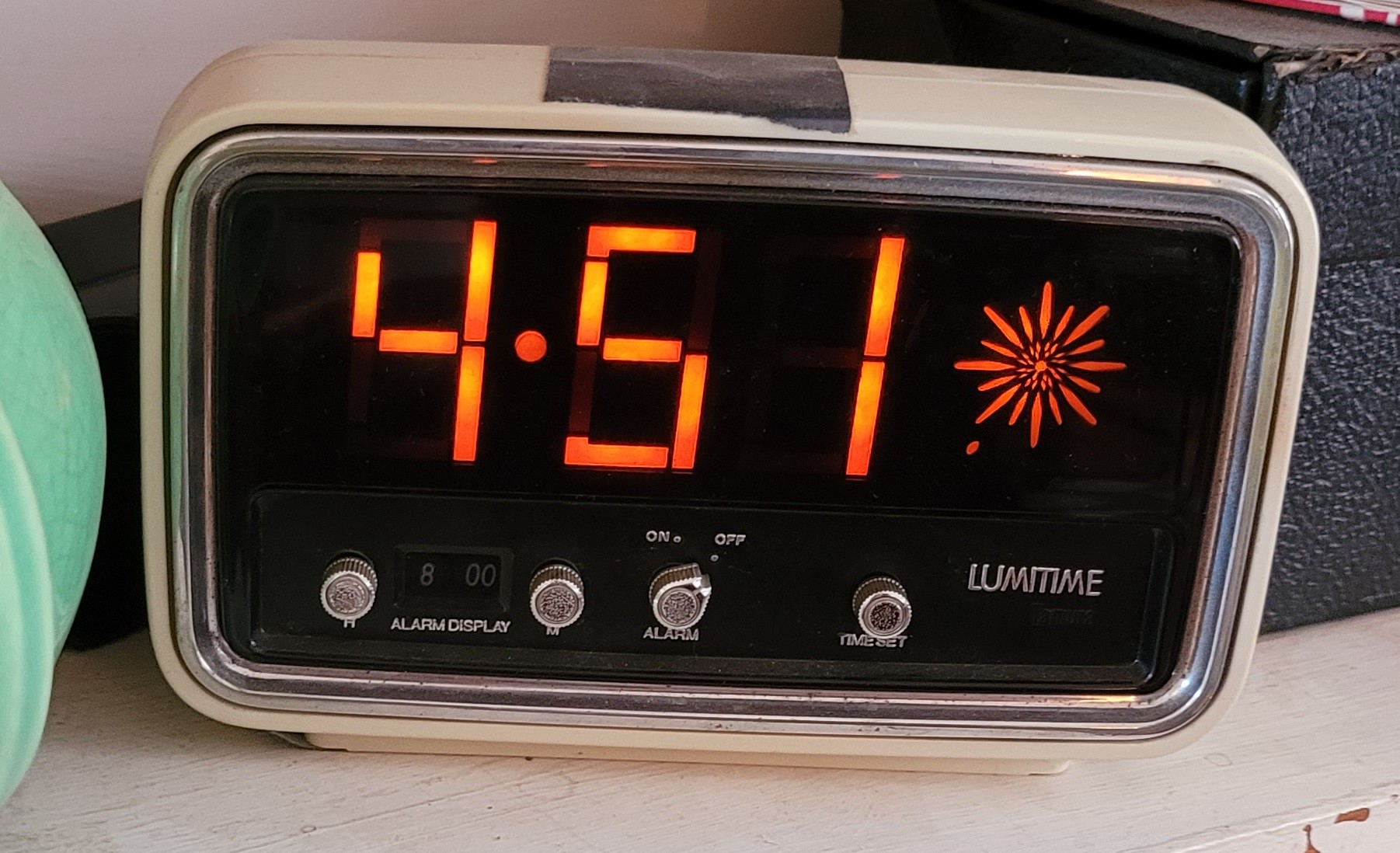

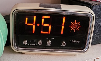

    I would love to see pictures of this. I've got a couple of Lumitime C31's, none of which have an alarm, as well as an LT-11, or some variation on that model, which has an alarm. If you have a similar looking model, I'd be glad to open it up. I've attached a photo of mine.
    If anybody can identify this particular model, or confirm that it is the LT-11, that would be great! It has all the same functions and features but it has a difference in the placement of the time set knob.
    I've only been able to find pictures similar to this and they are VERY similar. The only difference is that in the photos I can find, is that the three knobs on the right side are evenly spaced. That's not the case here in my example. I've also seen models that have a really weird spacing of those four knobs with one below the line of the others
    Can anyone confirm that that is an LT-11 and tell me what year does model came out please? Thank you!

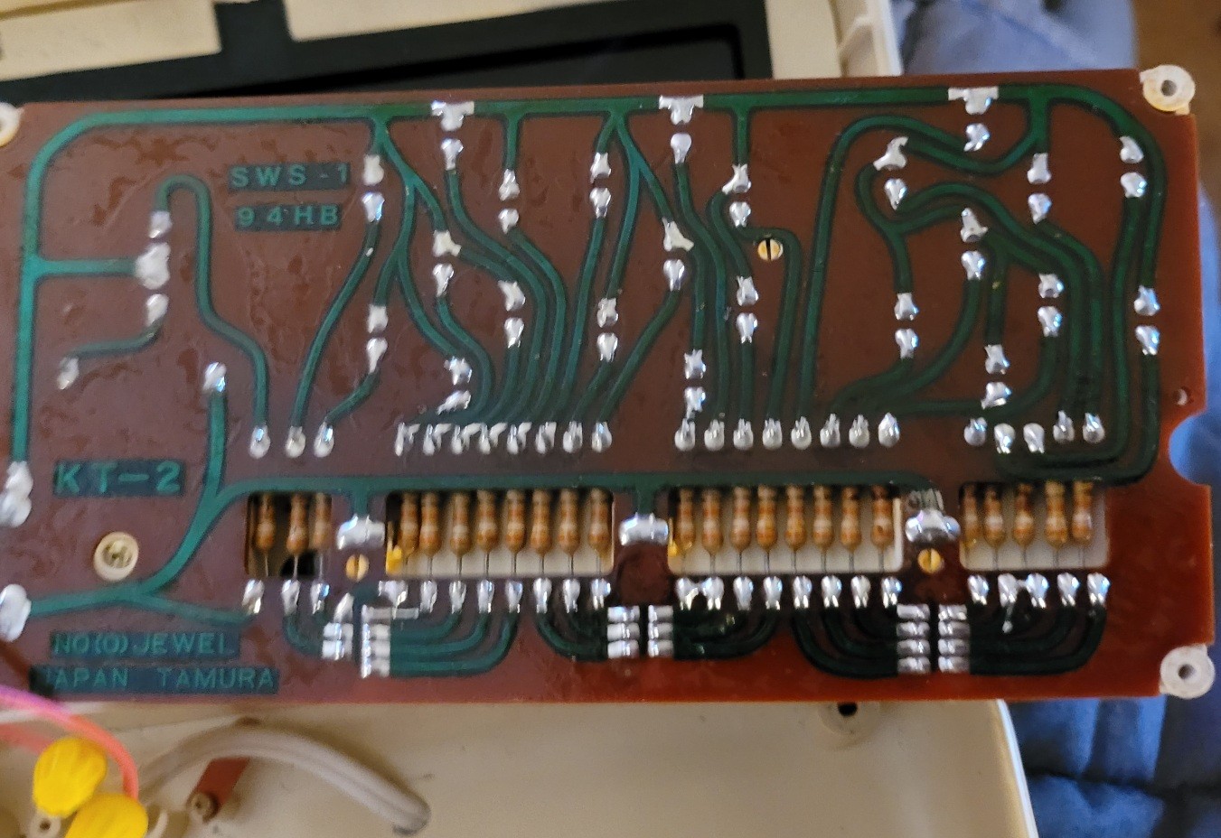

          UPDATE! I've been able to determine that my clock in this thread is a Lumitime CC-11! The discussion and content of this link (http://www.objectplastic.com/2011/02...14771543404660) is EXTREMELY INFORMATIVE when identifying these clocks.
          ​​​​​@flipoclock: This might be helpful for your question especially especially. From the site:
          "I don't know of any differences between the C-11 and the LT-11, but the CC-11 is a newer model and uses the KT-2 mechanism as opposed to the older KT-1 mechanism used in the C-11 and the LT-11."
          ​​​​​Note KT-2 marking on circuit board

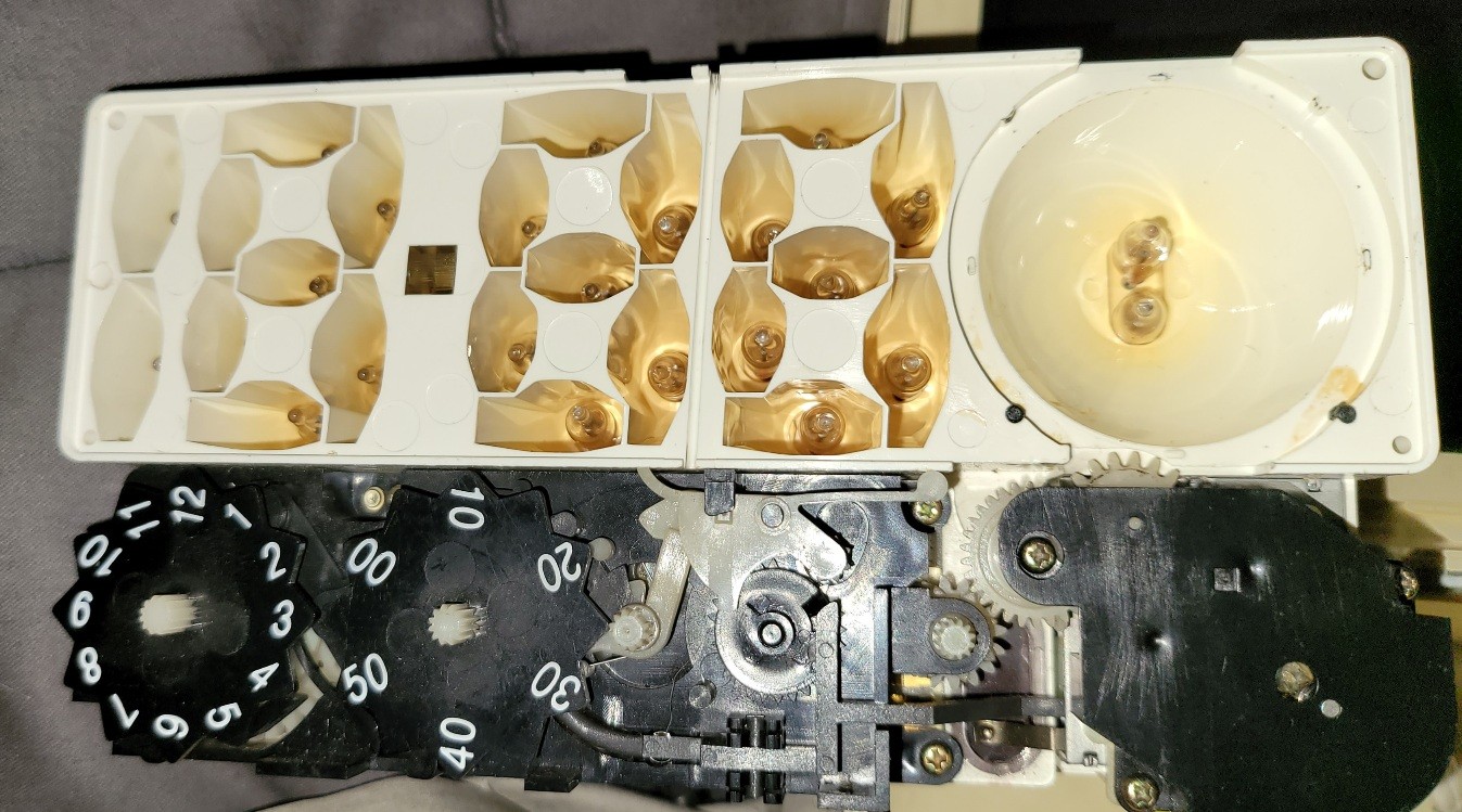

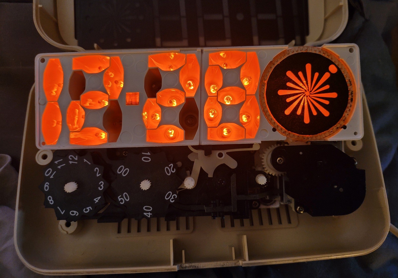

              I have started to answer my own question and have some very interesting findings for Lumitime fans!
              To anybody reading this thread stay tuned. I have a as of right now unidentified model that looks just like a C-31. However it ain't. It uses the same shutterless neon bulb switching setup as the CC-11 above! And this model has a clear cover over the the switches so we can see exactly how it works. It's so much simpler than the shutters but mechanically, a big yawn!
              Here's a picture of it slightly disassembled. I'm going to locate the rest of its pieces to determine what model it actually is but it does answer the question for anybody interested in, "How do these Lumitimes without shutters work?" I asked that question above and here's what I've figured out.
              Here's the overview. Take note of the missing linkages to the shutters you would expect.
              If we zoom in on the dial for this to the right we can see how it works.
              The yellow arrow is pointing an set of 8 contacts, and there are two more contacts to the right to the left of that gear shaft. The blue arrow points to a contact plate with odd shapes cut out of it.
              The gear setup for the rest of the clock seems to be identical to the C-31. But I haven't confirmed this. Knowing this however you can see how, in general as the gears turn, different circuits are opened and closed, turning on or off of segments (neon bulbs) of the number array.
              I will start a new thread on this as of yet unidentified model, comparing it to the flagship C-31.
              ​​​​​​​If anybody wants to help out or has questions please let me know!

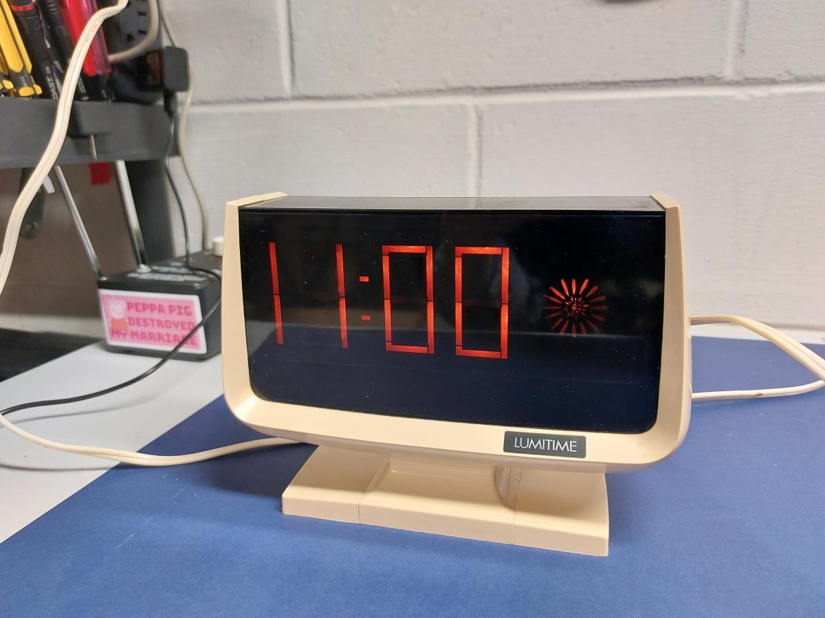

                Apologies for the delay! Unfortunately, I fear typogenerators photos will be more helpful than mine. My C31 is the mantle clock variant that lacks an alarm altogether. :P
                  I filmed the whole thing, and got the back screws off before it dawned on me that this one doesn't have an alarm button...
                  • typogenerator
                    • Apr 2017
                    • 25
                    I'm very perplexed. It was always my belief that the C-31 was the shutter-based model.
                    Based on Performa's pictures above, and my own C-31, this is not the case! Those use the a comparable switches-based mechanism I photoed and attempt to describe above (model CC-11).
                    So, are there any Lumitime experts out there to help?
                    Thanks!
