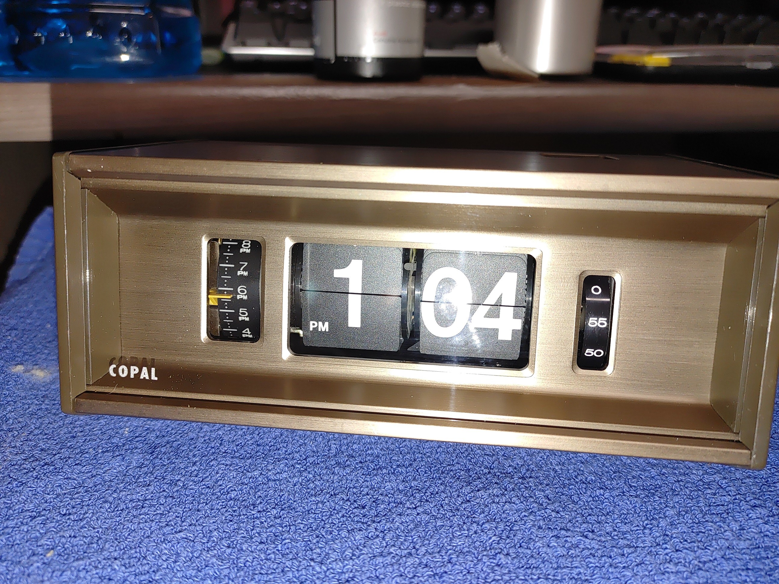

    Hi all. I came here as some of the videos on you tube were from flip clock fans.Never had a flip clock before. Born in 1990 we had Sony radio alarm clocks with the red numerals when i was little kid. Always been fan and have a collection of watches, especially japaneese ones. Have a Casio woodpecker alarm clock but never had a flip clock. Now that i have one, i am i love more than ever.
    For a while I wanted to buy at the least 2-3 different flip clocks. 722, 601 and 702 for sure (mainly for the glass and aluminum body, no plastics)
    After waiting for the right one, a bronze 702 came for sale on ebay for $185 with best offer . I did offer $100 and seller accepted - YES
    It is working. Alarm works too. It has very little cosmetic blemishes and it is really dirty. This is ok for me, I will clean it up.
    I watched the video for disassembling it and also for oil the motor. And also the night light is very dim. It is not the way it should be. Dimmer than normal dim.
    The green light on the left works too.
    Maybe i will try to see if it keeps time and will then maybe open it up or if someone professionally knows how to tune it up - let me know, i can send it
    Also i have 1 question. If the alarm is on and starts buzzing - I snooze it and then it comes back in few minutes, this is normal, right? I think i have to switch it off from the back to shut up

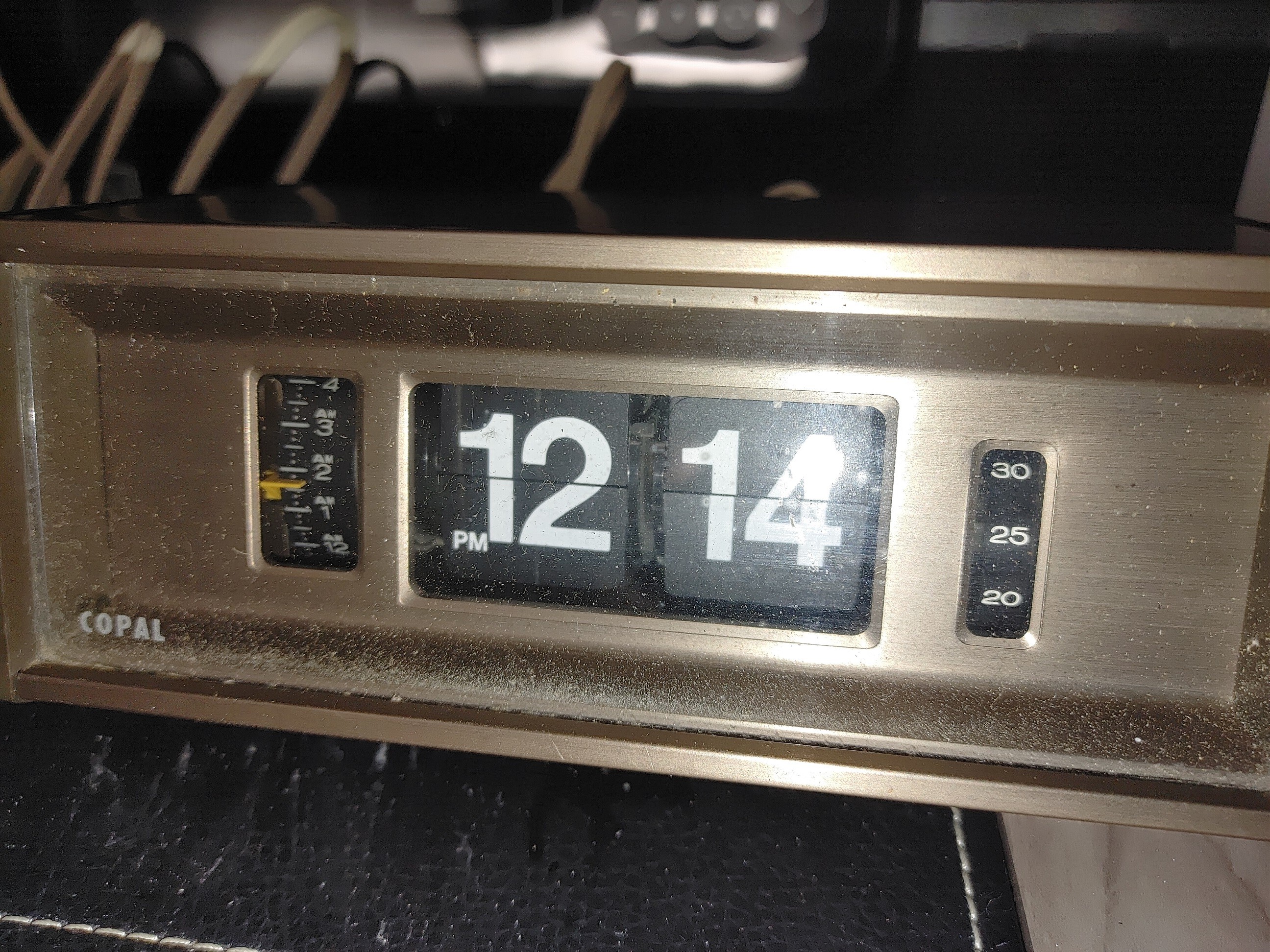

    this is the picture and on porpoise has flashlight so it can bring up the dust
    First time my wife saw it - she is intrigued by it.

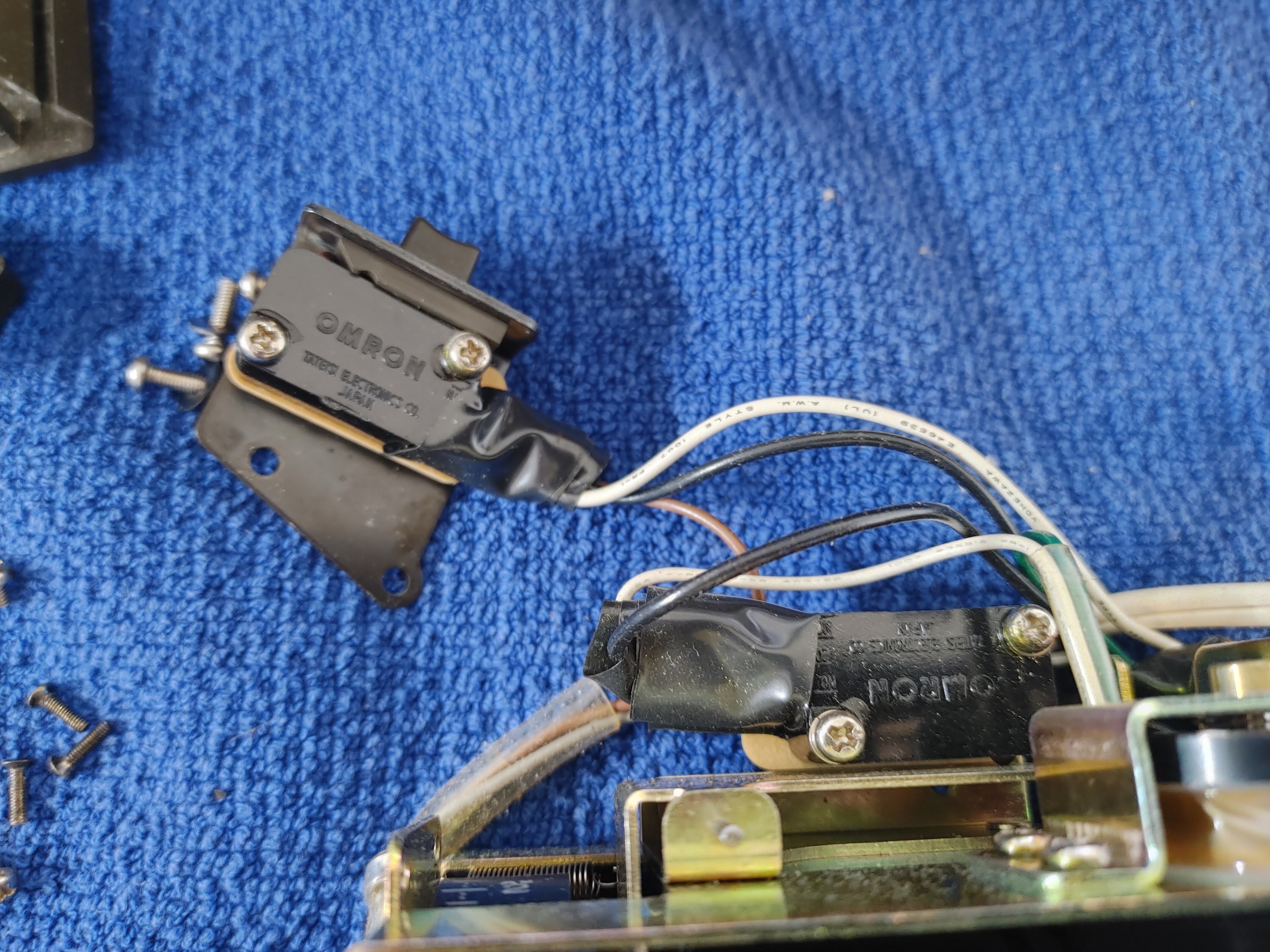

          Bronzie for sure was repaired of some sort. I noticed modern electrical tape on and around the switches for the alarm buttons and mechanism. Picture below

          Bronzie was incredibly dusty. Took an hour with small painters brush to dust it off and even took the time to gently wipe off every single tile twice, just to remove all the grime that has accumulated over time. I think now it is so much better knowing its clean inside. I am sure over time the rest of the dust will come around again but will clean it again if needed.
          Once I slowly removed the mechanism from the case, walking it slowly without binding on the alarm indicator or the seconds wheel I powered it up. Started right up and in about couple of second it stopped.... I was shocked. Started to look around if I broke something but I did not. I think it is important to say this was BEFORE I attempt to clean it whatsoever. Switched it on and off again and still nothing. I could see the motor wheel moving with snail speed. Gave it a few spins with a finger and now is was much harder to move than before. I wonder if from removing it and rotating it side to side to remove the screws I may have introduced the accumulated dust on to the shaft or bearing. I mean it sure did have more than plenty of dust inside the case.
          The bulb was blackened but still works

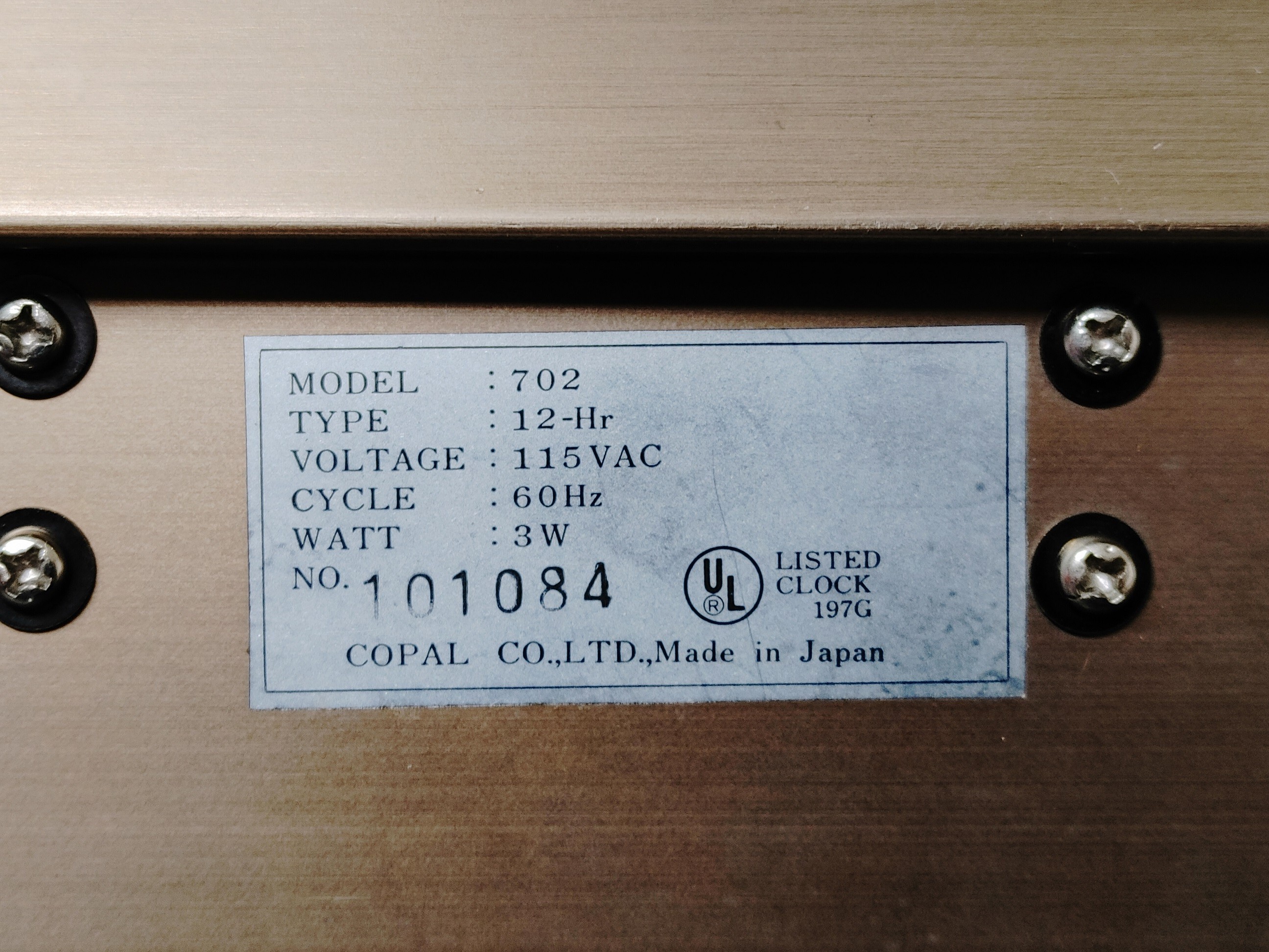

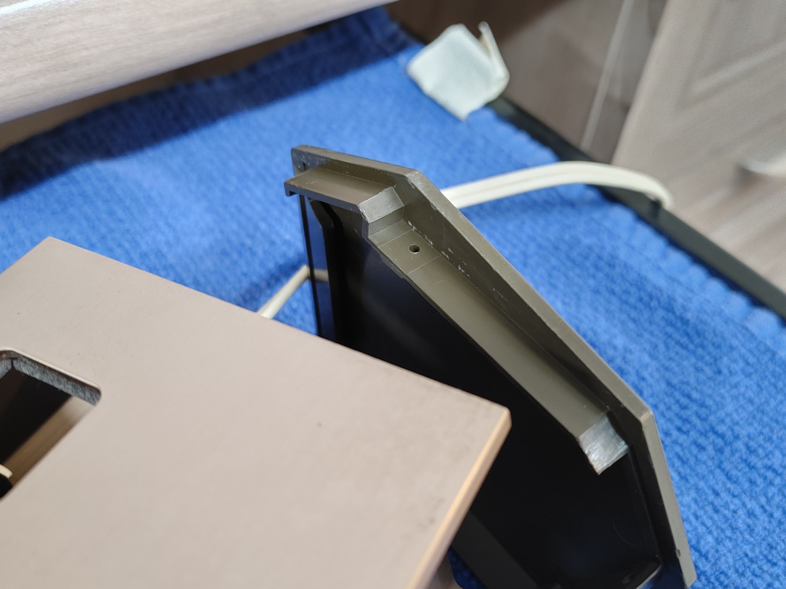

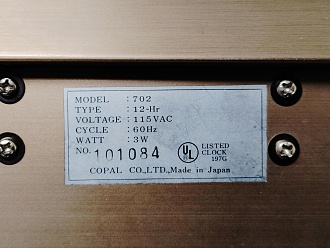

          Another thing I noticed that Bronzie was probably an updated or "later" clock. LOL Looking at the video and explanation - the side panels have tabs which were maybe shared with another model and they were held just by the screws rather than those tabs. Looking at Bronzie's serial number (101084) it appears to be higher than the one on the video (74091) which makes me guess they updated the mold of the plastic and now they are just smooth and no tabs. Also it says 3 Watts rather than 6 Watts. Go figure

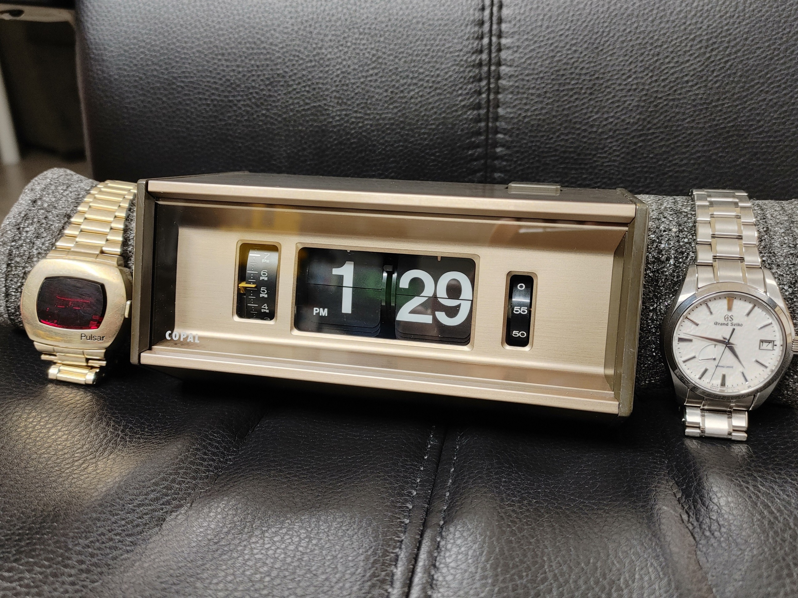

          I mean just look at it. Such a beauty. The glass seems almost invisible. The shape of it and also the color gives it a "stance"
          So today the happiness was short lived - Bronzie worked good for half a day and now it's not. Maybe that is why I should not attempt to fix stuff that I don't know. But most definitely this will not be my only flip clock. I want a smaller, a bigger and a wall flip clock in the future.
          I did make a photo of the two watches I think it does reminds me of.
          The "Goldie" Pulsar P2 that was made in December of 1972 (selling in 1973, same as the 702) and it was priced as some Rolex models. It has this look of "Goldie" and "Bronzie" that nothing around it is shaped like that. The second one is Grand Seiko. Very overbuild watch and looks modern, retro and futuristic at the same time. Same as the 702. Pictures make no justification

            Interesting about the tabs, I had not noticed that before, thanks for pointing it out! With regard to your clock stopping to run, from your description, it sounds like a worn 1st gear unfortunately. It is fixable, but will require some work, digging and a new gear of course! Good thing you paid no more than 100 USD!

              Also do you know why my version, that is clearly the US version, has 3 watt motor rather than 6?
