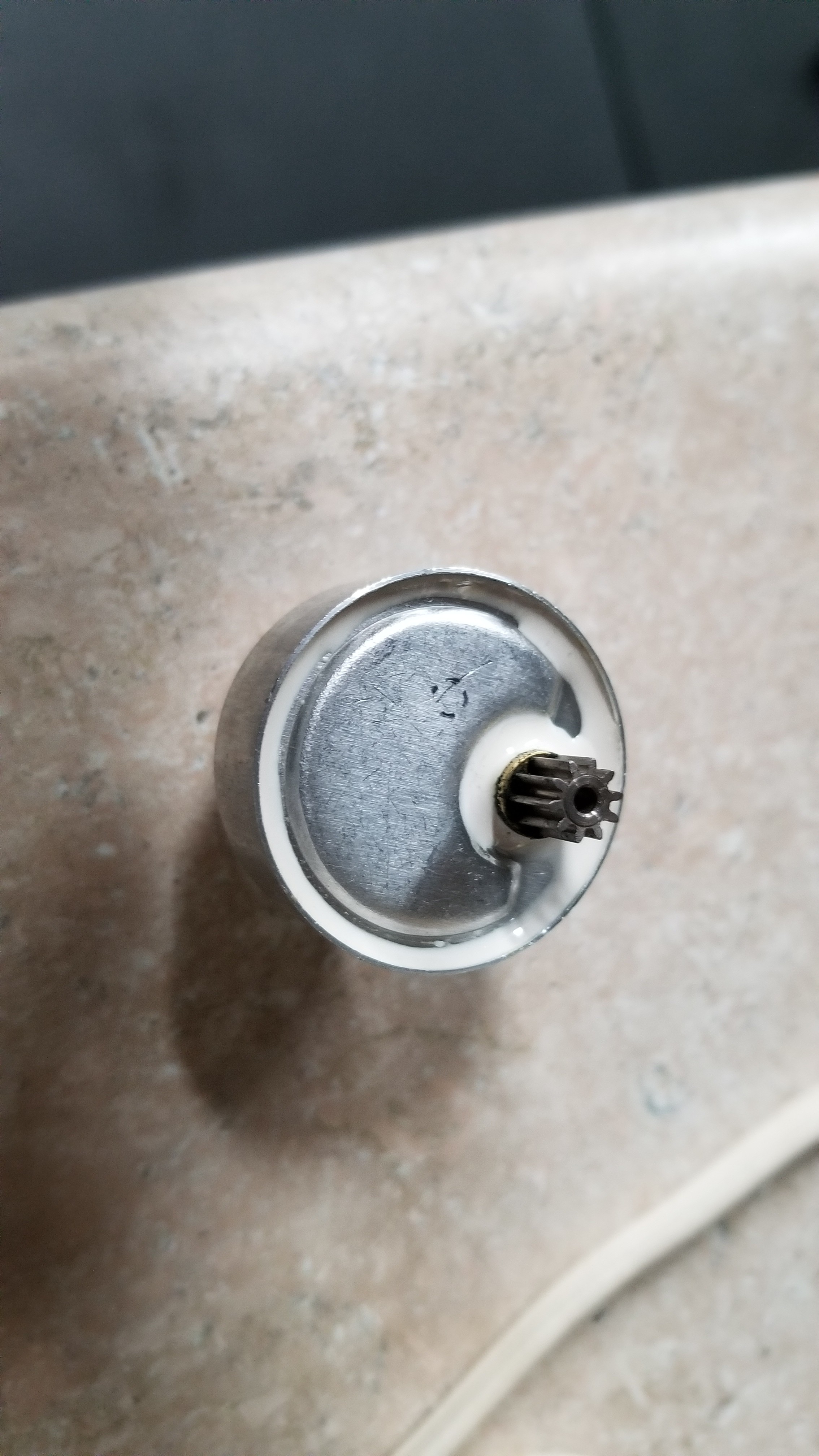

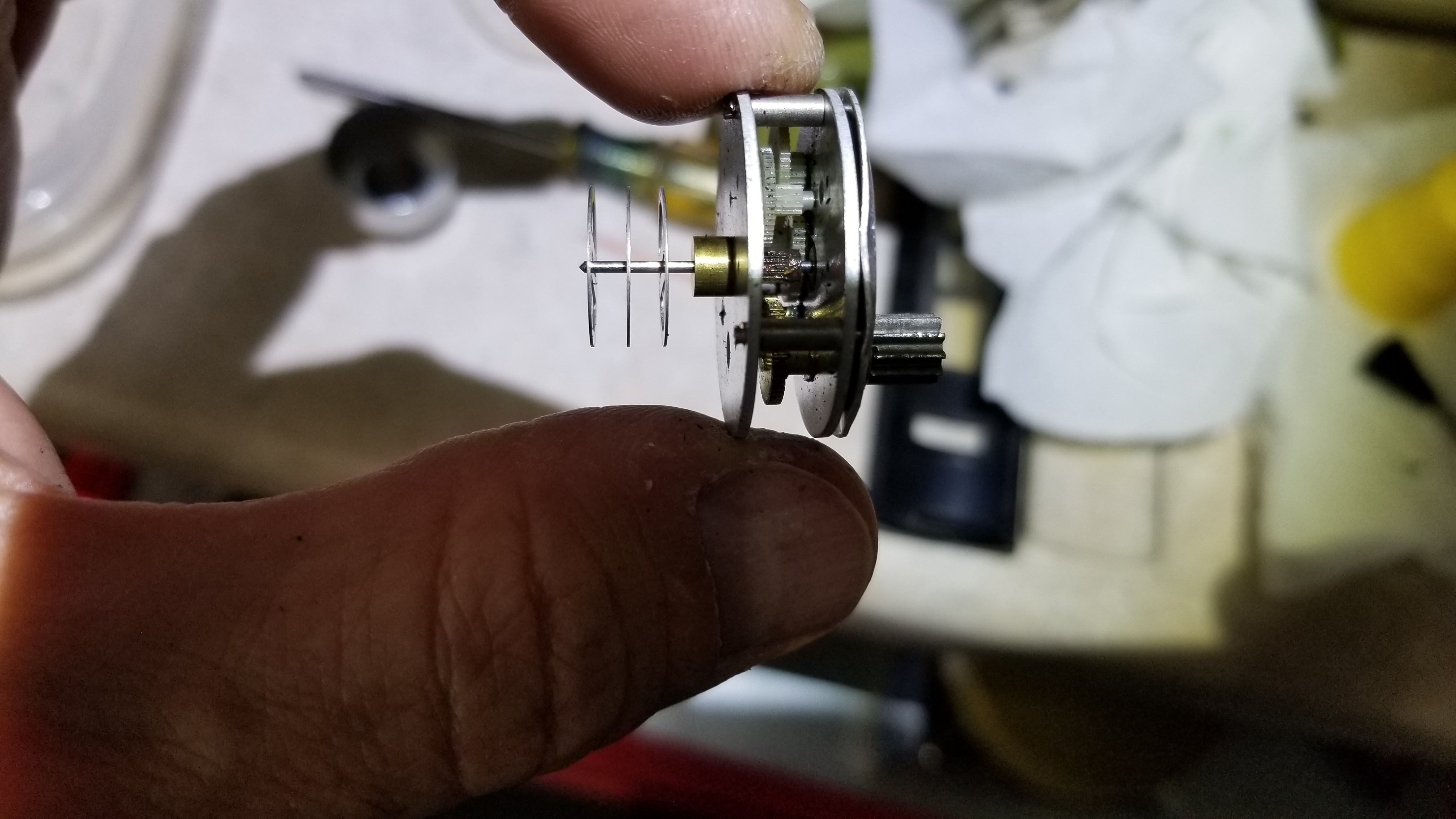

    Good morning, need some help with sankyo 412 and 401 clocks. I have 6 of them that I'm refurbishing. Both models have the telechron motors, number on tag says gbh6b1 and I'm unable to find replacement. I carefully took the motors apart to clean out the dried grease and lubricate with quality clock oil. Only 2 out of 6 have gears in great condition. 4 have the tiny gear for center shaft that has the 3 evenly spaced discs that spin the gears by the magnetism, those tiny gears have deteriorated. Is it possible to get those gears for replacement?

    That is going to be a tough one, but you can try: www.telechronclock.com
    This man mostly works the American market (hence being 110v/60hz), but possibly also has parts for 220v/50hz?

      Yes, I did email that site as well. These sankyo clocks are 110
        • 2355
        I am pretty sure that he will be able to supply you with what you need, it will be pricey though :-) But hey, better expensive than not available at all, right?
          I'm really hoping to hear how this plays out.
