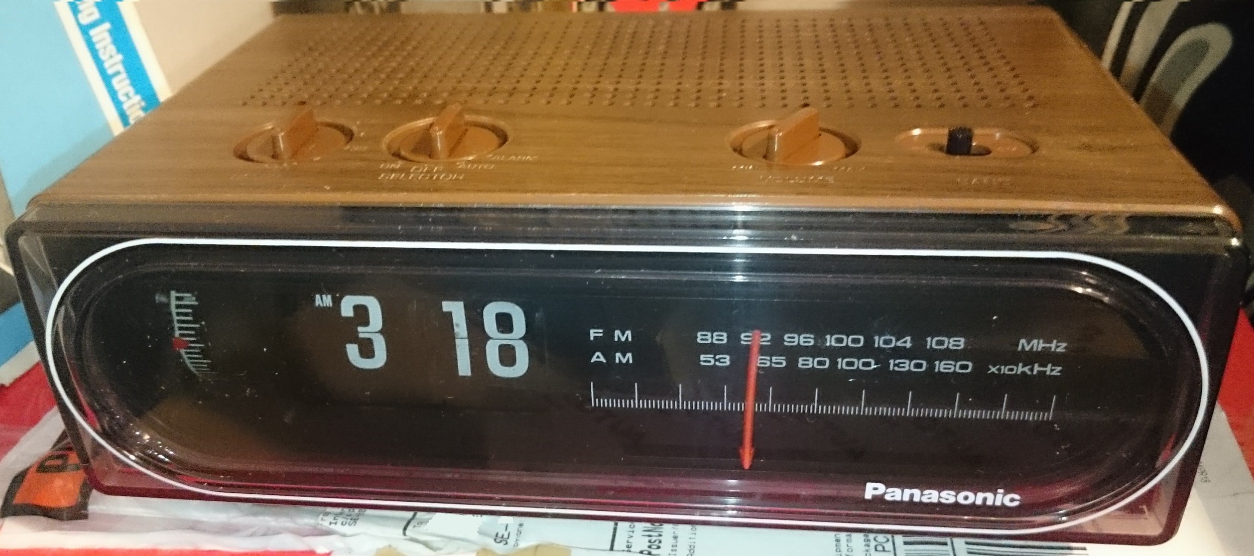

          I have a Panasonic RC-6015 which I want to sell. I bought it in a package deal of 3 clocks and I only wanted 1. I have gone thru it and cleaned and lubed the motor, cleaned all parts with soap and water and polished the front glass. It looks like it have not been used so much and I would rate the condition to be ~8.5/10. You can see some minor wear on the plastics and some small scratches. But the overall impression I think it's just below a NOS one. From the start my plan was to sell this one and I have no plans getting top dollar for it. Even though it is a nice condition all working clock radio. I feel the price on these are way to high and would rather selling this for a fair amount to someone who wants to enjoy it. I live in Sweden but I can adjust the total price to make it worth. I have no price in mind I just wanted to get the words out and that I'm flexible on the pricing. But I wont give it away.
