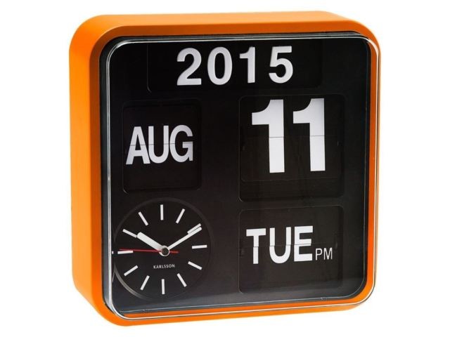

    Hello to everyone, my first post to the Forum. I am not sure if this is the correct place to post, my apologies.
    I have a basic question to ask (I hope). I have followed the instruction when setting up the clock.
    I have found that there is a short buzzing noise which occurs at 11.15 am and again at 11.15 pm. I find it strange that the buzzing noise does not occur on the hour as I would imagine it only occurs at quarter past the hour. If there is any reason or perhaps if I have set up the clock incorrectly I would very much appreciate any guidance. My thanks in advance.

    I am not familiar with this model at all. But I'm including the following for information of others.
ID:	3675Karlsson Mini Flip Wall Clock - features year, month, day and date but with an analogue clock.
    - quartz movement
    - requires 2 AA batteries
    - dimensions: 24.5 cm (H) x 24.5 cm (W) x 10 cm (D)
    approximately 9 5/8 in (H) x 9 5/8in (W) x 3 15/16 in (D)
    Made in China
    Retails for over $150.00

        I have just received the following regarding the buzzing sound on my Karlsson mini flip clock
        Jasper replied
        I remember we had a model standing here at the office that did the same thing.
        There is nothing wrong with the clock, I believe the electrical system inside in not just “working”at the whole hour”
        The wheel of the flips has more then 24 working points, so in between it’s already preparing to flip.
        I hope this makes any sense for you? If not or if you have further questions please feel free to ask them.
