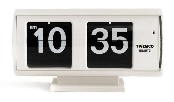

    3 months ago I purchased a Twemco QT30T Flip Clock. This week it started doing this: at 7:59, when it should flip to 8:00, it goes to 8:59 then 30 seconds later it goes to 8:00. Didn't do that when new. This is my first Flip Clock. Can you guys explain what is going on like why the 00 refuses to drop on the hour. Note the clock has not been moved in 3 months.

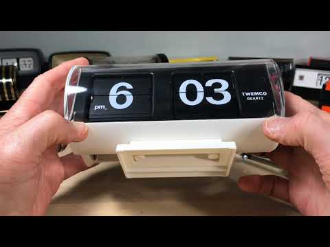

                OK. I completely disassembled the mechanism and learned quite a bit about the operation. There is no way to make an adjustment on the cam. No way at all.
                I'm making a better video about it. But so there's no suspense.... the surest, safest and completest way to correct this is to reposition all the minute digits. These are much easier to do that the smaller clock we're use to.
                I'm making a video of the tear down. I also forced the error and I'm going to show how to fix.

                    It's definitely a work around unless they put the tiles in wrong at the factory. There are indicators on the wheel where the 00 should be. Additionally the cam can only be in one of two positions. The correct position also marked. You could add material to the cam to stop the early drop, but that's too invasive if the tile position change would work.
                      Here's the video of the mechanism tear down and discussion of the fix.
