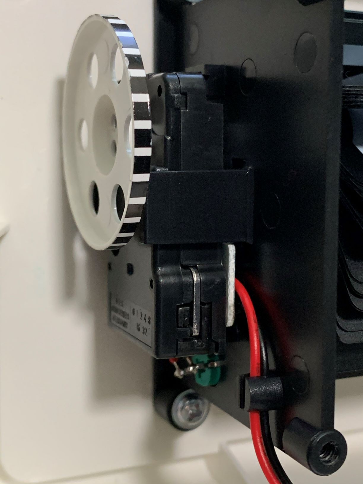

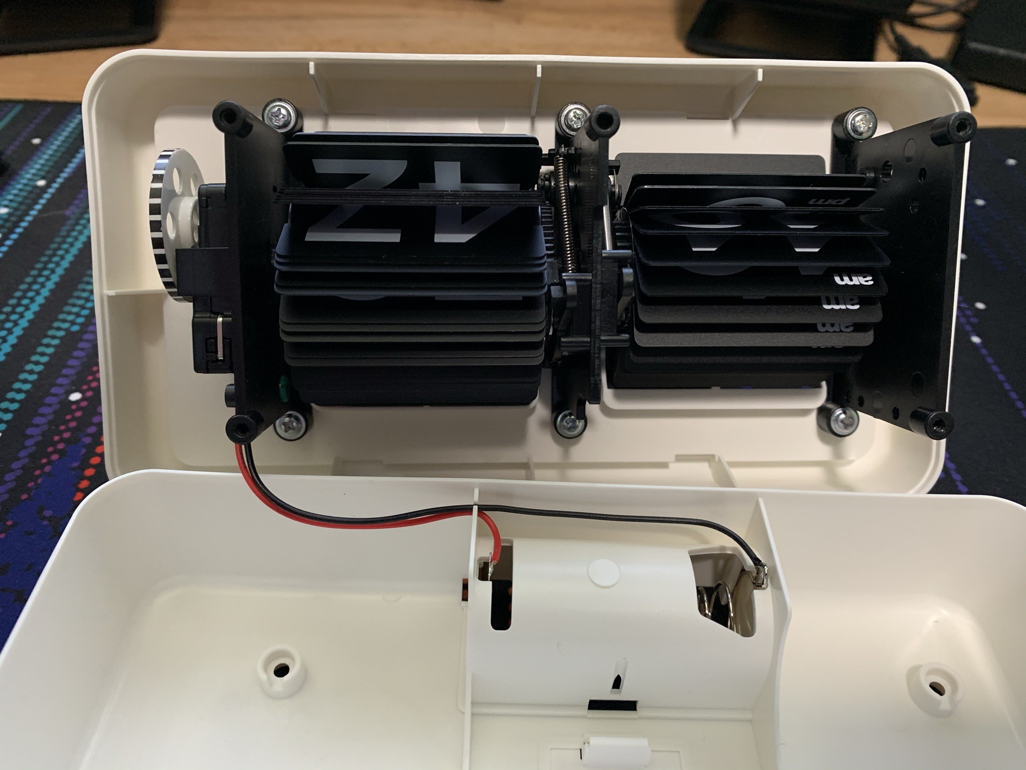

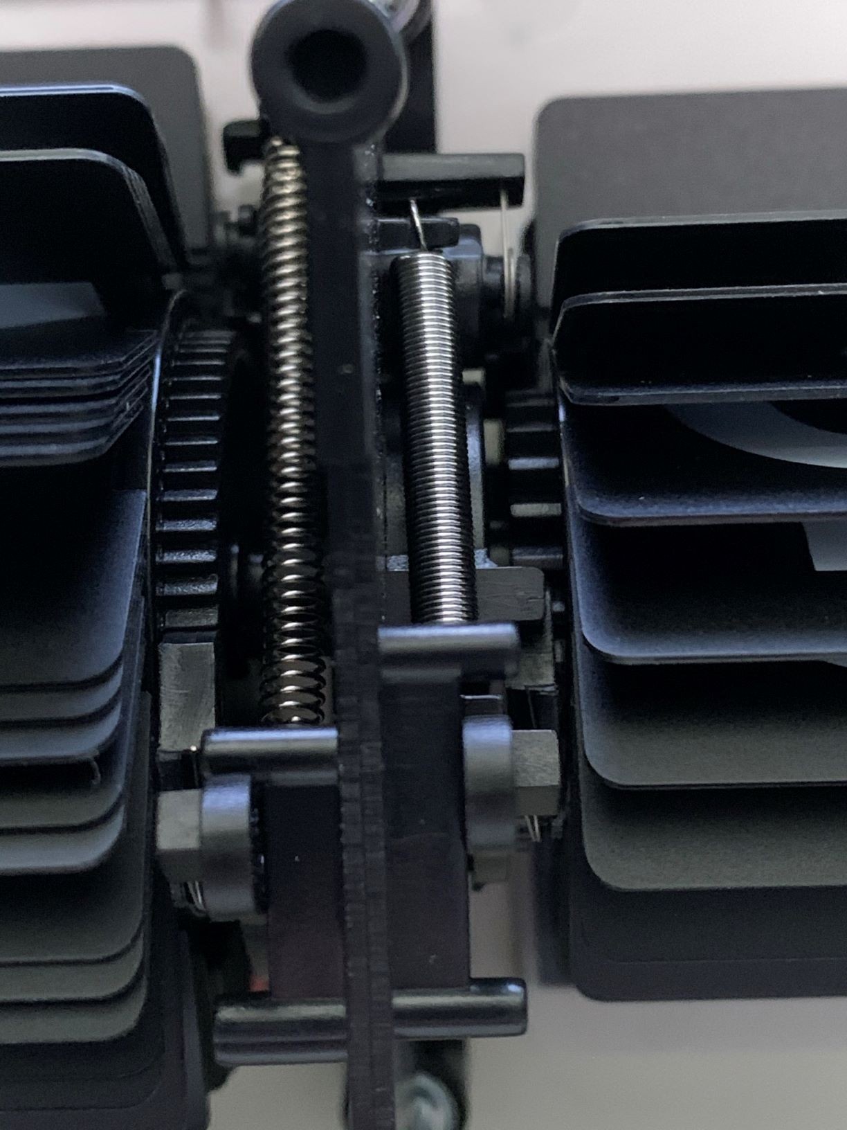

          I took the back off the QT-30:
          Click image for larger version  Name:	IMG_2680.jpeg Views:	0 Size:	474.1 KB ID:	18175 Click image for larger version  Name:	IMG_2681.jpeg Views:	0 Size:	234.8 KB ID:	18176 Click image for larger version  Name:	IMG_2682.jpeg Views:	0 Size:	303.0 KB ID:	18177
          And here's a video:
          The creaking can be heard at 0:20, 0:40, and 0:52 where it sounds like it wanted to flip, but doesn't actually turn over until 1:04.
          I've observed it with the back off, and I don't see anything catching or anything obvious.

          Yeah, the mechanism is different. The wheel on the left "ticks" every second. You can hear it in the video, but it's inaudible unless you put your ear up to it. I think my BQ-170 works very much like the BQ-50. It's dead silent until the motor kicks in.
          Is your motor this loud?
          It's very hard to find videos of these clocks without music covering up the actual sound of the clocks. One video I did see of this clock was it switching everything over at midnight, and that one I couldn't hear the motor but the loud "thunk". Mine made the "thunk", but I could hear the motor thru it. Just wondering if this is normal. It's very accurate though!
            The mechanism between the minutes and hours looks the same as in the BQ-50, but the driving bit with the motor is entirely different. To know what is going on in there you would need to take it further apart, but I don't know whether that is possible.

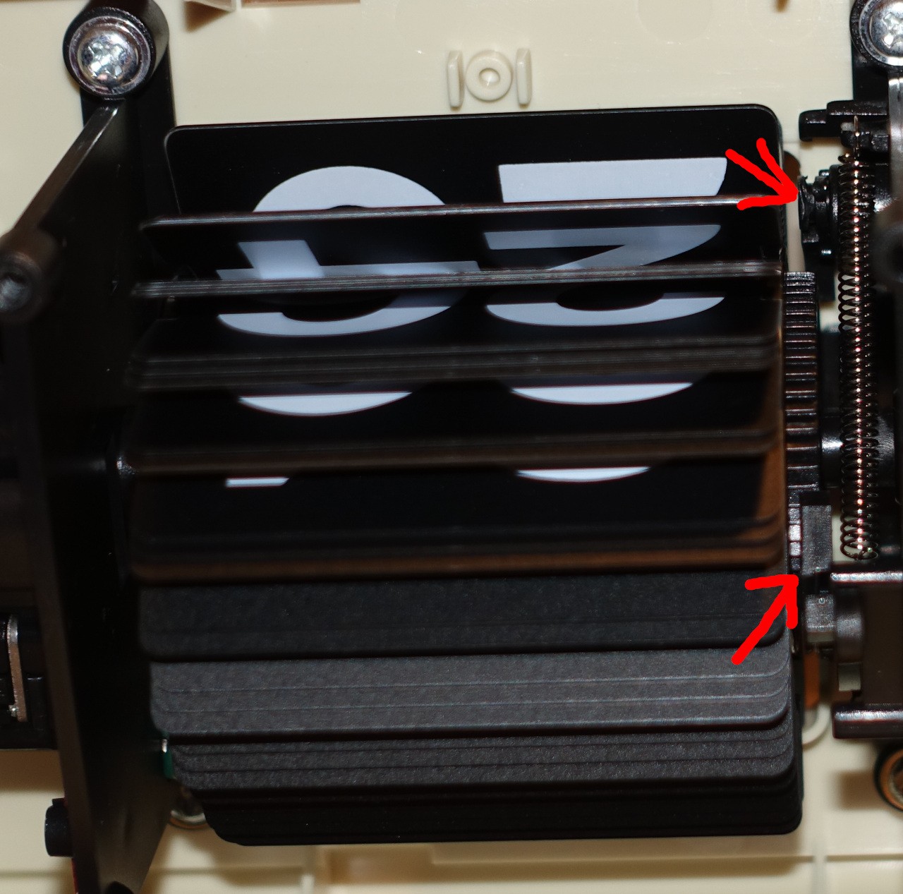

              Hi,
              I also have a QT30 that "creaks", and it was like that since it was new - I think it's the normal sound of this mechanism, and I think I can explain it. Here's the picture of my Twemco with the back off:
              I believe the sound it makes between minutes is almost entirely due to these two plastic pieces sliding off the "teeth" on that wheel - as it rotates, this "catch" slides down the step, and once it slides into the next teeth, it does so quite fiercely as its on that long, quite strong spring (I think this is the louder creak from the video above, around 0:40 - sometimes that sound also has a bit of a "twang" to it, I would assume it's because the spring rapidly contracts?). The second catch makes a sound for the same reason, but it's a bit quieter (and I think that's the sound at 0:20 of the video). I would assume that sound at 0:52 is just the flaps internally falling, you can even see on the picture they tend to bunch up in groups of 3 and 4, so when such a group falls, it makes a similar sound to just the minute flipping normally - I don't actually get that sound often though, maybe it depends on the angle of your clock when it's standing.
              At least this is what I think it's happening, I'm not sure you can do much about it? Maybe putting some kind of grease on that spring would reduce the chance of the "twang" sound, I'm somewhat tempted to try that, but I don't know what can you really do about the catches hitting the spiky wheel. I think it's just how this clock mechanism operates.
