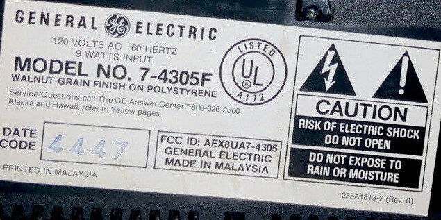

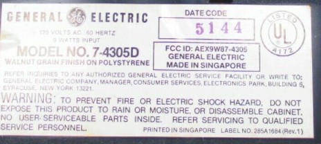

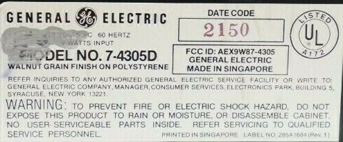

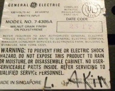

    The date codes on these clocks is a 4 digit code.
    Click image for larger version  Name:	81-3.jpg Views:	0 Size:	32.6 KB ID:	14047 Click image for larger version  Name:	81.jpg Views:	0 Size:	46.9 KB ID:	14048 Click image for larger version  Name:	78.jpg Views:	0 Size:	48.4 KB ID:	14049 Click image for larger version  Name:	84-5.jpg Views:	0 Size:	83.5 KB ID:	14050 Click image for larger version  Name:	84-5.jpg Views:	0 Size:	83.5 KB ID:	14052 Click image for larger version  Name:	image_3767.jpg Views:	3 Size:	23.7 KB ID:	14051
    It seems that the second digit corresponds to the year. They must have started in late 1970s. The third picture shows an 8 so that would be 1978 and the 6th image would be 1979. The others are from 1981 to 1984. These match up to what I would expect as the models move towards the A to the D and F versions.
    The first digit is the day of the week. You'll only see from a 1-6 here designating Mon-Friday (I guess no Sundays?). The last 2 digits are the week of the year. You'll never see higher than 54 here.
