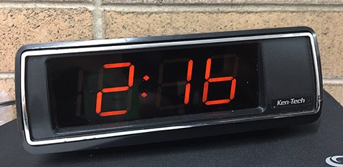

    Was gifted one of these recently. Another interesting mechanical clock that hides as a larger LED display. Each
    digit segment is it's own neon bulb, a synchronous motor drives a cylinder that touches contacts that turn on and off each segment. No am/pm indicator. So far mine has all the bulbs working and is keeping time. Has anyone seen this particular mechanism in other clocks?
    This video on youtube shows what it looks like on the inside:
    Very interesting clock, ahead of it's time?

      Lumitime copy? The Lumitime clocks work in the exact same way I recently discovered when I got my hands on a broken one which I needed to open up anyway....
        • 3604
        That's an interesting clock. I keep finding myself getting into these "other-than-flip-clock" digital clocks. It's intriguing how they came up with ways to digitally display the time. What cracks me up is that in advertisements of many early digital clocks, they refer to them as "space-age" or "Computer Age" clocks in spite of there being absolutely no computing at all! Just electromechanical geewizery. Thanks for posting this RetroFlip

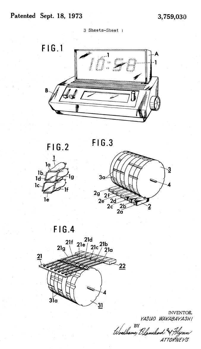

              Performa I opened up the 507 to read the markings on the clock,
              kendale technology corp
              NO-0-JEWELS
              PATENTS 10
              3759030
              KTC-125 JAPAN
              in red ink: 36090719
              I turned up this patent:
              https://patents.google.com/patent/US...orp)+(3759030)
              Click image for larger version  Name:	patent3-759-030.jpg Views:	0 Size:	117.7 KB ID:	17222
              Searching 'digital clock' in the time period we are talking about seems to produce quite patents relating to the subject.
