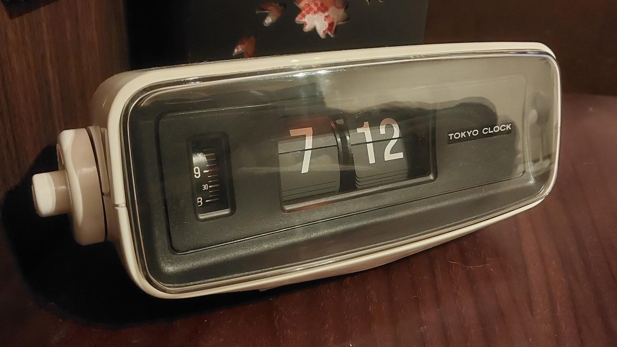

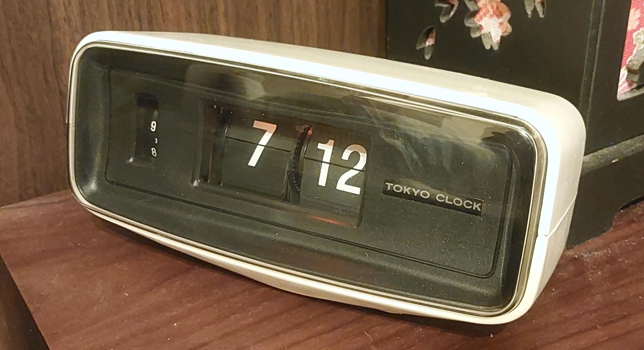

    First some bedside table pics

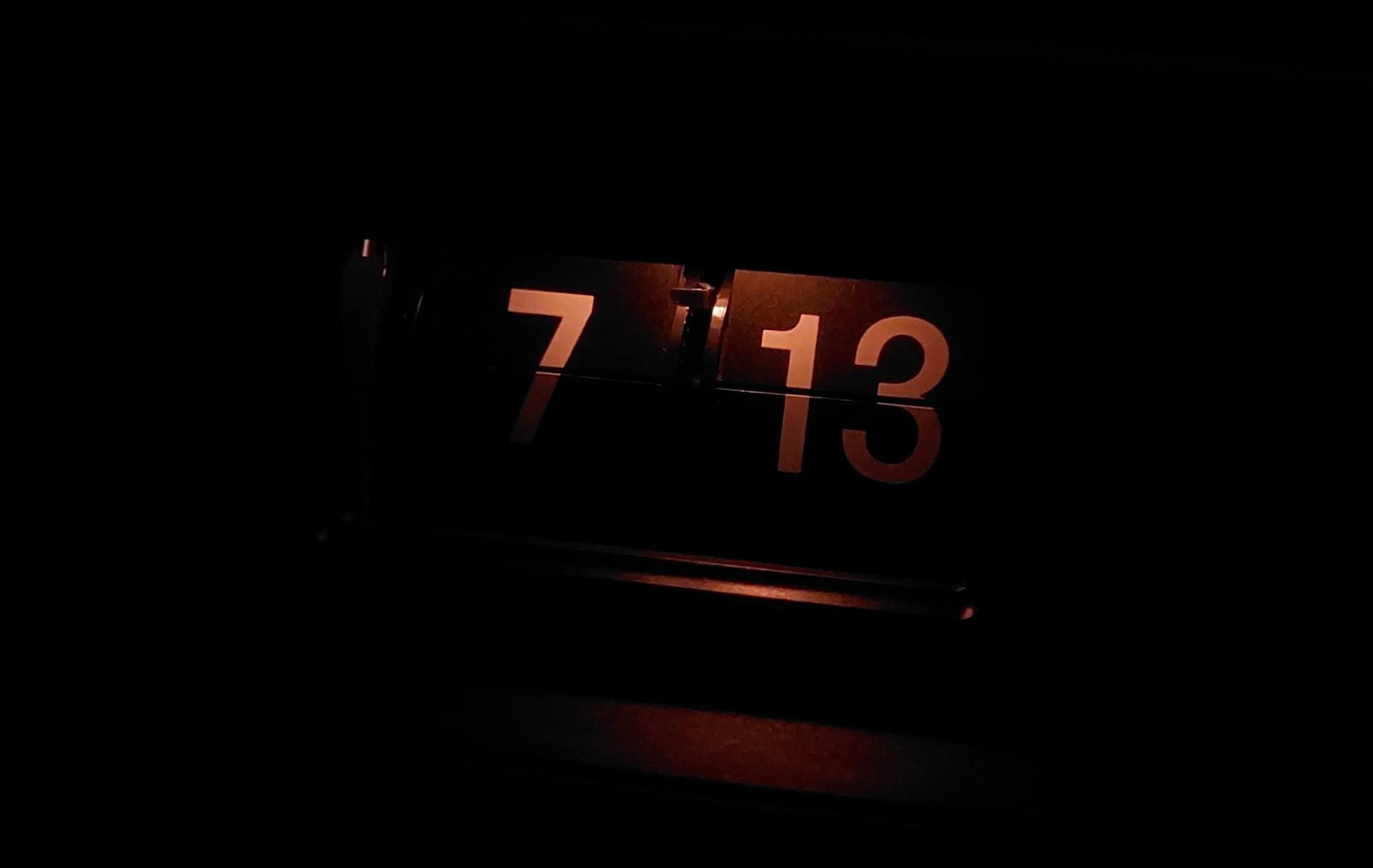

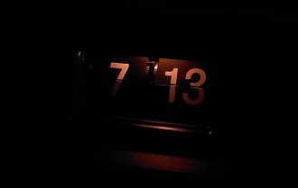

    Mmmh, orange glow!

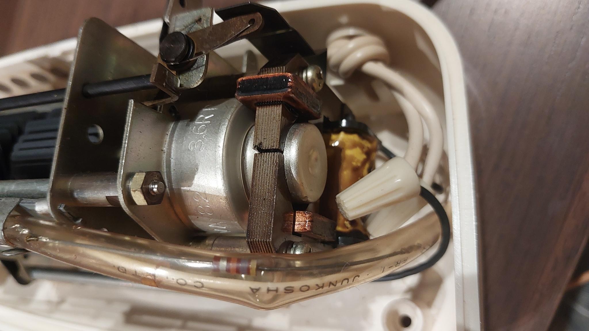

    Let's have a look inside. These are some long and curved fingers ...ah what do you call these again?

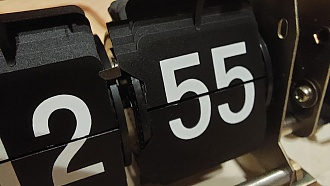

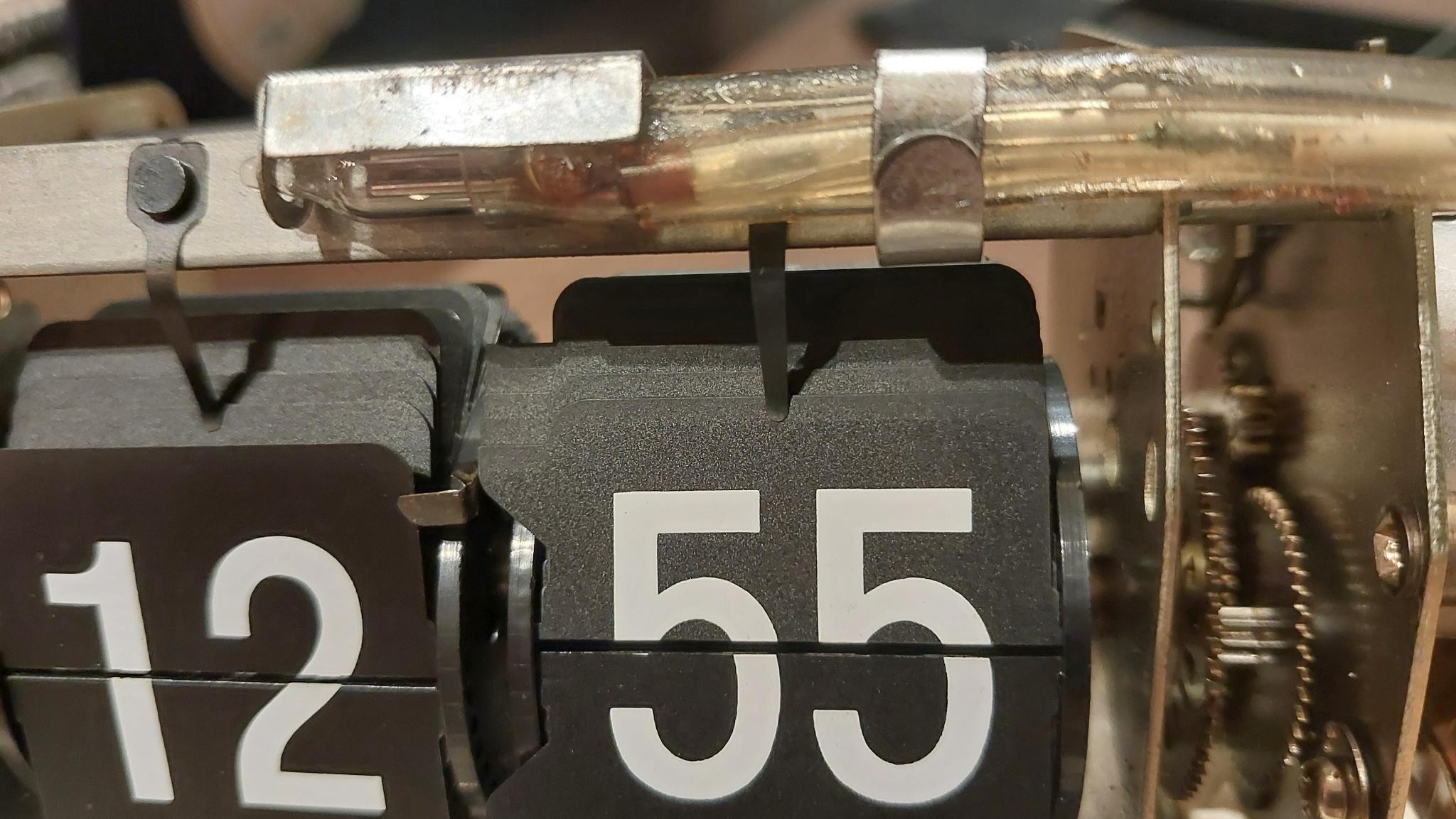

    anyway, I noticed that the tab that holds the hour tile so it falls right with the 00 minute tile is only pushed by extensions of the minute tiles. In copal clocks there would be a ramp on the main axis as well to initiate the lateral movement of that tab.
    Here is a closer look at the 55 minute tile extension (probably not the right word) starting to push the tab towards the hour tile:

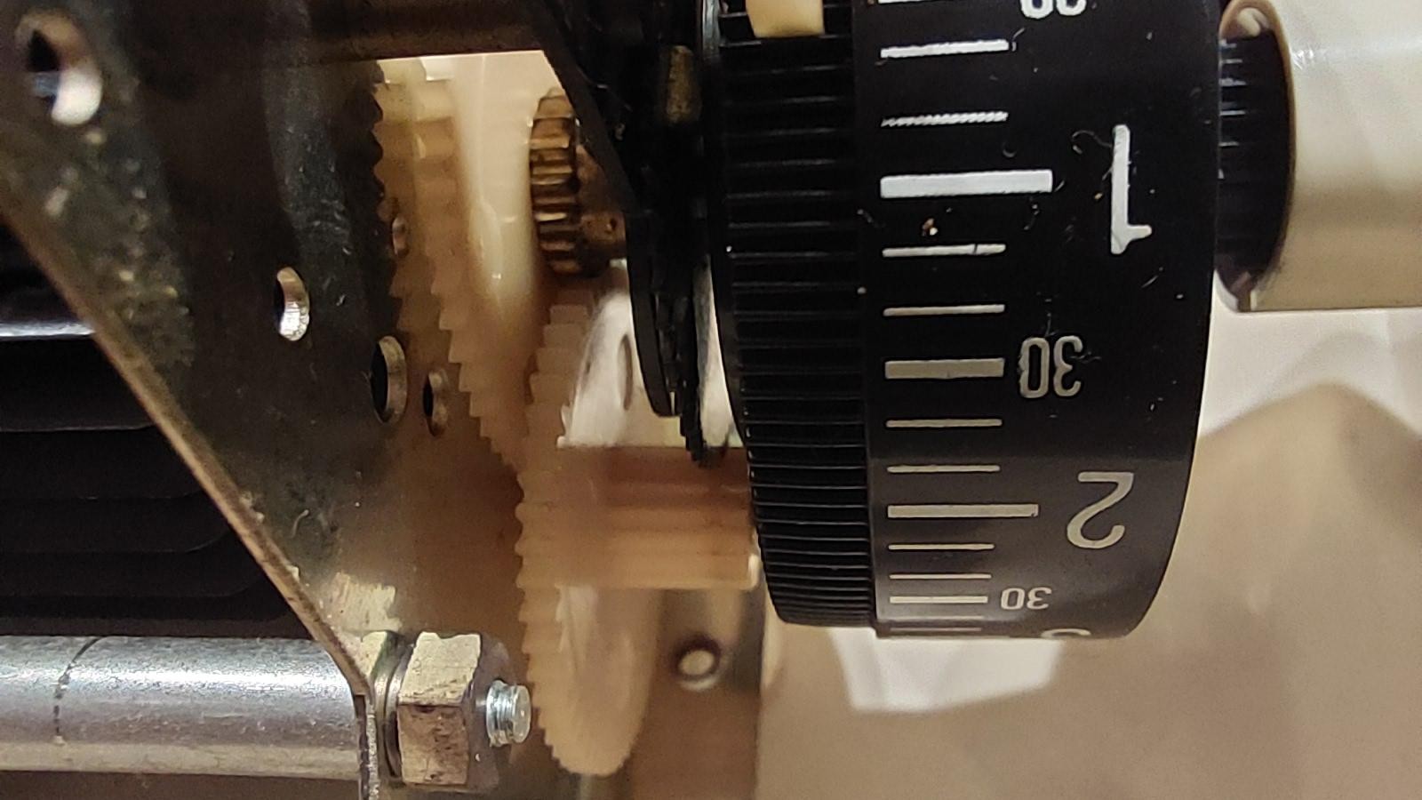

    here are some gear pics for you, setting knob side:

    and this is the motor, not a copal II obviously.

    I quite like the overall look of that clock, but I assumed it was 24h because it didn't have any am or pm markings on the tiles. Having the real thing in my hands I realized it is just a 12h clock and am or pm is determined by you looking outside the window to see if it's bright outside. It is for the Japanese market after all, so it was a mistake to think it would be 24h to begin with.
    I do not like so much that the tiles are quite tilted towards the back and the gap between the upper and lower part of the tile that that angle creates.
    Still quite happy with that clock, it. was the first time I saw that model.

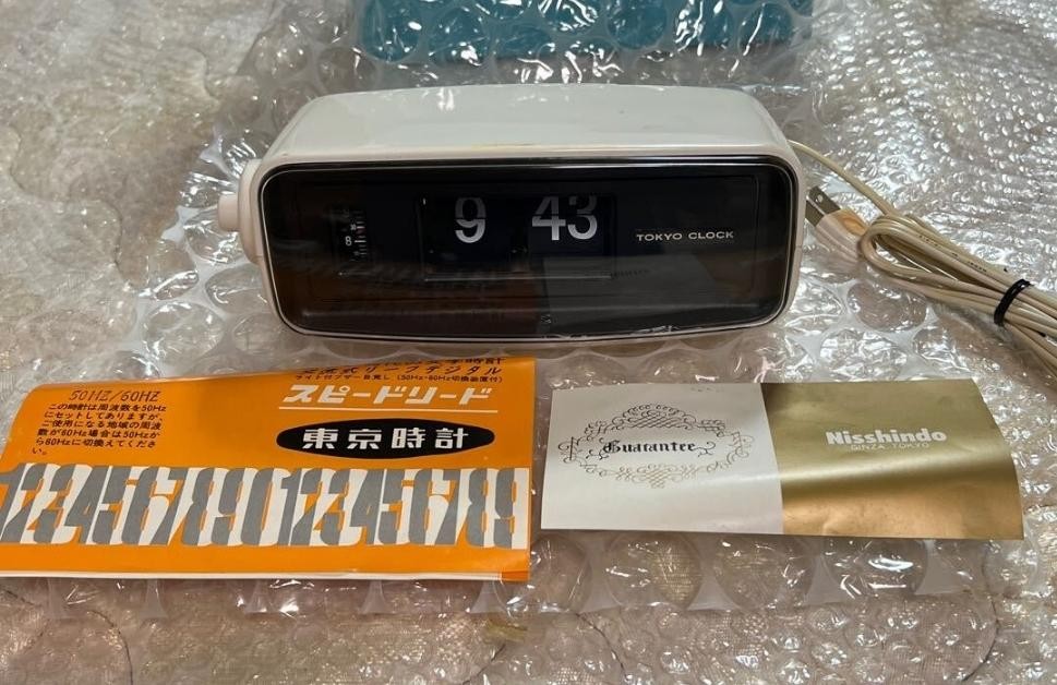

    Hey, it's me again.
    I just stumbled on an offer for one of these clocks. Apparently the model is called "speed read".
    Not sure about the year of the one I got, but the seller of the one below claims the guarantee card says 1974.
