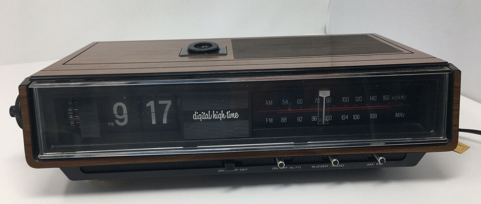

            I did not know they made a flip clock radio. model number 7652
            Click image for larger version  Name:	dhtime.jpg Views:	0 Size:	189.6 KB ID:	24181
            p.s. it's on ebay now.
              yes. I actually saw that in newspaper advertising but didn’t mention it because I couldn’t find an example. Thanks!
