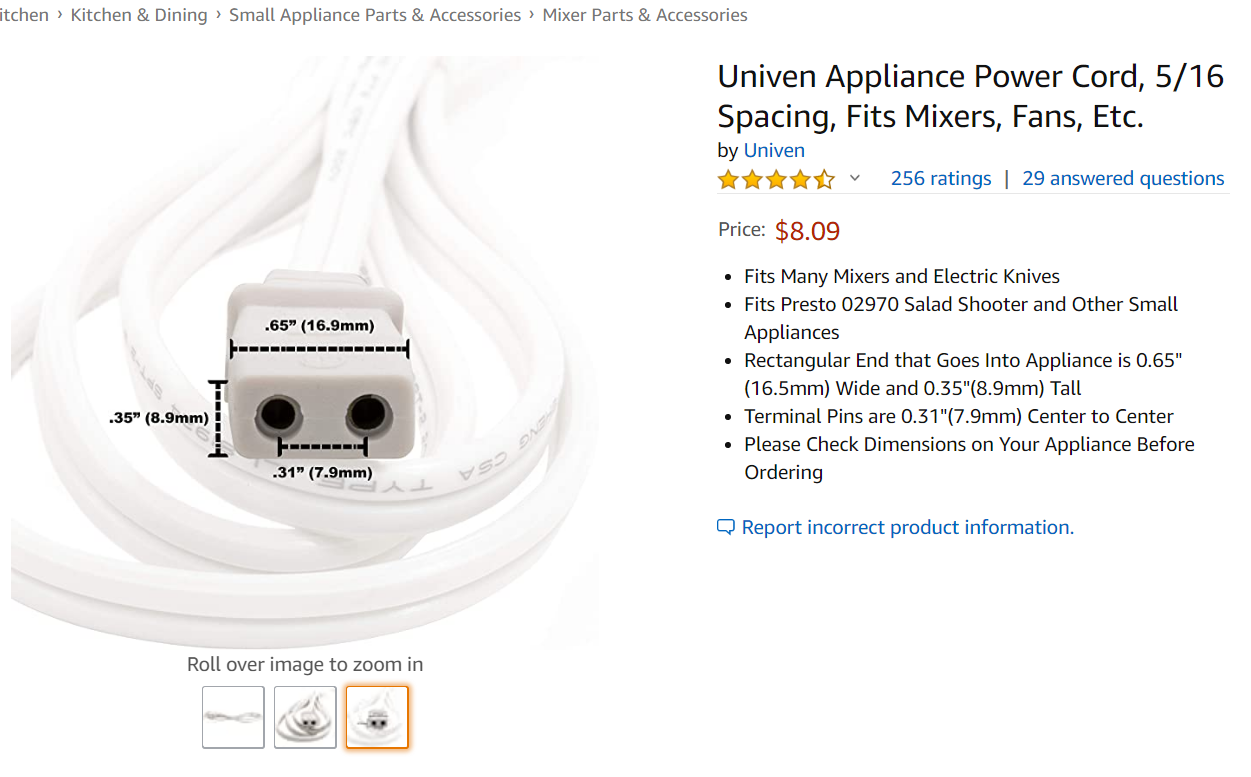

    The aperture on the back suggests a "figure 8" connector, but the fit was poor. When I measured the pin spacing, centre to centre, it's 7.90mm. The specification for figure 8, or more correctly, IEC C7, is 8.6mm. When I looked through my collection of assorted clock connectors, I found one that looked like it should fit, but the wider section shown in the picture prevents it from fitting into the recess.
    Does anyone have an example of the correct connector for this type of clock, please ?

    Welcome, nice to see more 240 volters and 50 Hertzers
    An appliance plug with 5/16" pin spacing should do the trick, this one was on Amazon.com
    https://www.amazon.com/Univen-Applia.../dp/B0002KWBJ6
    There should be something similar on Amazon.co.uk or ebay.co.uk

      David, thank you. I simply didn't know these existed, it's a size we don't really see in the UK. I shall fire up my Amazon Prime account ;-)
