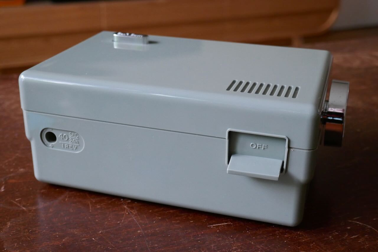

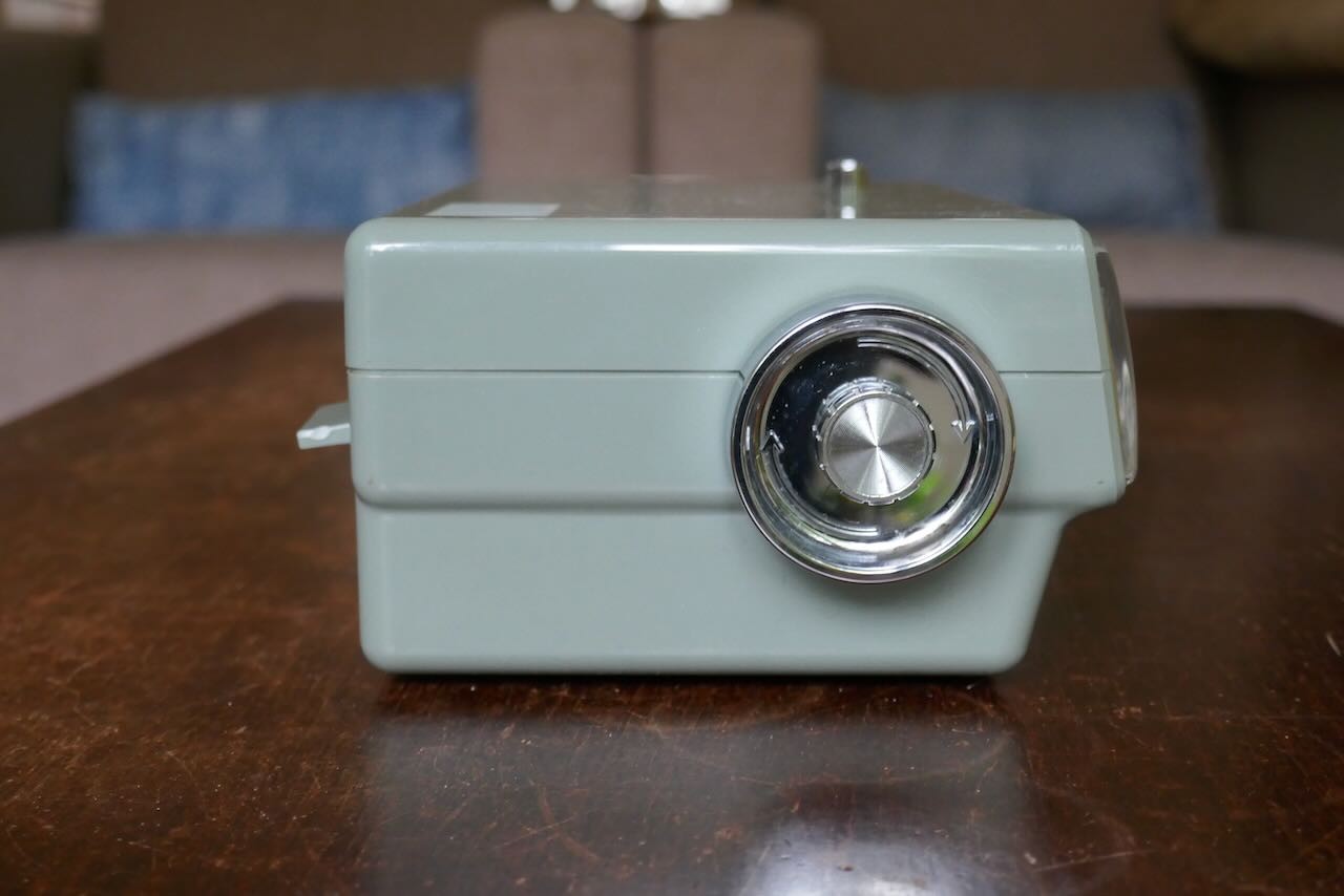

    Latest addition to my collection of Sankyo clocks, a nice olive green Sankyo 515:

    It is a battery driven, powered by one D type battery. It has a what I call "self winding clock movement" where a small DC motor each minute winds the spring for a traditional escapement clock mechanism. That mechanism is hidden in the box on the right in the photo. I did not want to open it since it was working fine and had never been opened (screws still had their original seal). I expect it will be the same mechanism as in my Sankyo 535L.
    It has a 24 hour alarm while the clock itself shows 12 hours and has an am/pm indicator next to the hours.
    The numbers are lit by a incandescent bulb inside the drums when you press the "nite lite" button.

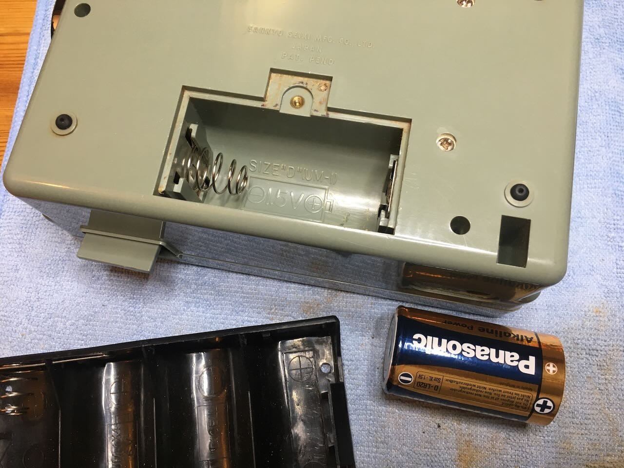

    When I bought it was not working, but that was a relatively easy fix. One battery contact was broken, probably after damage from a leaking battery, and the earlier fix attempt by a bended strip of metal did not hold up. I fixed it again by using the spring from a battery holder that I had lying around. Usually I try to stay close to the original, but this coil spring just works better than the original blade spring and it was an easy fix.
