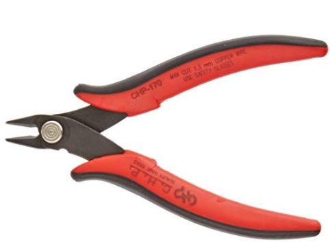

    2. Side cutters - for cutting wires. I like the smaller types, some that double as wire cutters as well as a cutter to cut back too much soldier. The one below is what I use.

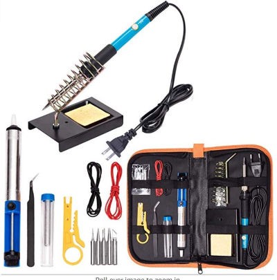

    3. A basic soldiering iron kit with adjustable heat - you don't have to get fancy. There's some good decent starter kits out there.

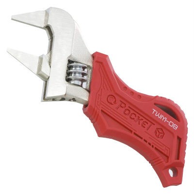

    4. Thin Jaw adjustable wrench - you will thank me for this one. I love mine. I got it off amazon on a special. It's a little expensive now, but I use the heck out of this.

    Click image for larger version  Name:	microcutters.JPG Views:	0 Size:	17.6 KB ID:	9136 2. Micro Cutters Get it on Amazon.com
    Click image for larger version  Name:	kit.JPG Views:	0 Size:	39.9 KB ID:	9138 3. Soldiering Iron kit - just an example from Amazon.com
    Click image for larger version  Name:	slimjaw.jpg Views:	0 Size:	19.3 KB ID:	9137 4. Engineer TWM-08 Pocket Sized Thin Jaw Adjustable Angle Wrench - get it on Amazon.com
