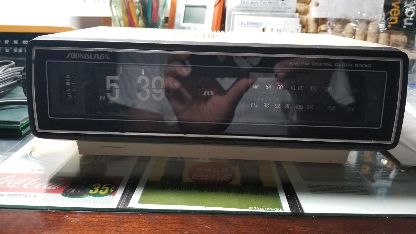

    So my Sound Design came in the mail two days ago, tested the clock for a day and it works GREAT.
    However, I'm having trouble restringing the radio tuner as it only goes from left to right, but not right to left.
    Is there anything I can do before I go completely bonkers from many restring attempts?
    Also, the radio/alarm will always be on when switched to the wake up function. I've been told by the seller that it should be better used as a clock/radio only, which I don't terribly mind but... worth asking the experts eh?

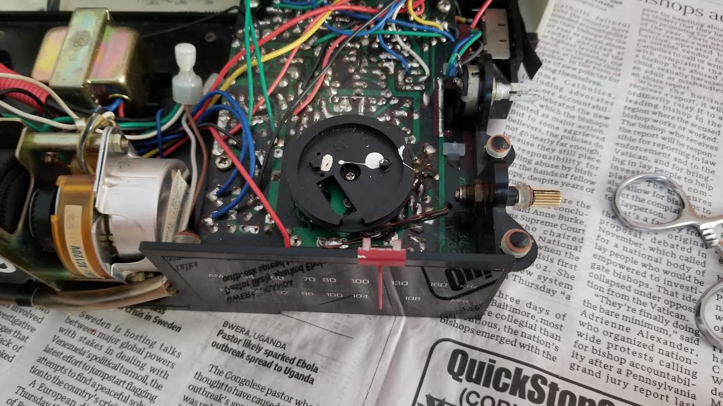

    *UPDATE*
    After watching Flipclockfans video on restringing the tuner on a Panasonic, I applied the similar techniques and FINALLY HAVE A WORKING RADIO TUNER.
    The original wax string was in pieces when I got it and the seller did try with his own string, but eventually gave up and left one end loose lol
    My solution: Curtain blind string.
    My dad saved old curtain blind string so borrowing some was no problem. Plus I had lots that left me a lot of room to mess up, although my sanity may not last that long.
    Anyways, although the string's a bit thicker than the original, the tuner can identify and track all stations of the spectrum!

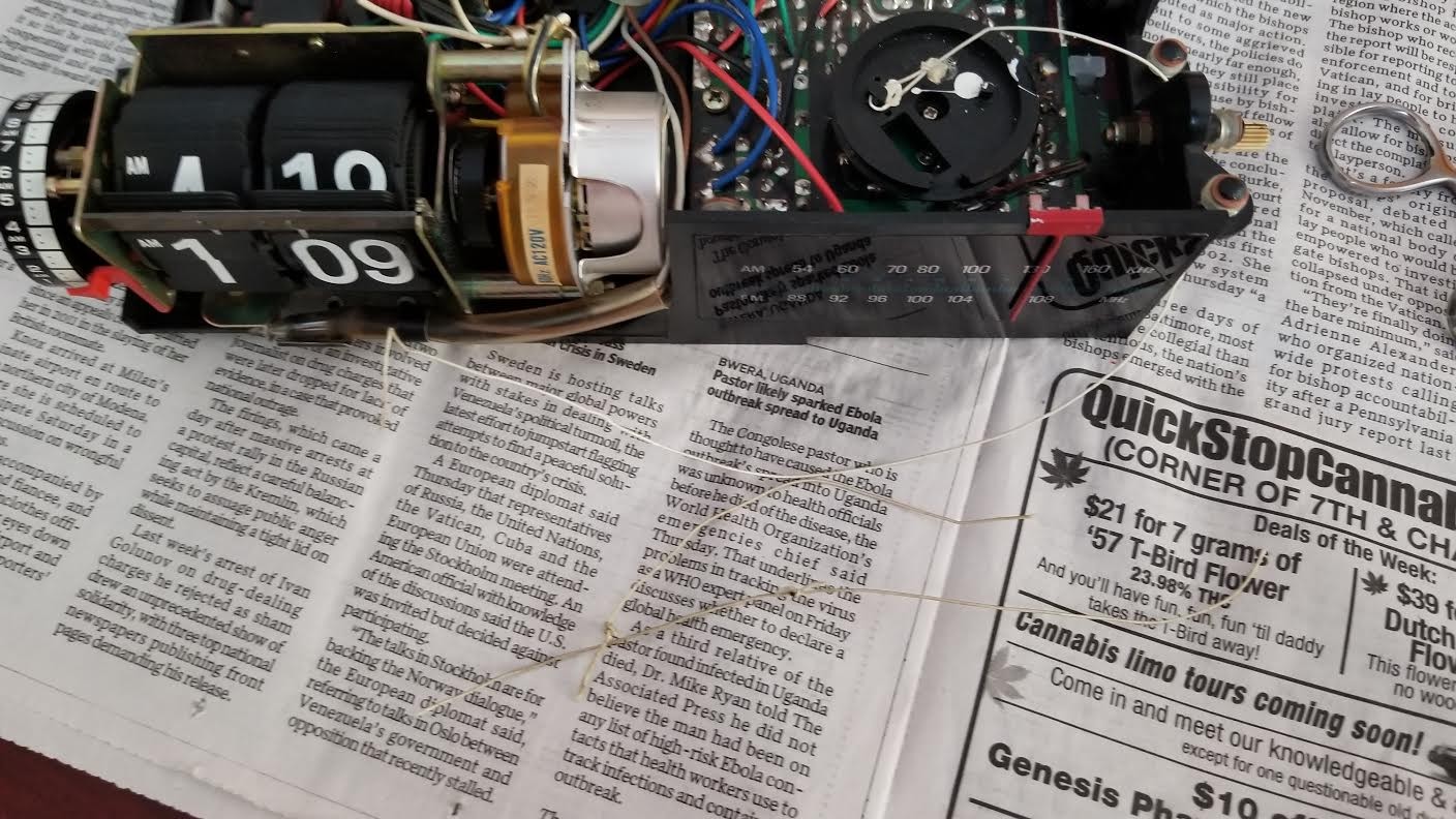

          Got some pictures of my first flip clock ^^
ID:	8894Click image for larger version
          Seems like the seller simply gave up on the tuner string.

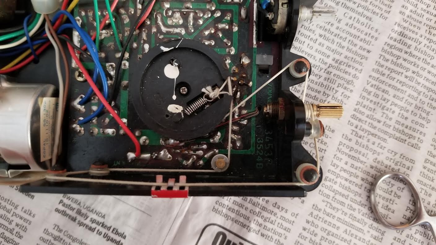

ID:	8895 Now she lookin' better!

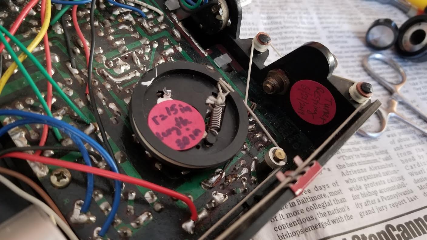

          Then I used curtain string and took a page from the flip clock master on Youtube... I'm guessing that's Mackey????
ID:	8897 Oh, and I had to leave a service sticker to pat myself on the back. Lemme tell you, that was no easy task. Took several hours of trial & error as well as surfing the web for help ^^
