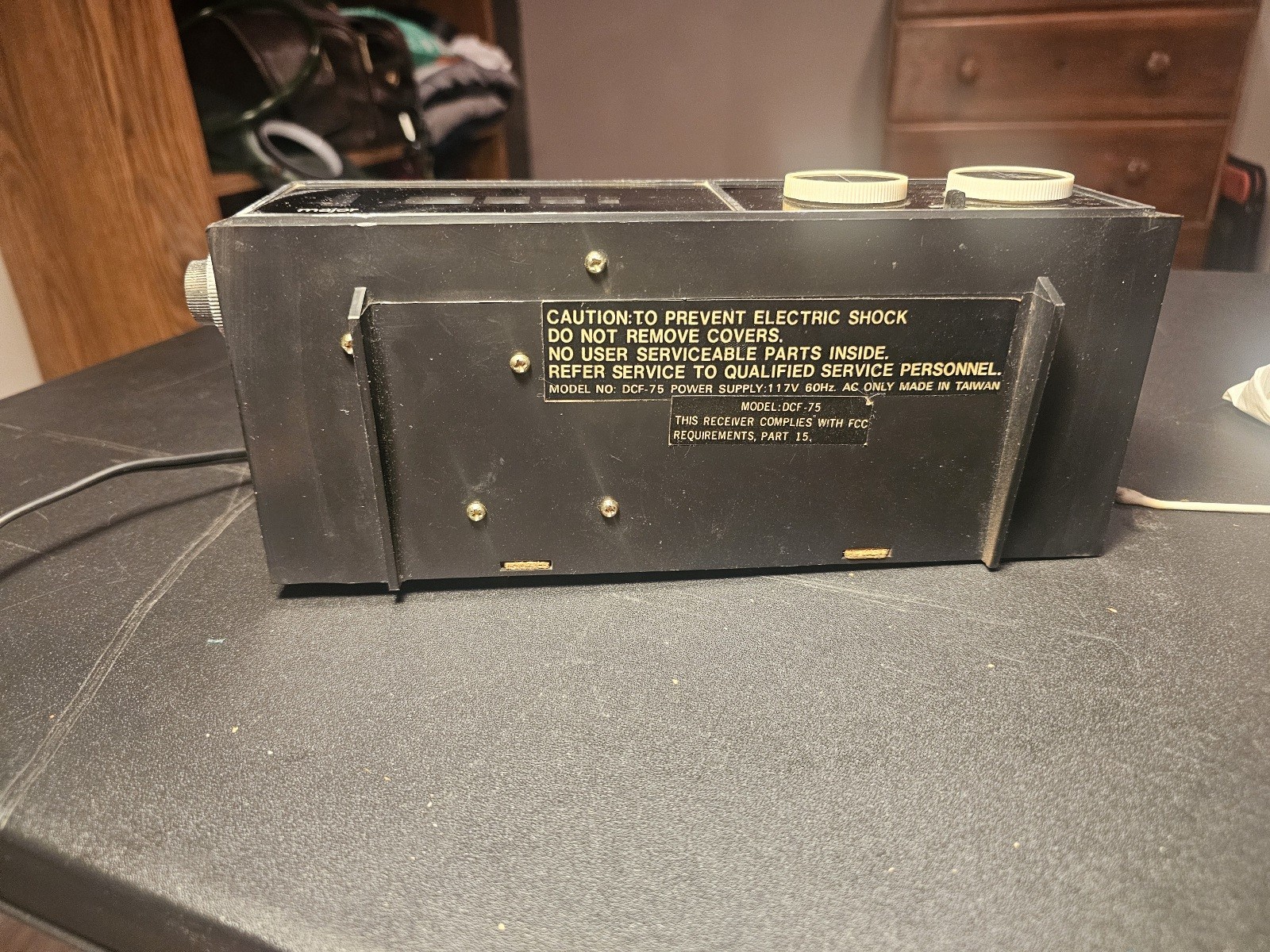

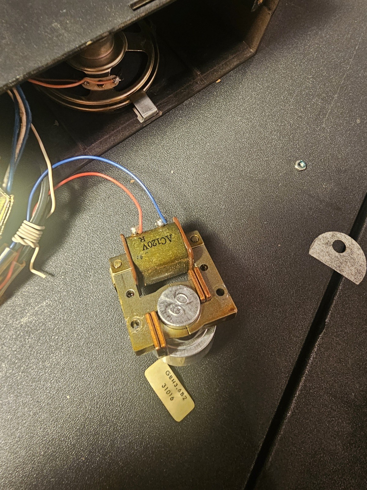

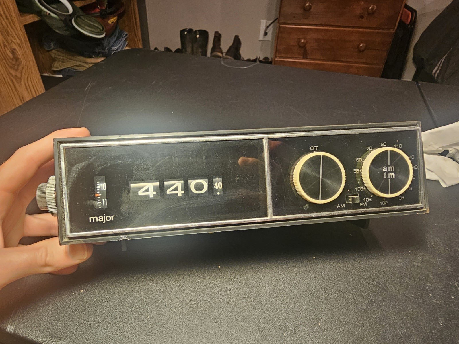

    Hi folks, I am new here, and new to the hobby, but have always been a tinker. After many years of fascination I have finally purchased my first flip... well a roller clock and it looks like it has mostly the same mechanical functions so I figured I would come here for help. I can not find this clock anywhere on the internet, and am having some motor problems. I have taken it apart and have freed up the motor of junk, but still dont get any rotation. It also appears the gearing is in good order. Is there any where that sells replacement parts or is this the part of the hobby that people dread? Any advise on what this clock is or where to replacement bits and bobs would be greatly appreciated.

    It looks to me like a Sankyo clockwork, that might help a bit. Can you figure out exactly what is going on? Is the motor getting power at all?
