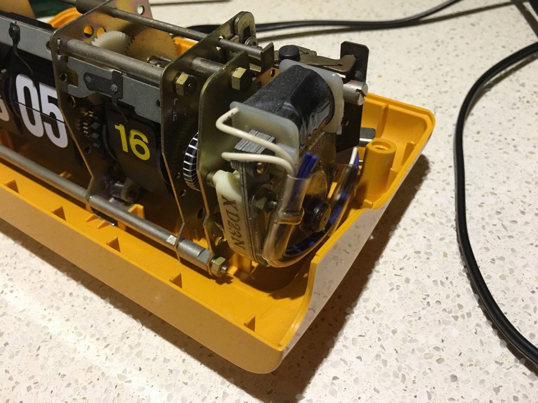

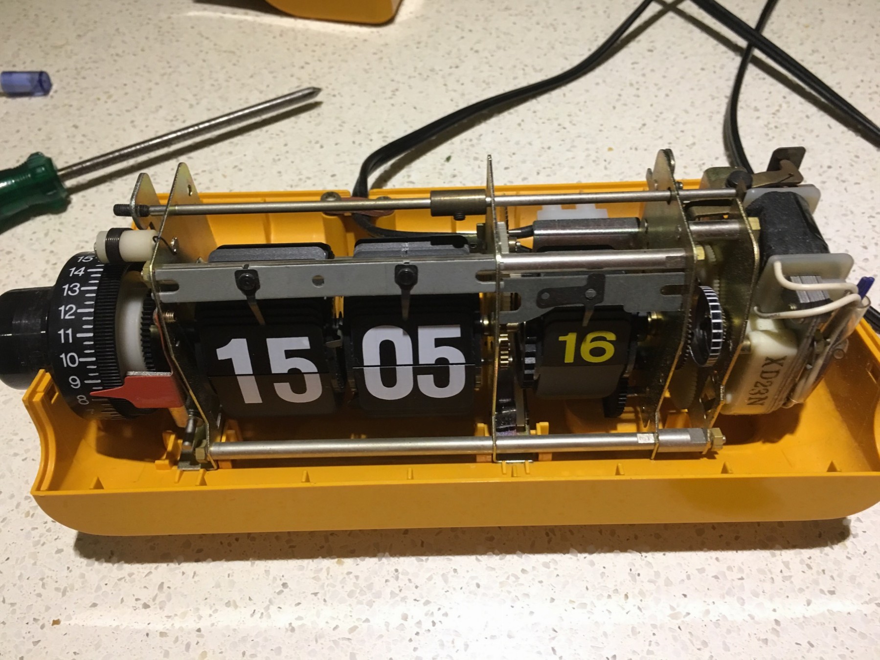

    I am new to this forum and have a question regarding a Krups flip clock I recently acquired. It has not night light but inside to the right are two blue wires leading off the mains supply at the rear. They are cut. Is it possible I could retro fit an orange bulb off these? It is 240V.
    Thanks
    Matthew

    Matthew, there's no reason you can't connect a ne-2 neon glow bulb to those wires. There are many for sale on eBay with the proper resistor already in place for 220 volts.
    I don't see a Place to hold the bulb. Your going to have to find a way to clip the bulb to the frame work.
    Do you mind letting us know in what country you live?
