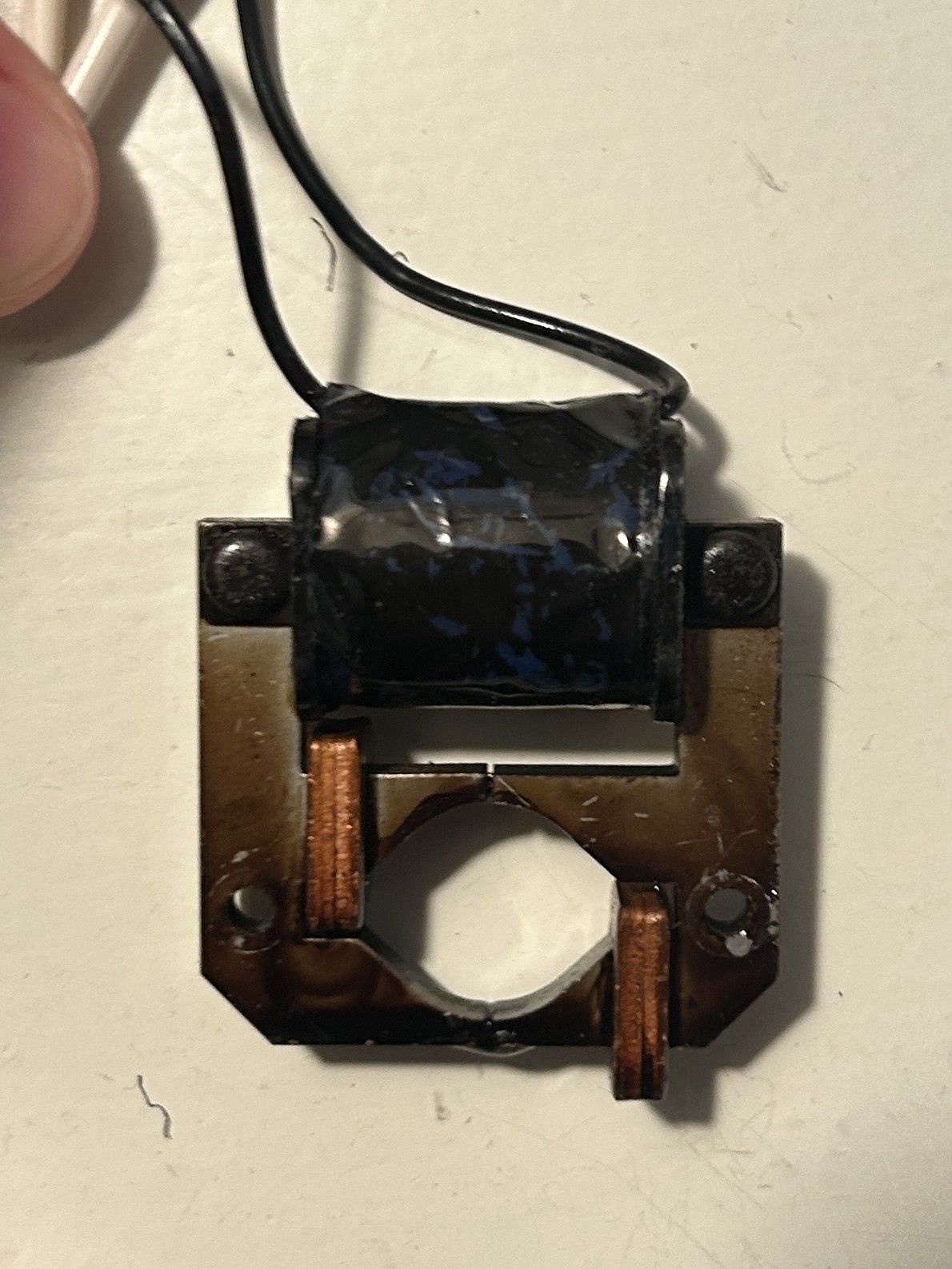

          I just got the Telechron motor in and it unfortunately has not solved my problem. First of all, it doesn't fit in the coil, which is unfortunate but could maybe be fixed. I was able to get it in a position where I could feel it vibrating though, and the outgoing gear didn't turn at all. Same as the original Toshiba. Assuming this new motor is working, I'm thinking the problem might be in the coil assembly, although I'm not sure what the issue could be or how it could be fixed. If this is the problem, the original motor could be fine after all. On the other hand, the coil does seem to be working fine. I held a screwdriver in the middle and I could feel the magnetic field strongly, and as I've said it makes both motors vibrate a little. Here's a picture if it helps!

          If nobody has any more ideas, I'll try opening up the Toshiba motor.

              I'm still curious about you attempt with the Telechron S motor: when you say "it doesn't fit in the coil", do you mean the diameter is too large? Or is the height of the canister not right?
              I can't think of anything that could be wrong with the coil assembly. Clearly the magnet is working as you can feel the force, so it should be able to get the rotor spinning. One thing that I forgot to mention is that is needed to center the rotor fairly well in the magnet and at more or less the right depth. If it is too far off the magnet exerts a lateral force on the little rotor in the coil and the friction that causes may prevent the rotor from spinning.
