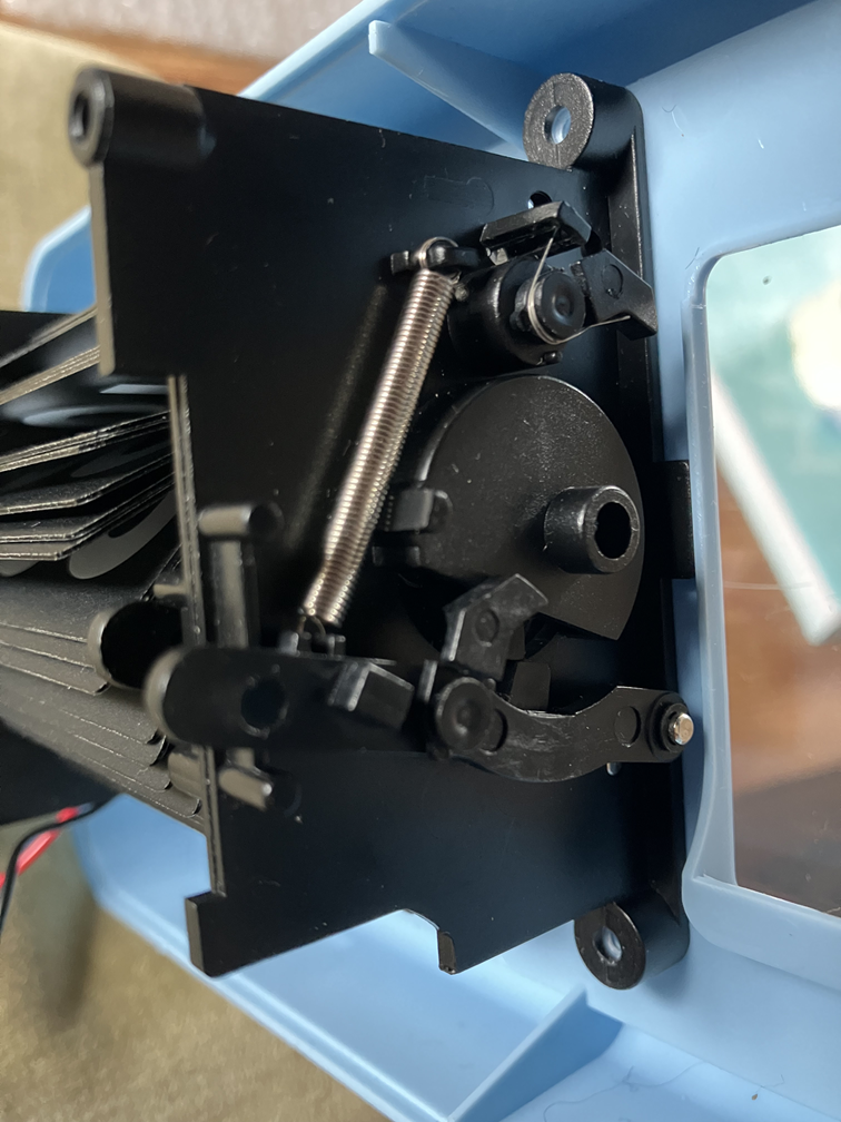

    After 15 years the movement mechanism in my Twemco QD-35 has recently stopped working.
    I can still hear it ticking but doesn't appear to be turning the cogs.
    I've tried opening it up to identify the problem but can't see any issue.

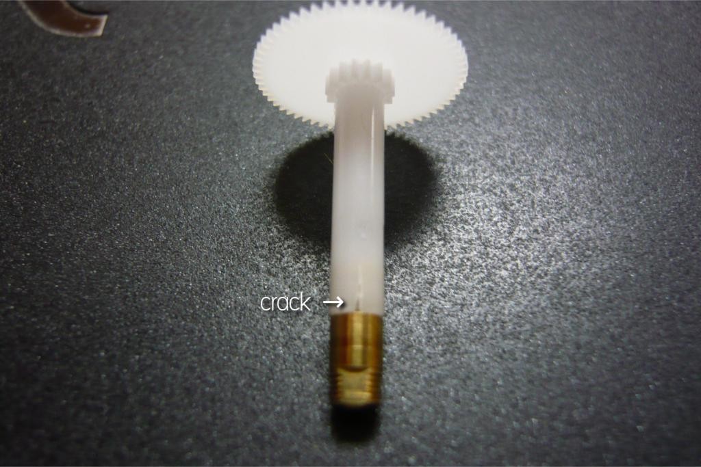

    I fixed serval QD-35 with the same problem. Firstly, I contacted with Twemco, then they replied the following information to me,
    "This issue is likely caused by the aging of the small gear that drives the minute hand. Please check if there are any small cracks at the base of the gear. You can refer to the attached image for reference."
    Click image for larger version  Name:	cracked_minute_gear_shaft.jpg Views:	0 Size:	133.8 KB ID:	30476
    For me, I tried 2 differen ways to fix it
    1. Disassemble the clock movement, remove the damaged parts, and use instant glue to reattach the metal part to the plastic part.
    (Disassembling the movement requires a soldering iron, solder, and a desoldering pump.)
    2. Contact Twemco HK to purchase a QD-35 movement for replacement. (E-mail: info@twemco.com​)

      [QUOTE=eathan21th;n30475]"This issue is likely caused by the aging of the small gear that drives the minute hand. Please check if there are any small cracks at the base of the gear. You can refer to the attached image for reference."
      Thank you EATHAN21TH,
      Just as you described, the minute hand gear has a small crack in it.... see image attached.
      Perhaps this is the issue?
      Although I have a feeling there more to the problem because the mechanism does not appear to be moving at all, even though I can hear it ticking?
      It's like the first "ticking" gear is being activated but not strong enough to tick over the other gears.
      Anyway, I'll try gluing the minute gear and see what happens.
      Many thanks for your advice, it's wonderful to have this community :-)

      • eathan21th
        eathan21th commented
        I believe this issue accounts for over 90% of the problem.

      I gave it my best shot and carefully glued the pieces back together and sealed the cack.....
      However it still wasn't ticking over after putting back together.
      Twemco has just replied to my email, so I'm going to order a replacement part at HKD$180. pretty reasonable if it gets me another 15~20 years.
      Wish I knew the reason why this old mechanism stopped working, I always like to repair things when I can... but I'm not a clock expert so I don't understand the finer details.
