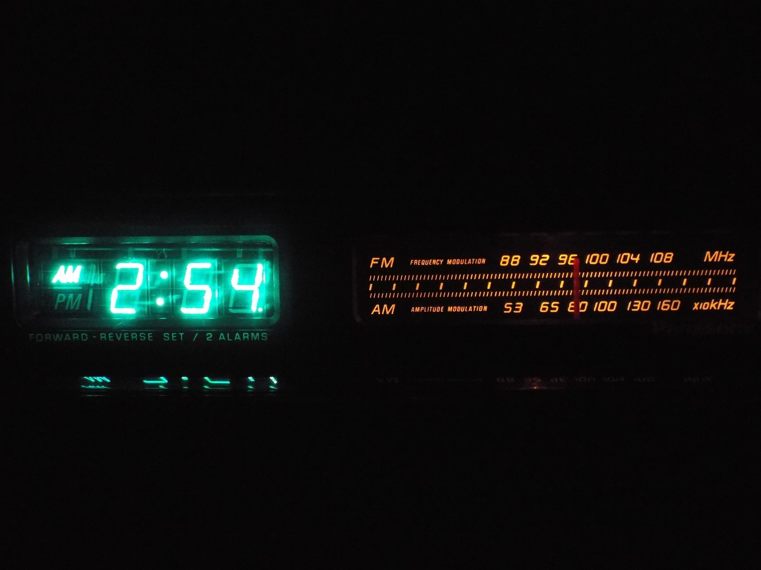

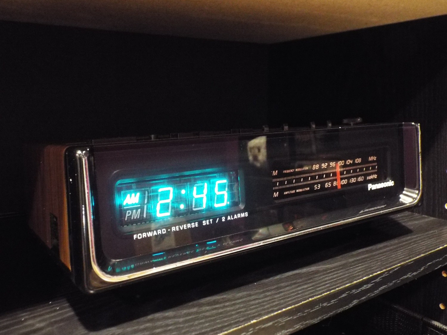

    I recently picked up a Panasonic RC-95 clock radio. I love old VFD clocks, and this one is really nice! While not a flip clock, the part I'm having trouble with is also used in the older clocks.
    I just finished restoring the clock, and everything works great. The switches were very dirty and making poor contact, so I cleaned them with contact cleaner. Now they function properly but some of them are very stiff to move. If I move them by only touching the side of the switch they are easier to move, but if I'm pressing down on them at all they are very stiff. I have some dielectric silicone lubricant with PTFE, so I put a small drop of that on the ball bearings on the side of each switch. That helped a little but they were still stiff, so I put a small amount on the switch contacts and worked the switches back and forth. They are more usable now, but still stiff. Is there any way to fix these switches, or are they just heavily worn?
