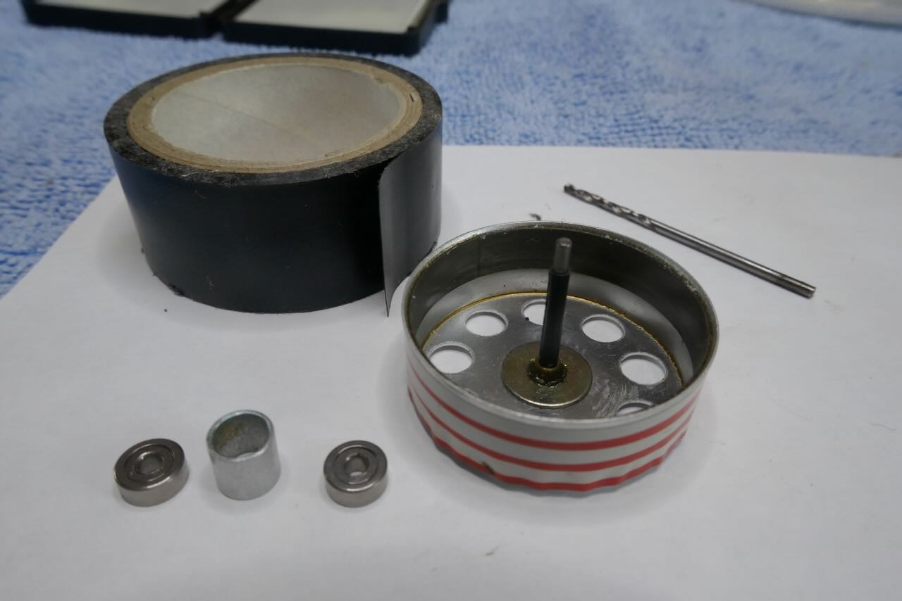

In my search for possible solutions I ran into these miniature ball bearings on AliExpress: https://www.aliexpress.com/item/1005...29771802I8kt7b
These are incredibly small and cheap. I had my doubts but nevertheless decided to give it a try.

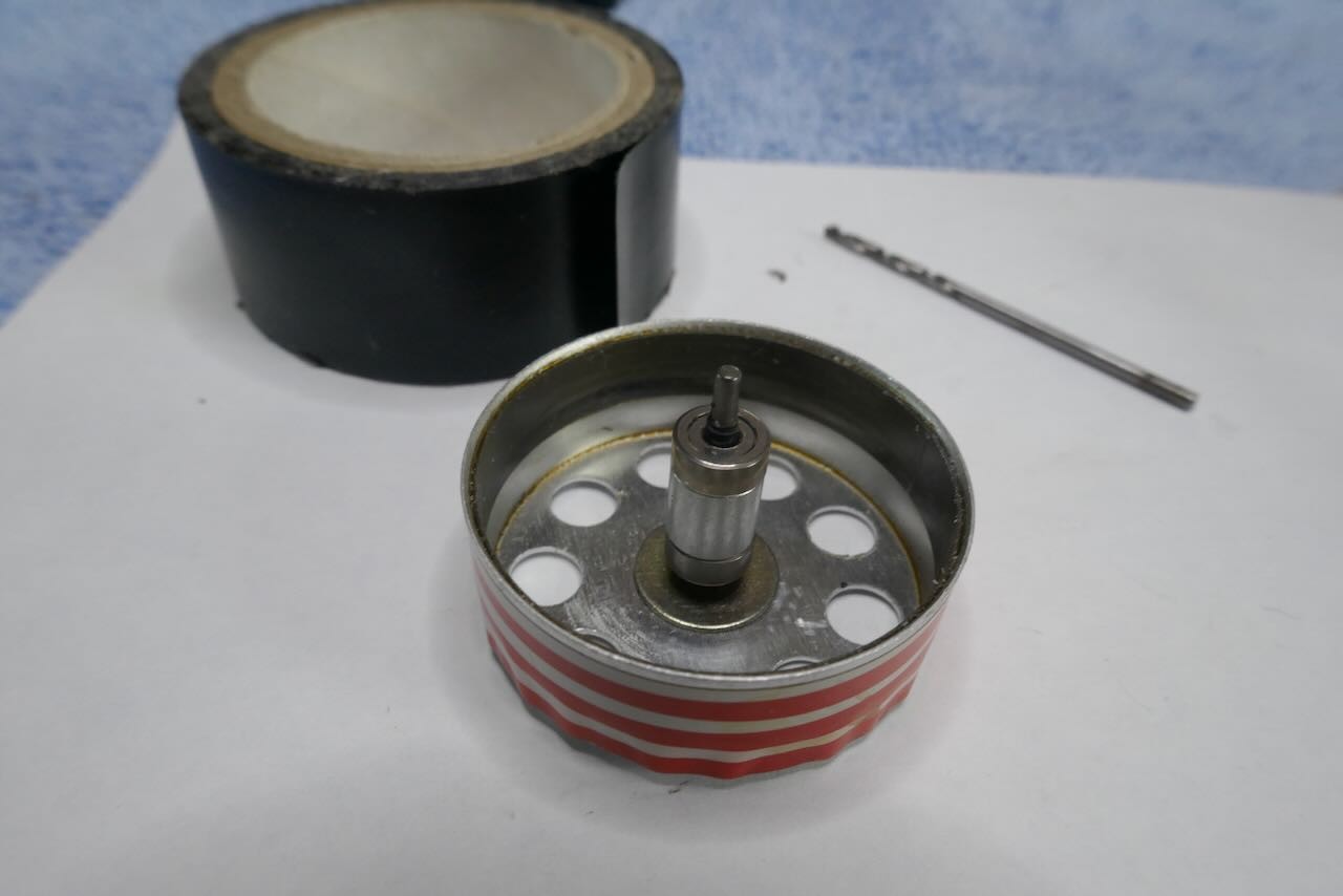

First I removed the rotor and the bushings like shown in this video by Mackey.

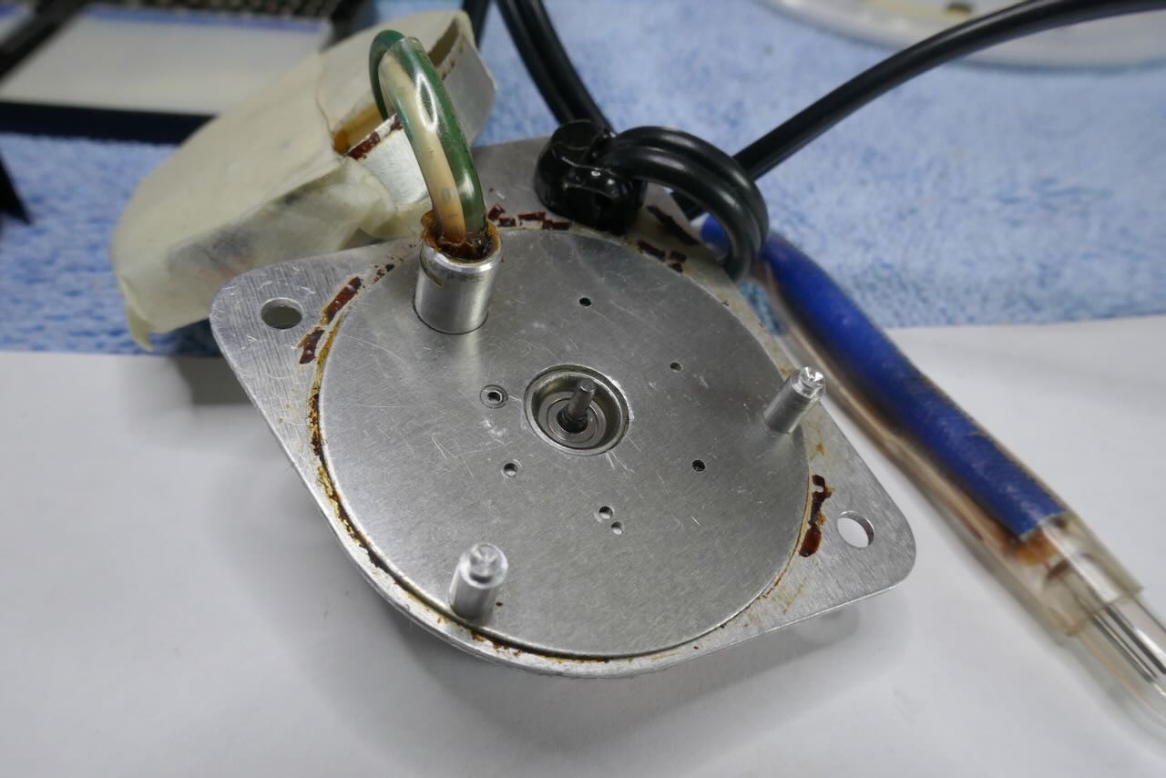

Replacement was then quite simple:
The outside diameter (6mm) of the replacement bearings fits perfectly.
The inner diameter (2mm) was just a little too wide for the axle (1.5mm). I made this fit by wrapping a little tape around the axle.
At first the result looked promising. The motor runs very smoothly and starts immediately. It also appeared to run quiet. That is until I mounted the motor in the clock and put the clock on a table. The case and the table amplify any vibration that is still there. It is as if you can hear the balls rolling, like a constant faint white noise. It is not as loud and certainly not as annoying as the irregular ticking that the motor exhibited before, but also not as quiet as I hoped for. I left the clock running for a few weeks to see how it developed over time. There was no change. It is still running fine, but just a little too loud to my taste.
