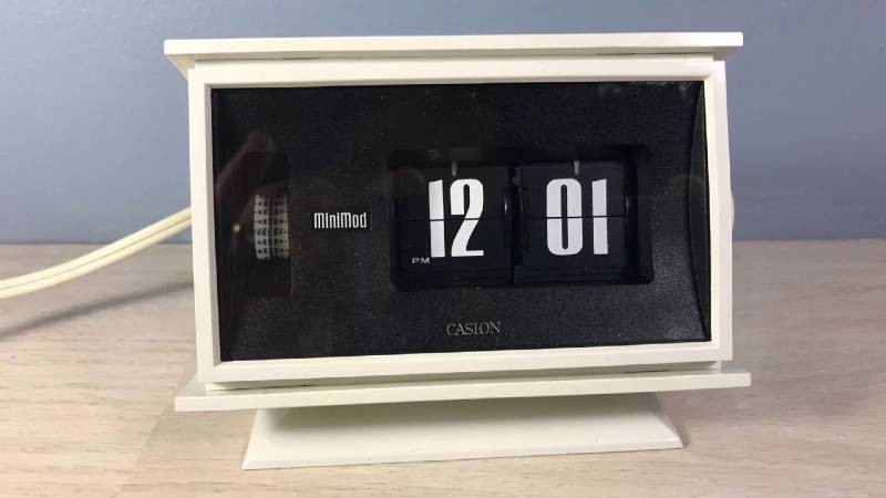

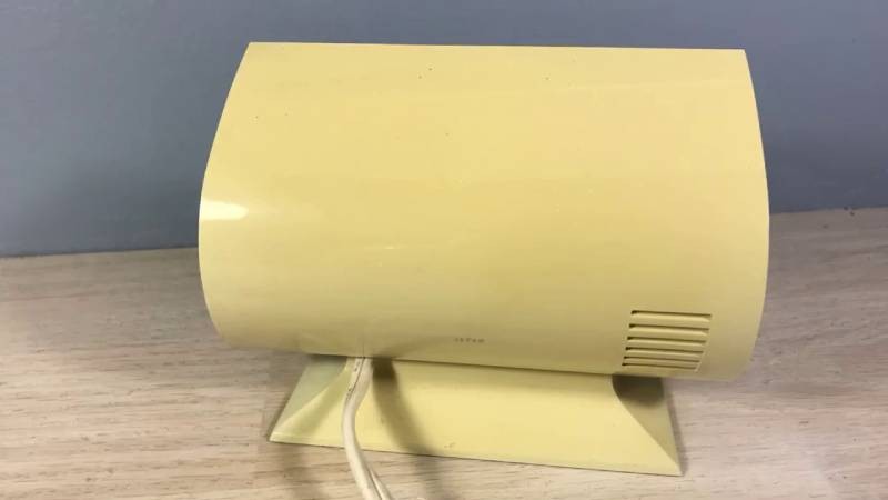

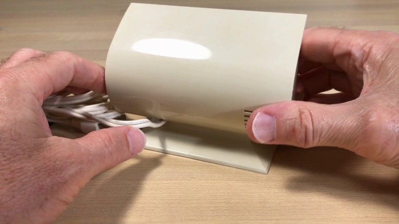

    In the comments of a video about whitening flip tiles, a visitor asked me to come back in a year to show if the clock had returned to yellow. I thought, I can do better ... I can come back in over 4 years and show you what happens. Well, not with the same clock.
    You see, I did a video about a Caslon Mini-Mod (December 25, 2017) where I showed how I whitened it. The images below are from that video.
ID:	24991 Click image for larger version
ID:	24992 Click image for larger version
ID:	24989 Click image for larger version

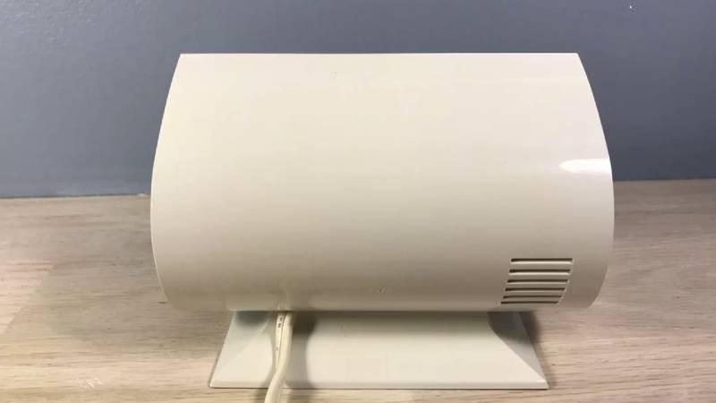

    And now, what does the clock look like?
ID:	24993 Click image for larger version
ID:	24994 Click image for larger version

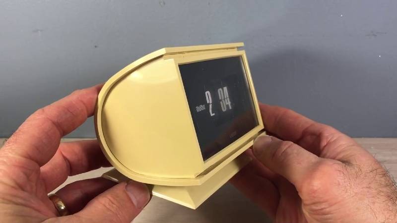

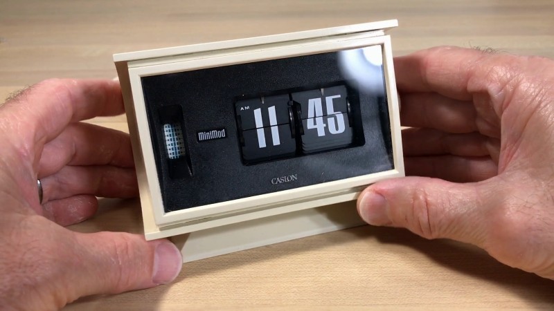

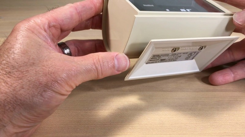

    Well, .... There has been some notable discoloration. But it's not yet yellowed. It was on display for about 3 years but of course not in direct sunlight. So, was it worth it?
    Absolutely! Even in it's current state it's whitened better than it was.
    Of course the question is whether this is weakening the plastic. That's way beyond the scope of what I'm doing here, but I doubt it.
    So I re-whitened the clock. You may find the very short video below interesting.
