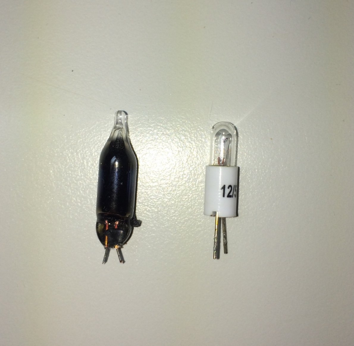

    1. The Bulb
    It doesn't work, so i tried to replace it. In the picture you can see the old one on the left (wich surprisingly still works barely) and the new one (12V, 50mA) on the right. Sadly the new one didn't work so I measured the electricity on the cables. Strangely my measurement device showed me 218V and almost no Ampere at all (1mA). My clock is the european version and it runs on 220V. What kind of bulb do I need or do I have the right one and it just doesn't work?

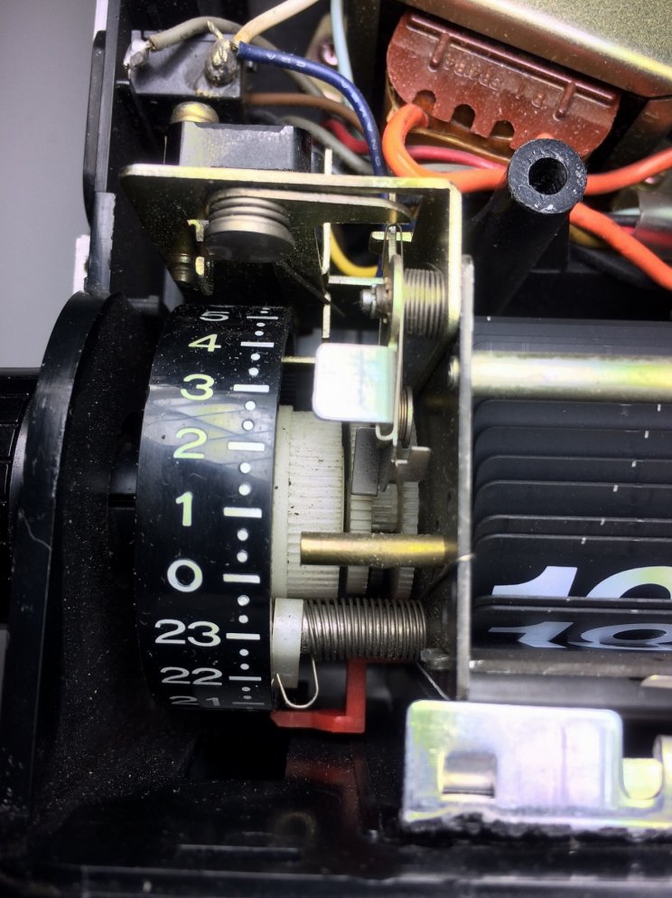

    2. The alarm
    It starts at the wrong time and sometimes I can't even adjust it properly. I saw the flip clock fans video on YouTube about this clock, so maybe someone of you already owns this clock and can post a picture of the alarm mechanism. This would help me a lot.

    Some of these questions are hard or impossible to answer without seeing the clock in person.
    Firstly, you need a NE-2 bulb (aka "lamp") that is rated for 220V and has a proper resistor. You'll have to look around, there are some on ebay
    see listing
    I don't think the above is exactly what you're looking for, but it's a start.
    The alarm... again, no way to help you without seeing this in person unfortunately.

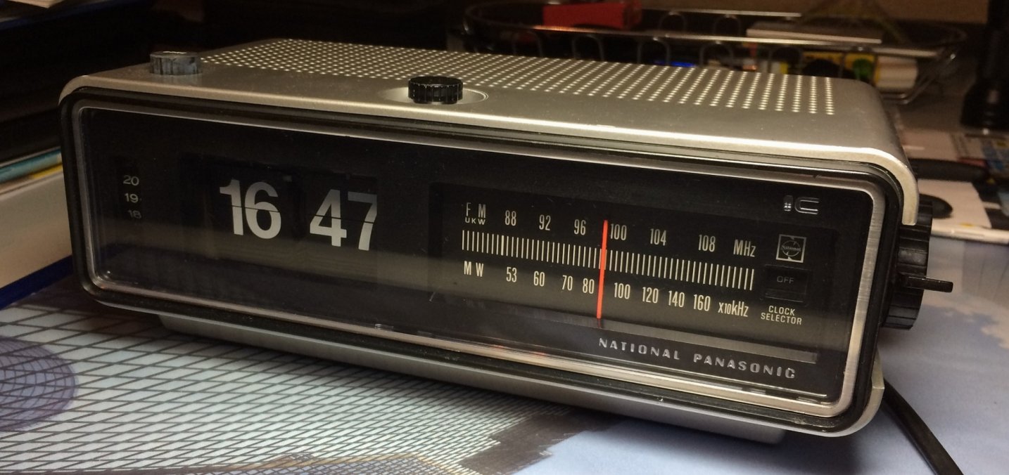

      Thank You! I managed to find a bulb that matched your description and repaired my clock. I have given up on the alarm though, because I am not going to use it anyway. The motor was a lot of work but I got it opened, cleaned and back together. It's very quiet now. There is a picture below (The light isn't as bright as it seems).
