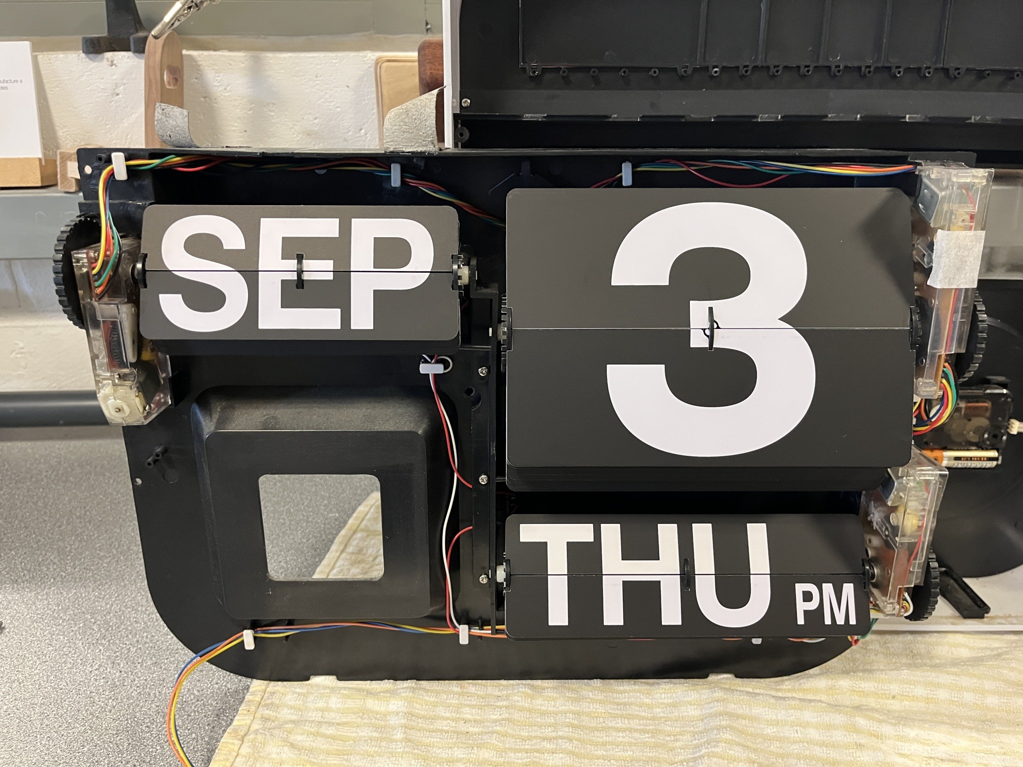

            Having the exact same issue having bought one second hand. Managed to repair it + clean the contacts and get the date and month working by rotating the AM/PM roller. But when the clock strikes 12pm it doesn't change AM/PM and in turn the rest.
