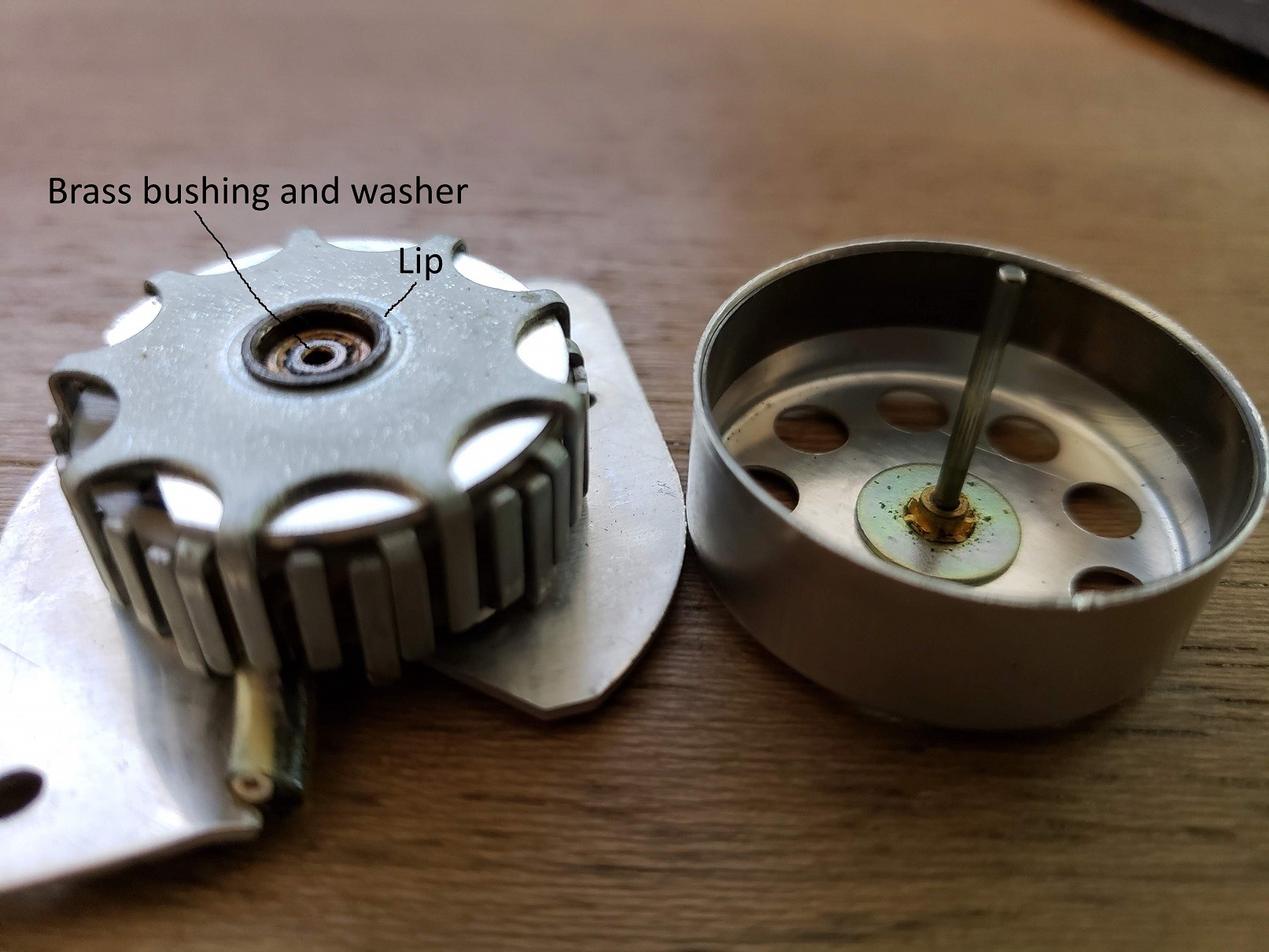

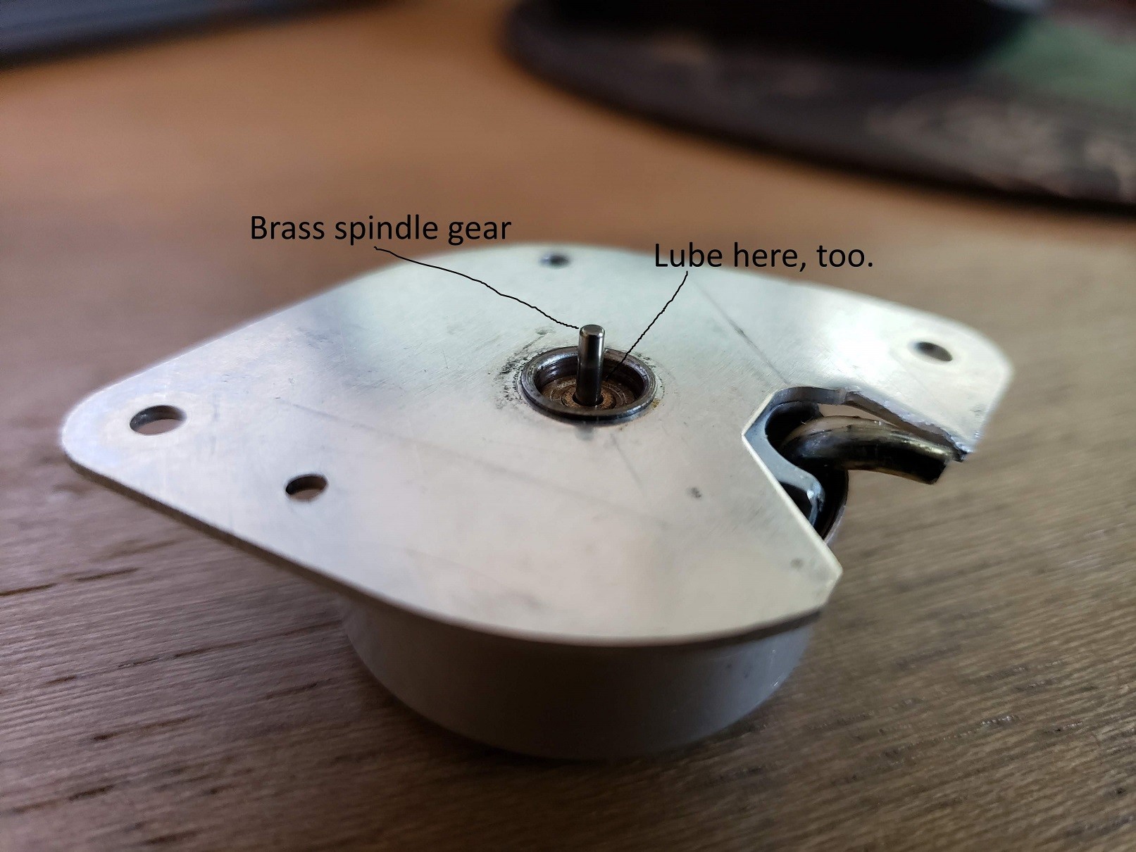

                    If the motor is stopping after oiling...then you did not oil it properly. It should move freely with very little effort.
                    Where exactly did you add oil? See attached pics for oiling points. No, you do not need to disassemble the motor as shown in the pics.
ID:	20941 Click image for larger version
