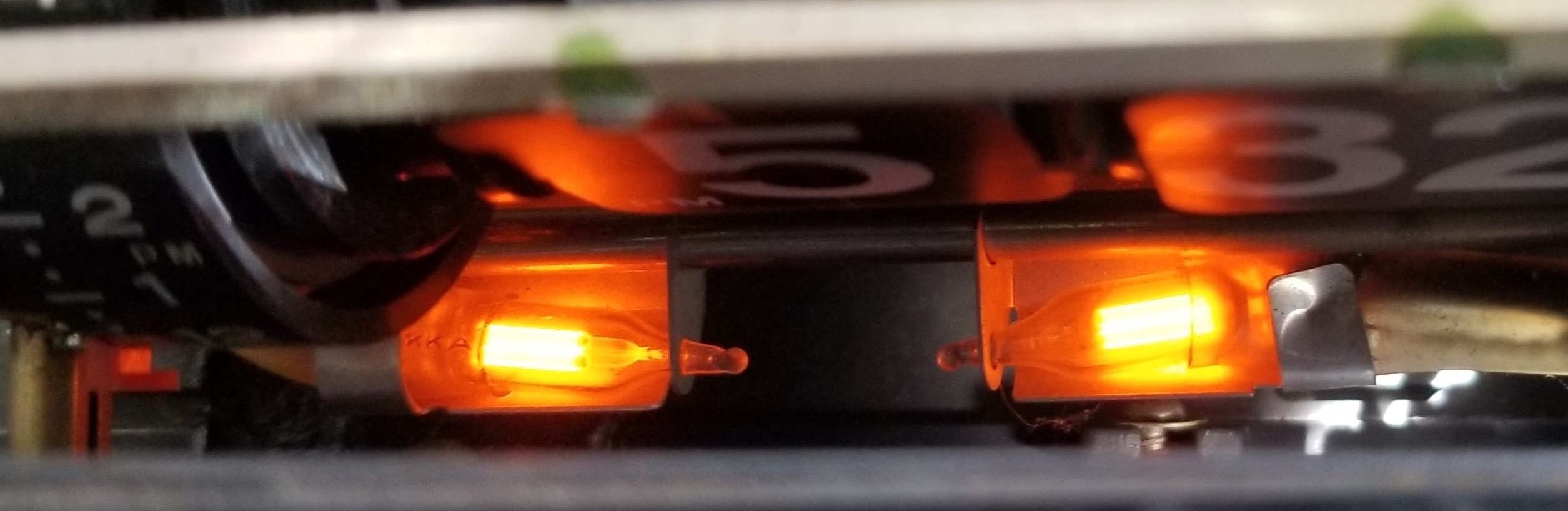

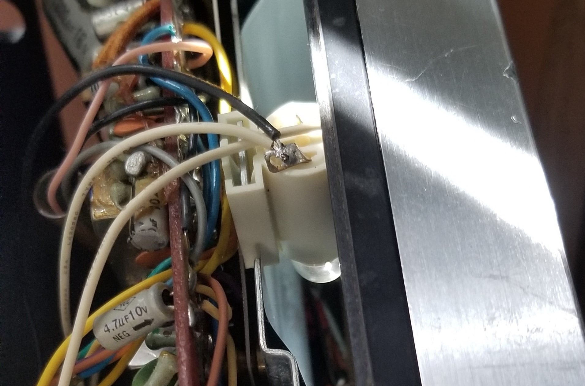

    Hello everyone. I have a Lloyd's JJ-6822 flip clock. Yesterday I was able to repair the gunked up motor thanks to the helpful videos. Now I want to tackle the light bulbs. There are two light below the tiles (low light but working) and a bulb that lights up the radio station spectrum (isn't currently working). I've researched it and I'm unable to find the power rating for these bulbs or where to purchase them.
    Hi there....I assume you are in the US. The two lamps are neon. High voltage type so you would need the NE-2H (C2A) type or NE-2U (A3C) and a 30K or 33K 1/2 watt resistor for each lamp. If you wanted a lamp with a little lower brightness then use the NE-2E (A9A) with a 100K resistor. Do not use the old resistors as they are specified for the factory lamps which were custom made for the manufacturer.
    The lamp for the radio tuner could be anything from 6.3 to 12 volts. You'll need a digital multi-meter to check.
    bulbtown.com is a good resource for lamps.
