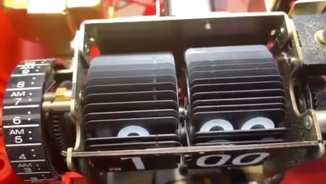

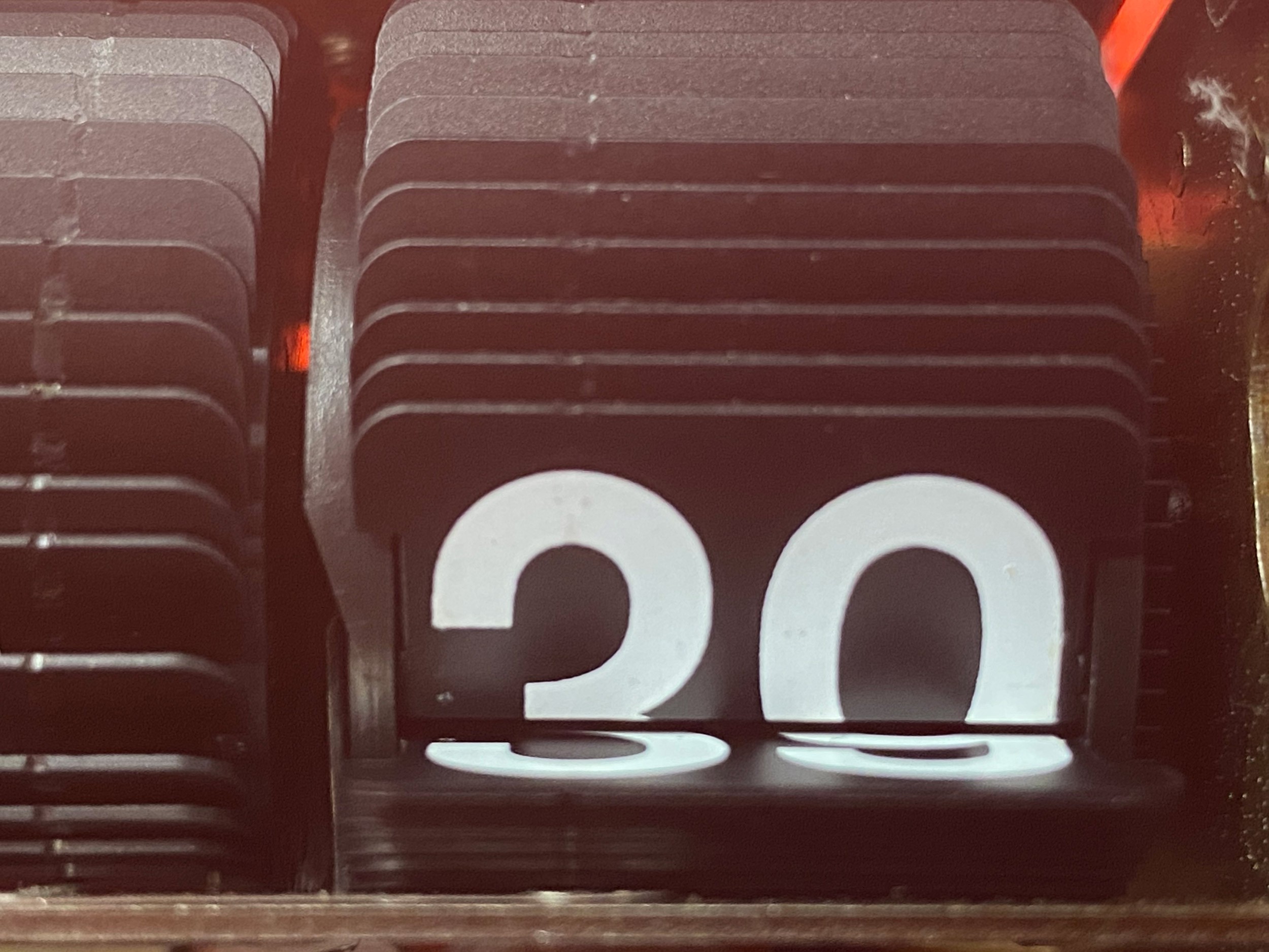

    I purchased a Grundig HR-50 on sight and without hesitation a few months back. I know nothing about it other than it was the coolest flip clock I had seen yet. I finally had a moment to take a closer look at it recently.
    I figured it would come with issues. Other than the dull bulb, there is only one problem. The radio and speaker are perfect in sound and tune. The motor is up and going after some delicate oiling, but the the pieces that control when the hour flips at the 59 minute mark are mangled to a terrible degree. The hour and minute are on the same rotation, so every minute is also 1 hour.
    I can not tell how they were originally at this point. I’m attaching pictures as they will explain it better than my words. I’m happy to take more or answer any questions to help better find a solution.

    I've not worked on a Grundig myself, but looking at the part it seems like there would be some means to replicate it's function- either by 3D printing something, building something from scrap materials, or potentially by cannibalizing the part off of a dead clock with the same mechanism.
    I certainly hope you don't have to remove the tiles to gain access to that piece, but that may be the case as well.

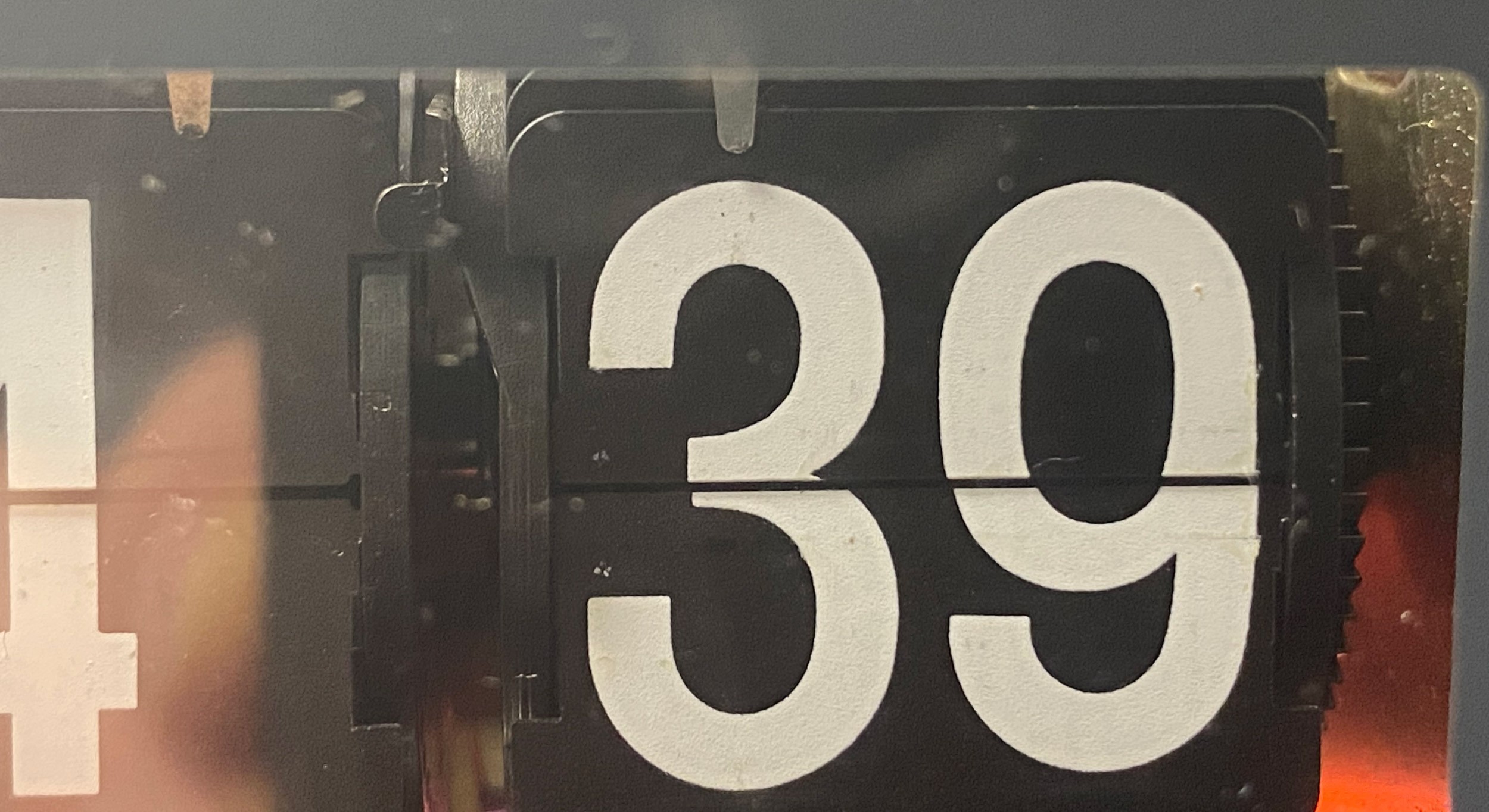

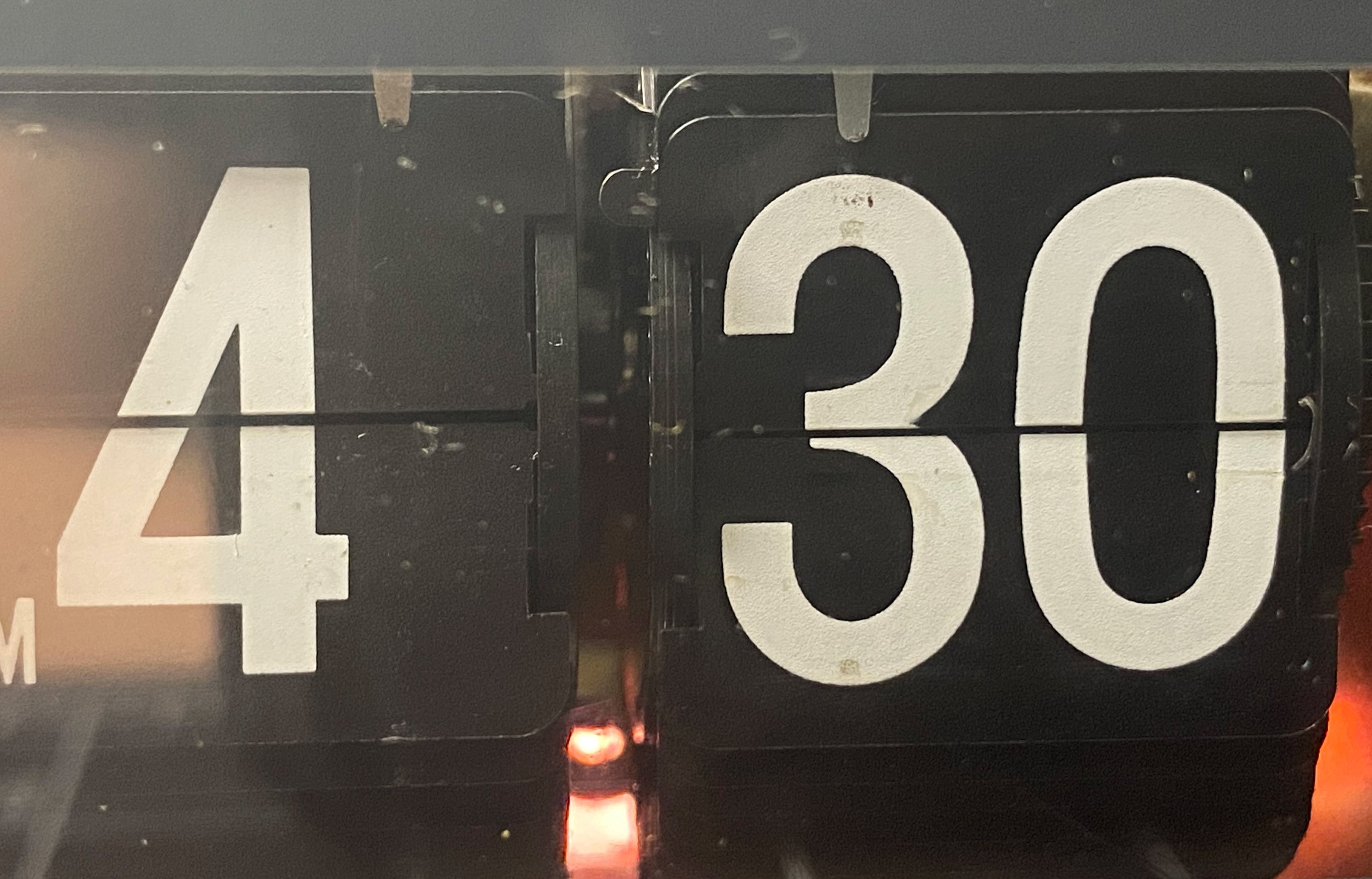

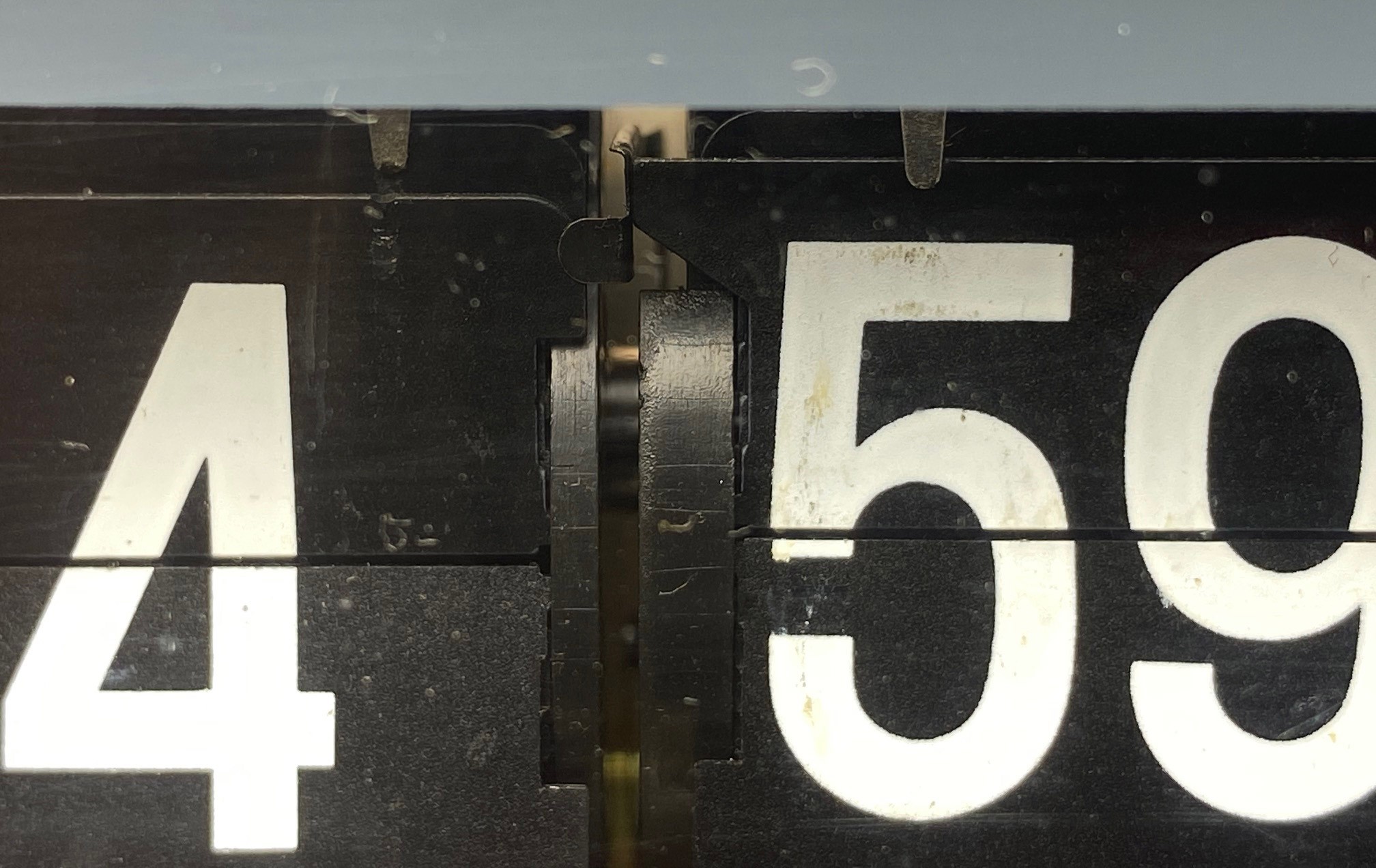

      Here's a video and a few images of what a non mangled HR-50 looks like. Hopefully helps some.

        Those pictures are very helpful! I’m pretty sure I can it back to working using those for reference. Will likely need to take the numbers out to do it well enough it will last.
        That’ll be fun.
        Thanks!
