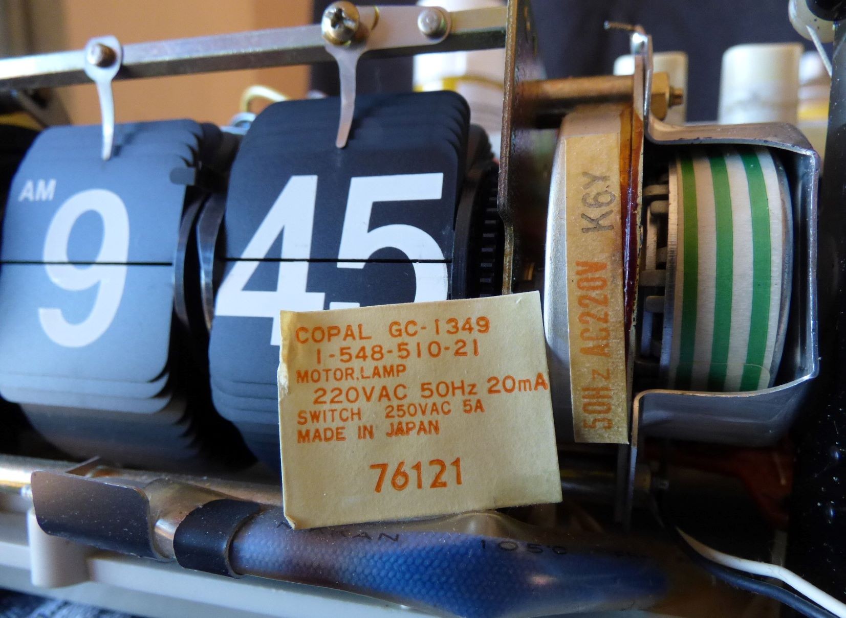

              These are the labels in my new Sony Ghostbuster, the main label had fallen off but was inside the clock, and on the long strip label there is 50Hz 220v and another code K6Y
              Do you want that 3 letter/number code if it's there?
              So Motor GC-1349 1-548-510-21 Sony Model TFM-C480E

                It looks like I've wrongly given you numbers off the larger square label on the back of the motor's rotor cover when you want the 3 letter/number code off the long thin label on the 'gearbox'.
                My apologies, you must have been slapping your forehead!

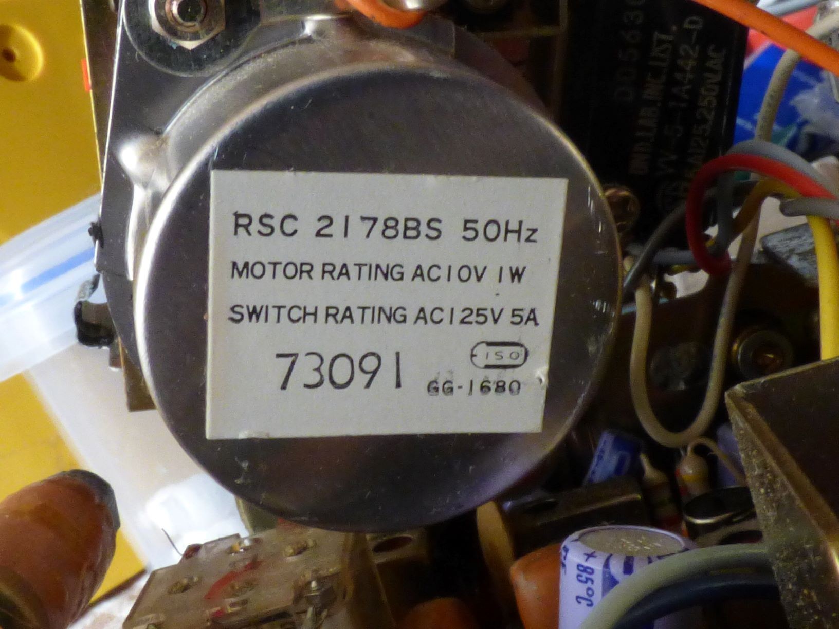

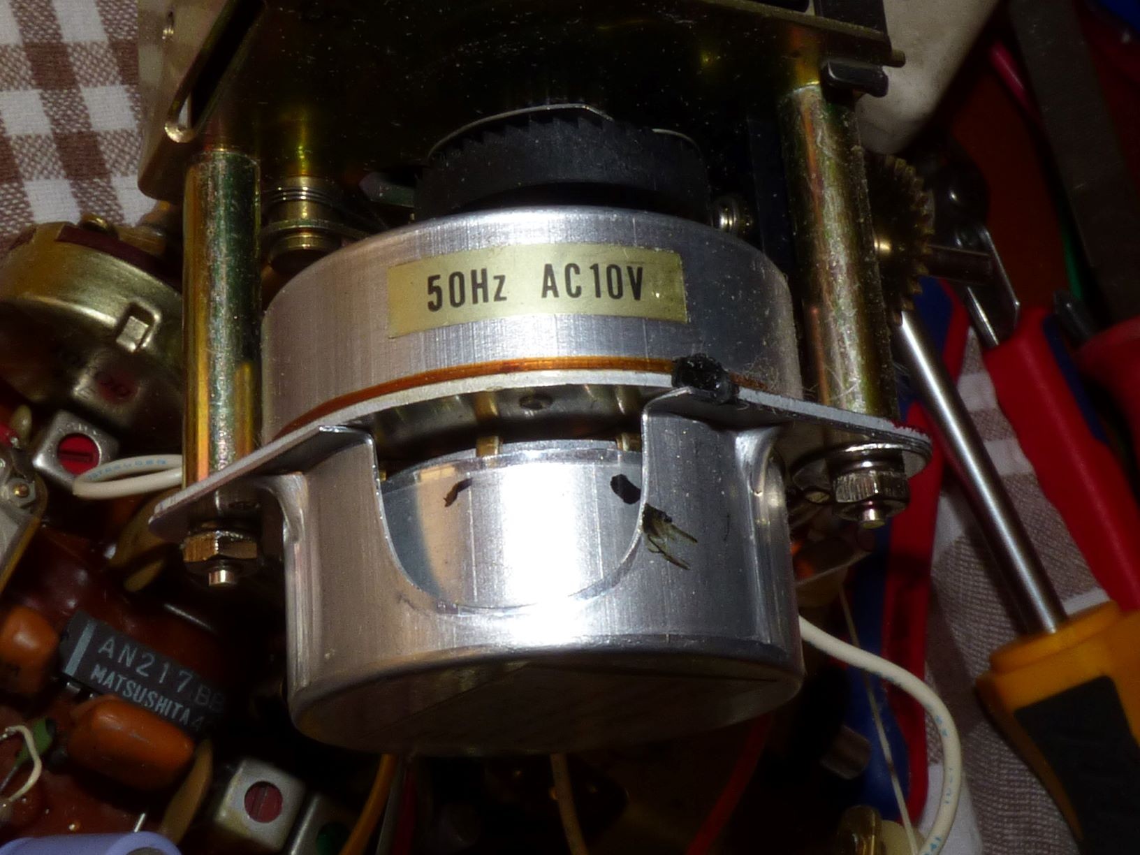

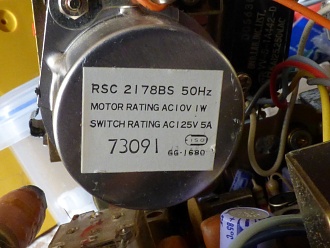

                          National Panasonic RC-6003B
                          Mains power is 240v 50 Hz
                          Clock Motor runs on 10 volts AC @ 50Hz
ID:	12052 Click image for larger version
