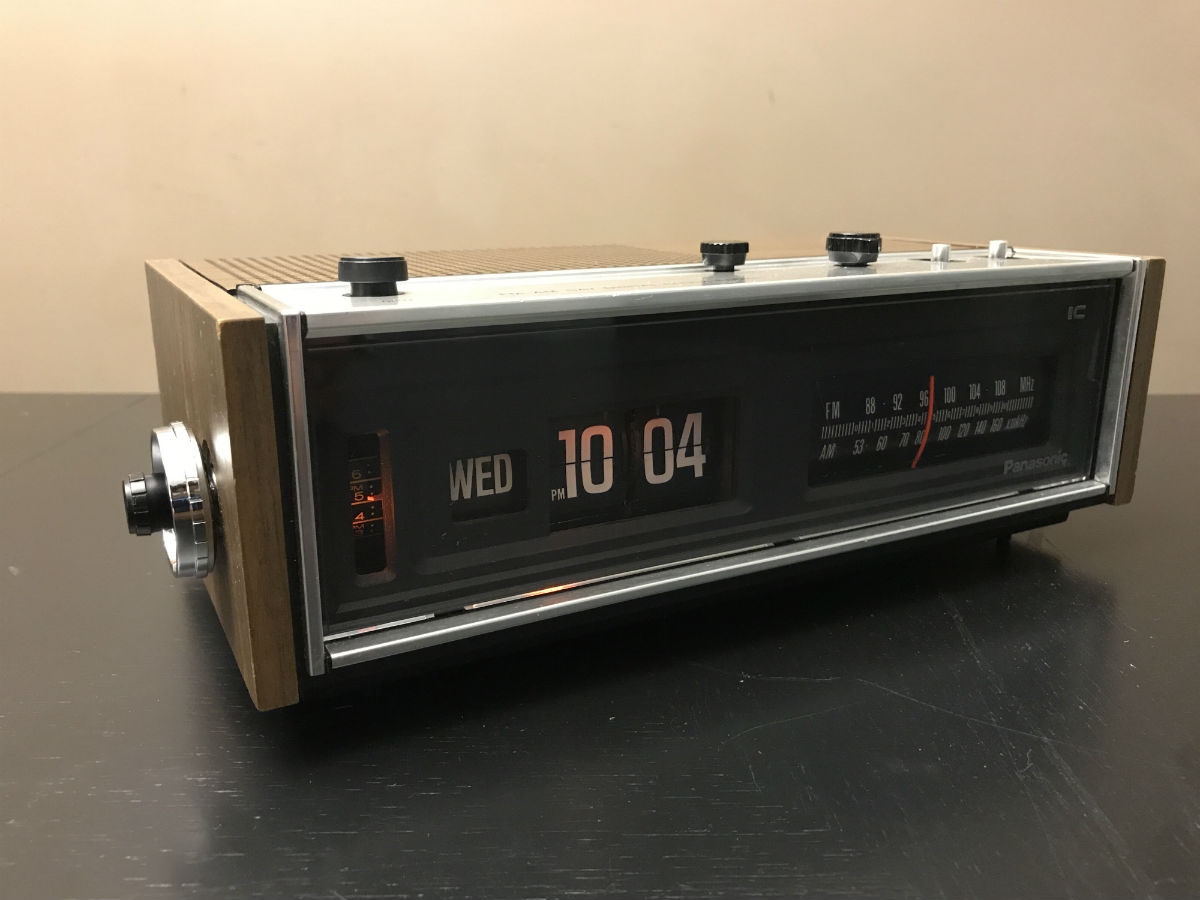

Power Source: AC 120V 60Hz 10W Measures: - enter here - Lighting: 120V neon glow bulbs (2) Colors: plastic wood grain top, wood laminate sides, brushed aluminum accents Features: Day of week, earphone, optional pillow speaker, external FM antenna attachments Qualities: sturdy construction, real wood sides, real metal accents, durable, long lasting internal components. Problems: wood laminate can chip, clock motor prone to seizing after prolonged storage (easily fixed), neon bulbs will need replacing. Restoration Tips: many screws screw into plastic - do not torque down too hard, disassembly easy, to remove clock mechanism you will have to remove smaller pcb from base and remove wires to light bulbs. Forum Entries/Other Onsite Info: photo gallery - Panasonic RC-7053 Advertisements:
