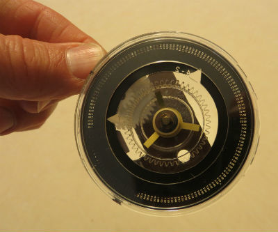

Take down was fairly simple with the removal of 4 cabinet screws and two screws holding the clock mechanism in place. Immediately obvious was the projection light and the wheel containing the time that would be projected on the ceiling. The wheel is turned directly by the clock mechanism via a gear on the side opposite of the clock motor.
How it works: The light from the 7 watt bulb passed through a small window in a metal wall between the light compartment and the clock internals. The light shines through the wheel, projecting the representation of the time onto a angled mirror. The reflection is passed up through a projection lens on the top of the cabinet towards the ceiling.

Repair/Adjustment: The wheel that holds the times for projection was removed and immediately the gear that connects the wheel to the clock dropped away.
Anyone attempting a take down of this clock should be alert for this so that this gear does not get lost. The clock was set to 8:00 pm and the wheel re positioned so that "8:00" was visible through the metal window.
