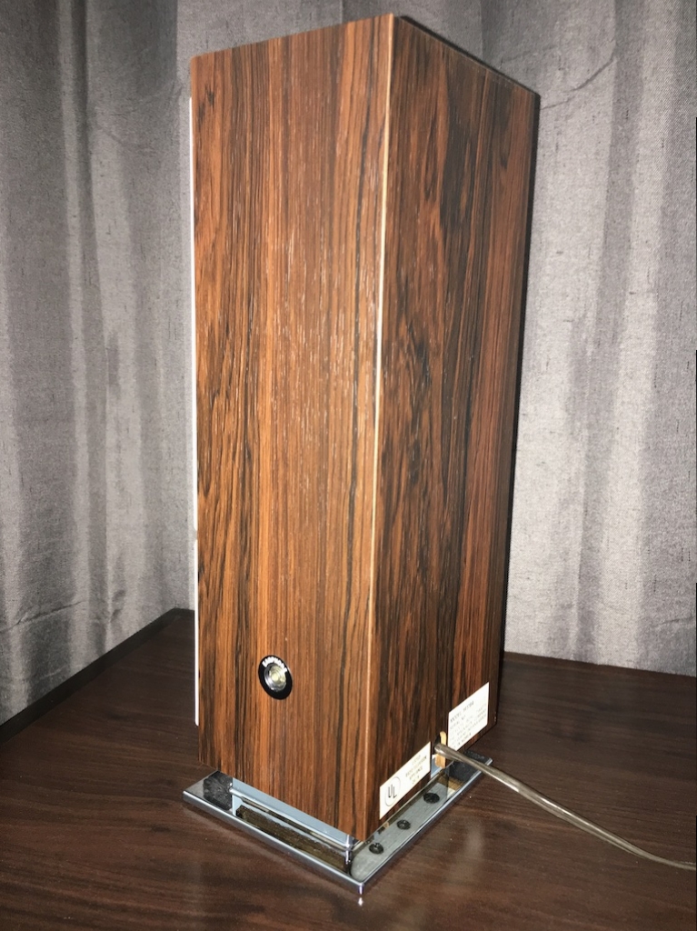

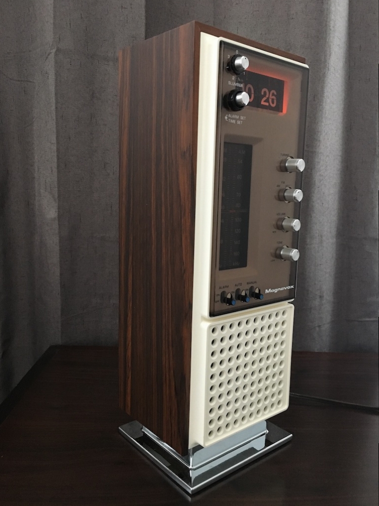

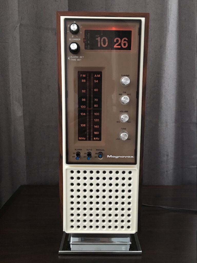

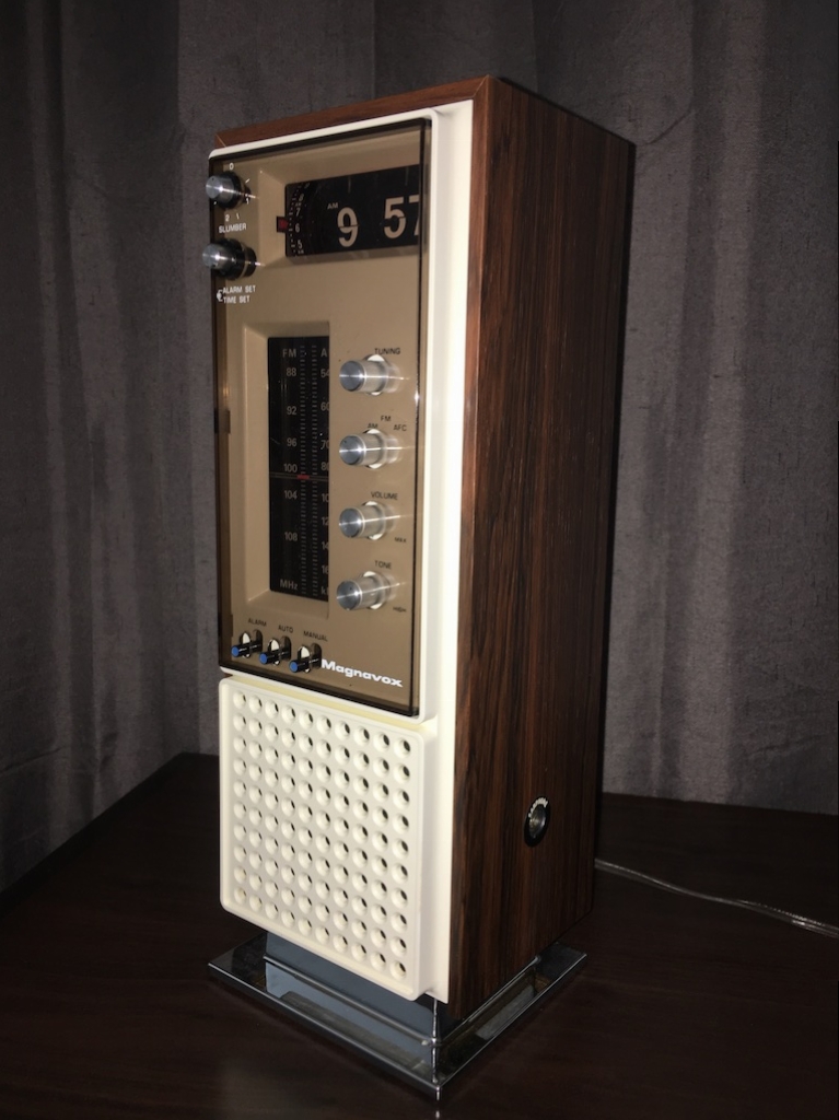

    Magnavox 1R1784

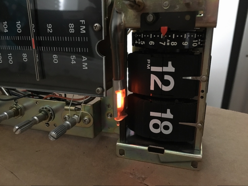

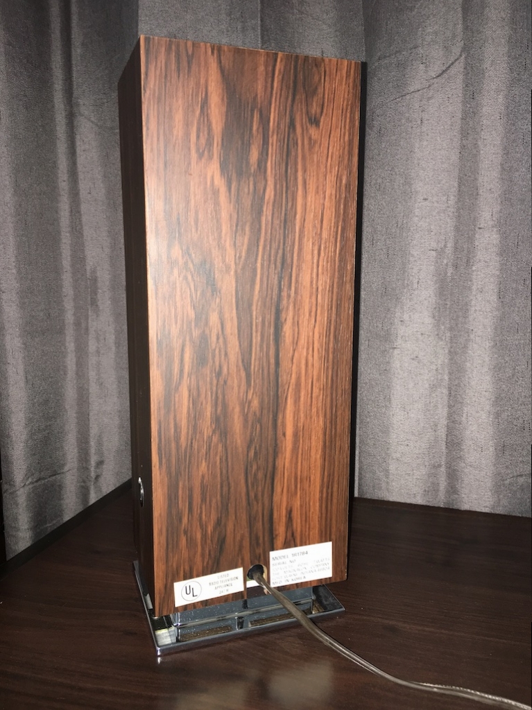

    This is a circa 1972 Magnavox flip clock radio. I have an amazing Magnavox Imperial stereo console and when I saw this cool flip clock I just had to add it to my collection.
    By the late 1960s Magnavox was making a lot of components overseas, and this flip clock radio is no exception. Manufactured in Korea with Japanese parts. The clock of course is a Copal. Copal GG-1670 to be exact.

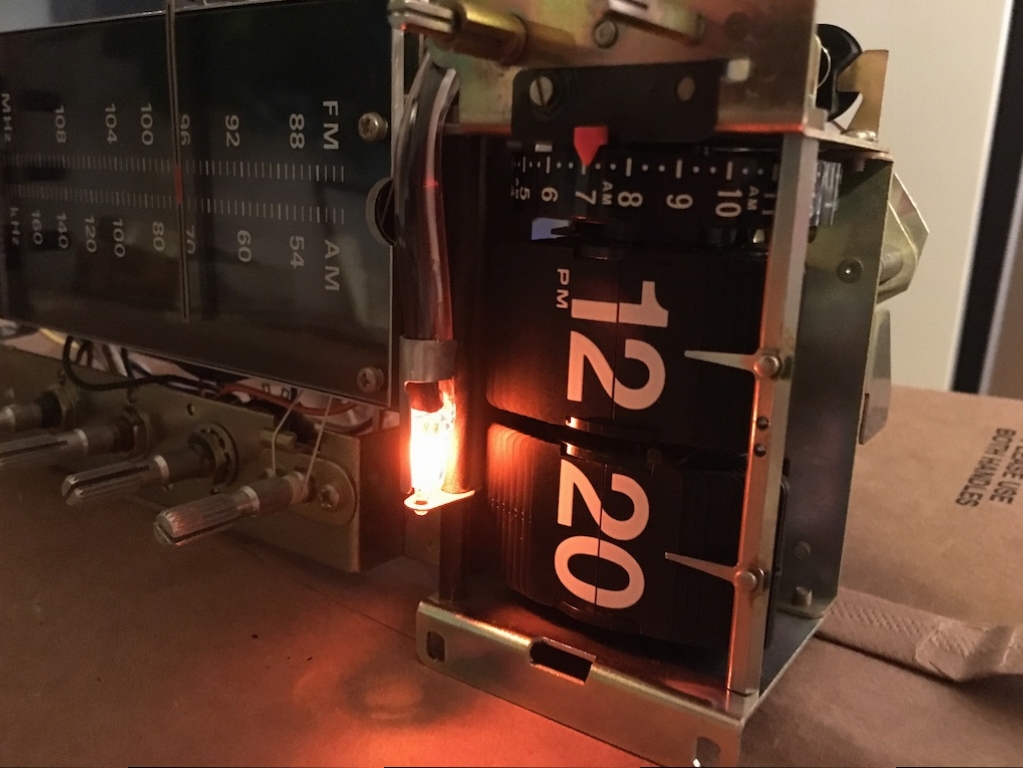

    Neat vertical design with a heavy chrome base and real wood cabinet. I got it in non-working condition. A nice alcohol bath got the clock back up and running. Deoxit in the volume potentiometer go the radio working. AM band tunes great, but there must be a bad cap in the FM circuit because it is really fouled up. The original clock lamp was pretty blacked out, replaced with Mackey's new assembly and now it is bright as new.

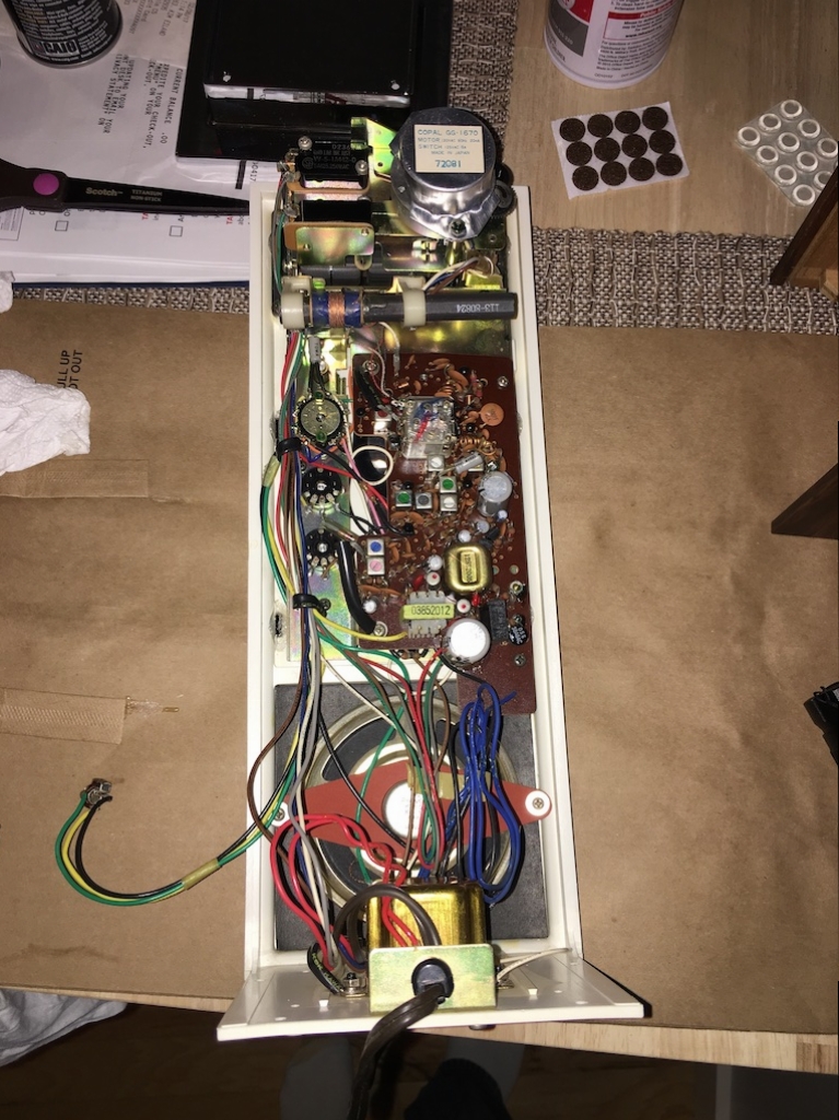

    The guts and the bulb replacement. Click image for larger version  Name:	1r1784G.jpg Views:	1 Size:	554.0 KB ID:	2689
    Click image for larger version  Name:	1r1784H.jpg Views:	2 Size:	385.5 KB ID:	2690
    Click image for larger version  Name:	1r1784I.jpg Views:	2 Size:	433.8 KB ID:	2691

          Jeremy did you try contact cleaner on the AM/FM selector switch?
          • Jeremy
            Site Contributor
            • 158
            I cleaned all of the switches to no avail. Very few stations will tune on FM and when they do they are way out of alignment.
            Jeremy
              • 3607
              Jeremy
              The pictures are great by the way.
              Anyway it all looks very good in there.
              Since AM and FM use the same tuner dial, that misalignment probably has to due with need for adjusting the IF and RF circuits . Sometimes people get inside the radio and start adjusting things, not knowing what they're doing. Or it's possible the settings got bumped around just with time/age. Unfortunately, to accurately fix this you need special equipment ( a signal generator and oscillator). I have only the most basic of understanding of this whole process. While it's possible that you just have a bad capacitor, those are often hard to chase down. Unfortunately, you might have to take it to an old school TV repair man to get something like this fixed.

                        I also have one of these Magnavox tower flip clocks, but mine says "Made In Japan." Magnavox, RCA, General Electric, Admiral and most other American brands switched production to Korea or Hong Kong to save money. But many times quality suffered. I also have a identical Magnavox tower clock that says "made in Korea." The soldering and internal assembly is a bit sloppy compared to the Japanese one.
                        • Jeremy
                          Site Contributor
                          • 158
                          The date code on the clock movement is first week of August 1972. I have a 1R1782 made in Japan with a movement date code of third week of November 1972. It would seem that whoever was contracted to make these clocks for Magnavox had plants running in both countries simultaneously.

                            Great restoration! I just bought the same clock on ebay---fixed the clock...but I need to replace the clock light--any suggestions there would be welcomed! Also--is there a separate light for the radio dial? Did you have to replace that, or was it already working?
                            Thanks!
